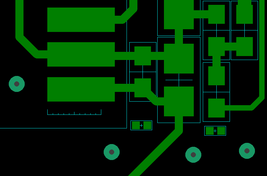

Now here is an example of what is coming in resistor size, 008004, currently some caps are available but I do know one resistor manufacturer is looking at resistors... they will be for specific applications such as digital termination next to the BGA balls and underneath the BGA device etc....
Obviously these wont be suitable for analogue, but will be perfect for digital termination, I should imagine power rating is going to be rather small, but as digital signal voltages keep decreasing so devices can swing from 0 to full voltage fast enough it wont be a problem.
Oh that's the 0.5/0.4mm and smaller pitch BGA's not the HUGE 1mm pitch devices...one our guys has drawn a short straw and has a board with 8,000 components and 19,000 connections!!!!!!!!
Oh the other devices are 0201's and 0402s'
