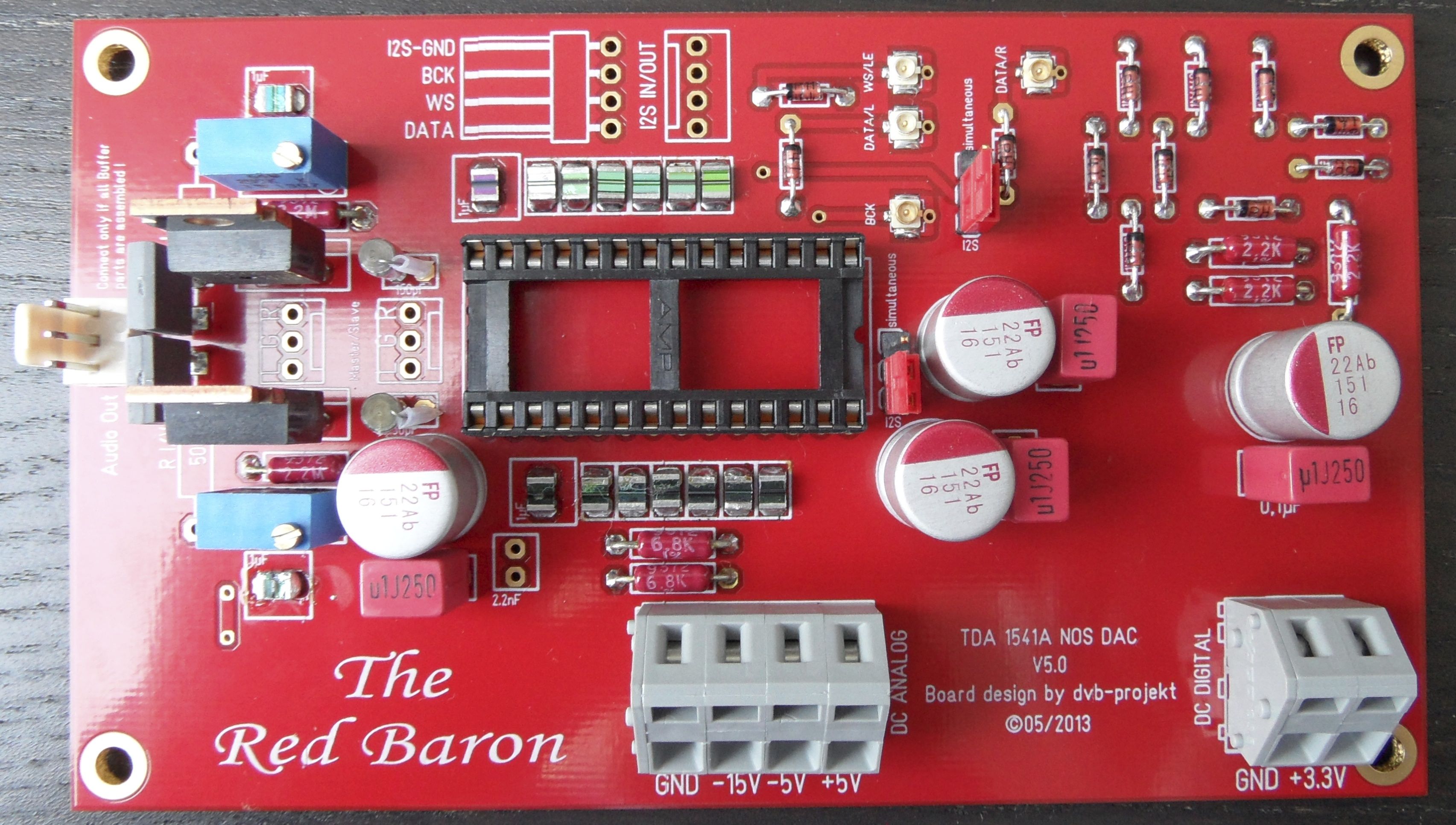

Which pins on the two jumpers needs to be connected and in what situation on the Red Baron V5 board? I see that one of the solder points on both of them are squared and the others are round. Can somebody please explain?
Regards, Vidar
Hi Vidar,
as you could see on the attached photo, this is the config for I2S input (middle/lower pin short).
For simultaneous mode, you must short the upper/middle pin.
Oliver

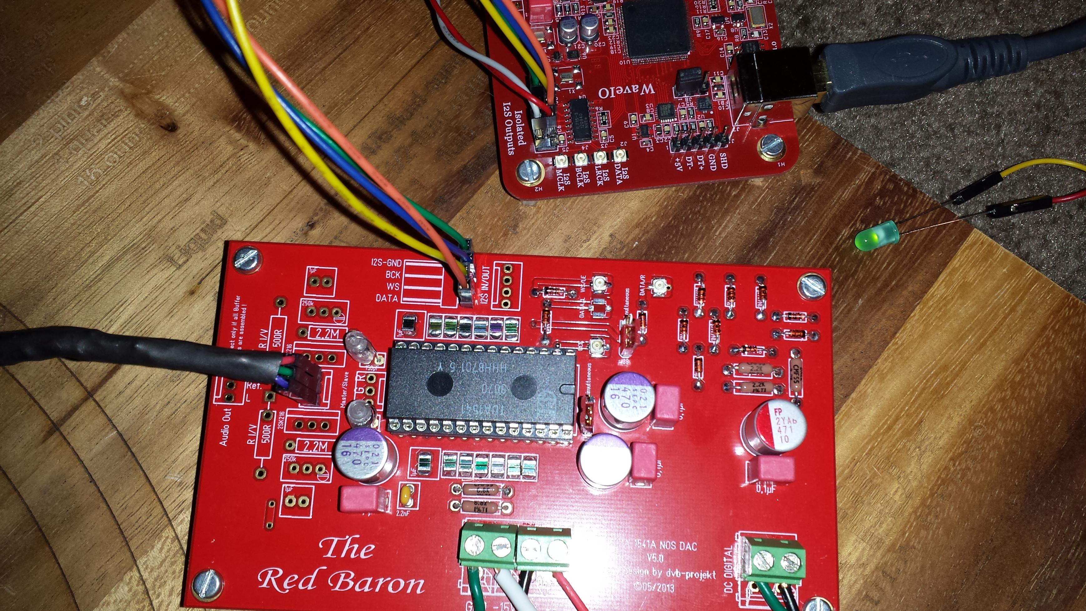

Hello Oliver,
I recently built red baron version 5 board using smd caps.Output stage is old version of tubizator with Texas instruments bulk foil resistors for iv and salas shunts for the power to the red baron board.
In the I2s mode with Bck connected to data r pin of tda 1541, I get excellent sound using twisted pear spdif board as well as ebay wolfson receiver board using CAL delta Cd transport.
I do not get any music using wave io usb board connected to windows computer using I2s output of the wave io board. However when I use spdif output out of wave io usb card into twisted pear audio spdif in, glorious music pours out.
I thought wave io i2s section was malfunctioning but when connected to a ebay tda1543 dac board wave io functions fine in i2s output mode.
Any particular setting I need to try to get wave io to work with red baron version 5 board in i2s mode? I feel I am losing some quality using spdif output of the wave io board.
BTW, I do not get any sound at all in i2s mode without connecting BCK to data R pin as shown in the schematic of the older versions of the board.
Any suggestions?
Suresh
Joined 2009
Hi Suresh,
in the I2S mode on the V5.0 you must connect BCK to BCK, not to Data/R.
The Data/R input is only for simultaneous mode!
The recommended connection from WaveIO is the isolated output J6! The correct connection is:
WaveIO isol. ---> Red Baron V5.0
DT ---> Data
LR ---> WS
BC ---> BCK
ISOL. GND ---> I2S-GND
Pay attention to the WaveIO Manual point 5.

Hello Oliver,
I connected two jumpers for i2s mode as suggested. See attached picture.
Wave Io to red baron as below
Data- to Data orange wire
LRclk to Ws ( yellow wire)
Bck to Bck (blue wire)
Ground to ground (Green wire)
No sound.
Out of curiosty I connected wave io in the same pattern to raindrop hui non os dac and music played through I2s connection.
Could this be due to dem circuit or i2s attenuation of red baron? If that's the case how come the tpa board plays without problem ?( only when Bclk and pin 4 are connected)
Any further suggestions?

Did you pay attention to the manual advice?
  • There will be NO signals at J5 pin-header connector (Isolated I2S Outputs) if there's no voltage applied on the V+ and Isolated-GND pins
What is your current source configuration
Yes Oliver. the red and grey connector carries 5v to the isolator, Wave io works fine through isolated i2s connector to another tda1541 dac board I have. So I have ruled out wave board as the problem.The other board has 680p cap for dem oscillator instead of 2.2nf cap with resistors which is what red baron has.
