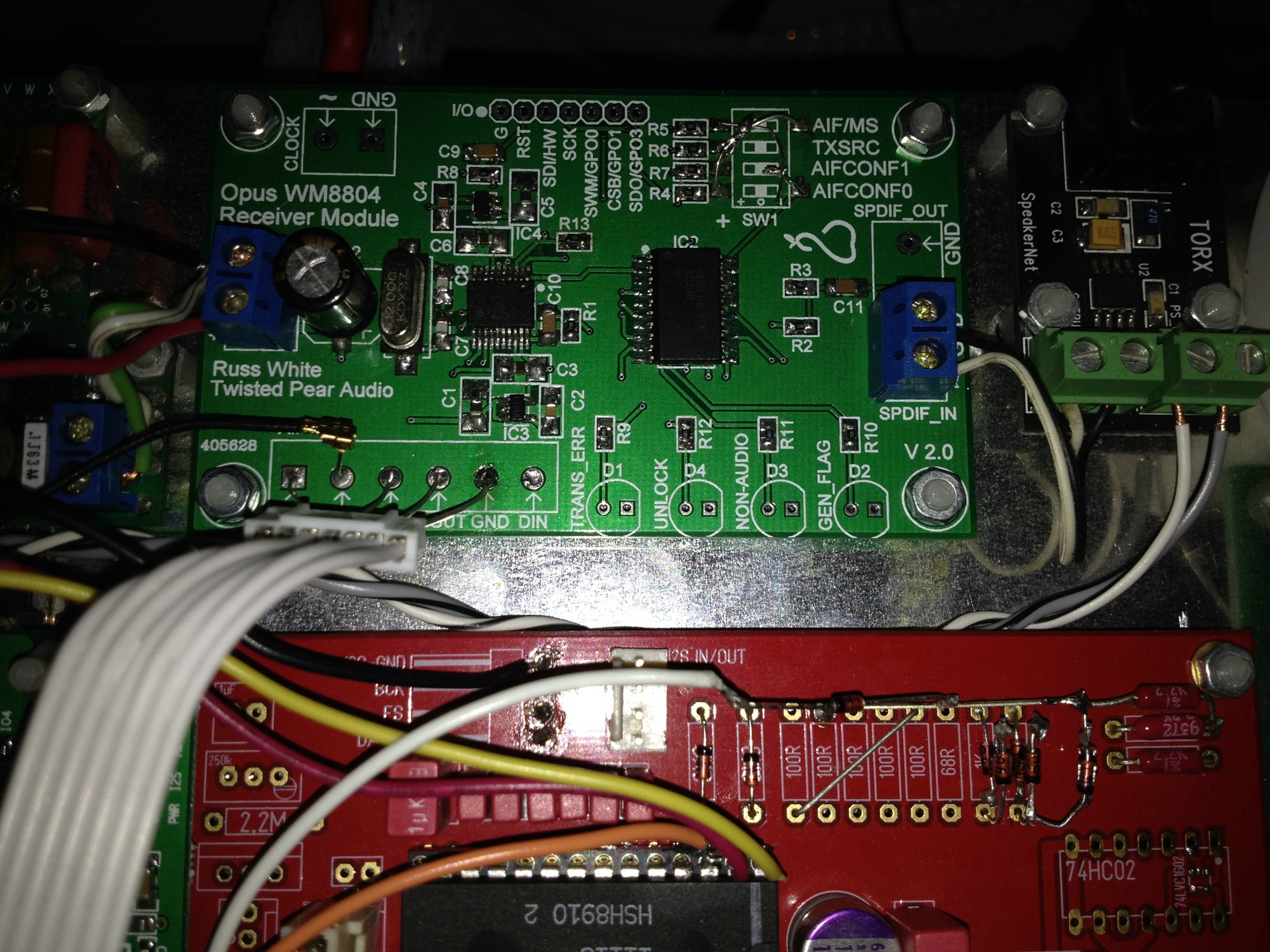

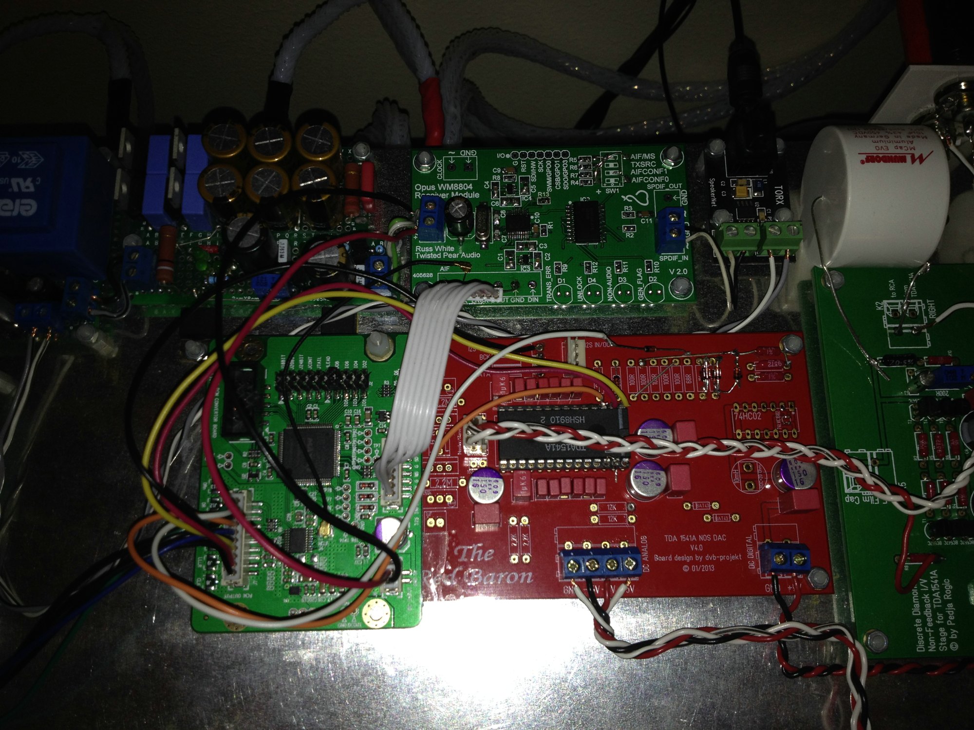

Small update. It took about a year :D but now it's f*&% working!!!
The hissing I got with PCM board has been removed! Ian was so kind that even sent 2nd board to check if the problem is there. Eventually it laid in 4 missing 1N4148 diodes that v5.0 has. However I still couldn't remove the hissing if TPAs board is connected directly.
Regarding the sound.
Frankly speaking I expected a bit more! So the main points are: trebles are slightly cut, soundstage is narrowed, lack of air. Good side: bass, details, punch, it's all there. I would rate it as a step over Subbu DAC, but it's all subjective and not actually comparable due to 5-6 time higher price of RB project, not including the case.
Perhaps it's my implementation: Torx converter -> TPA -> PCM -> RB 4.0 -> DDNF. Maybe due to the parts I used - no Mundorf Supreme caps or Vishay foil resistors or 50-100VA toroids.
But still - 5 Salas regs + 3 other shunts have been implemented. Three dedicated trafos (TDA chip, DDNF board, TPA+PCM+Torx). Huge amount of caps in PS. Mundorf Evo caps in the output section.
Will compare to Benchmark on the weekend, lets see the results. The initial testing with T+A player has failed.:violin:

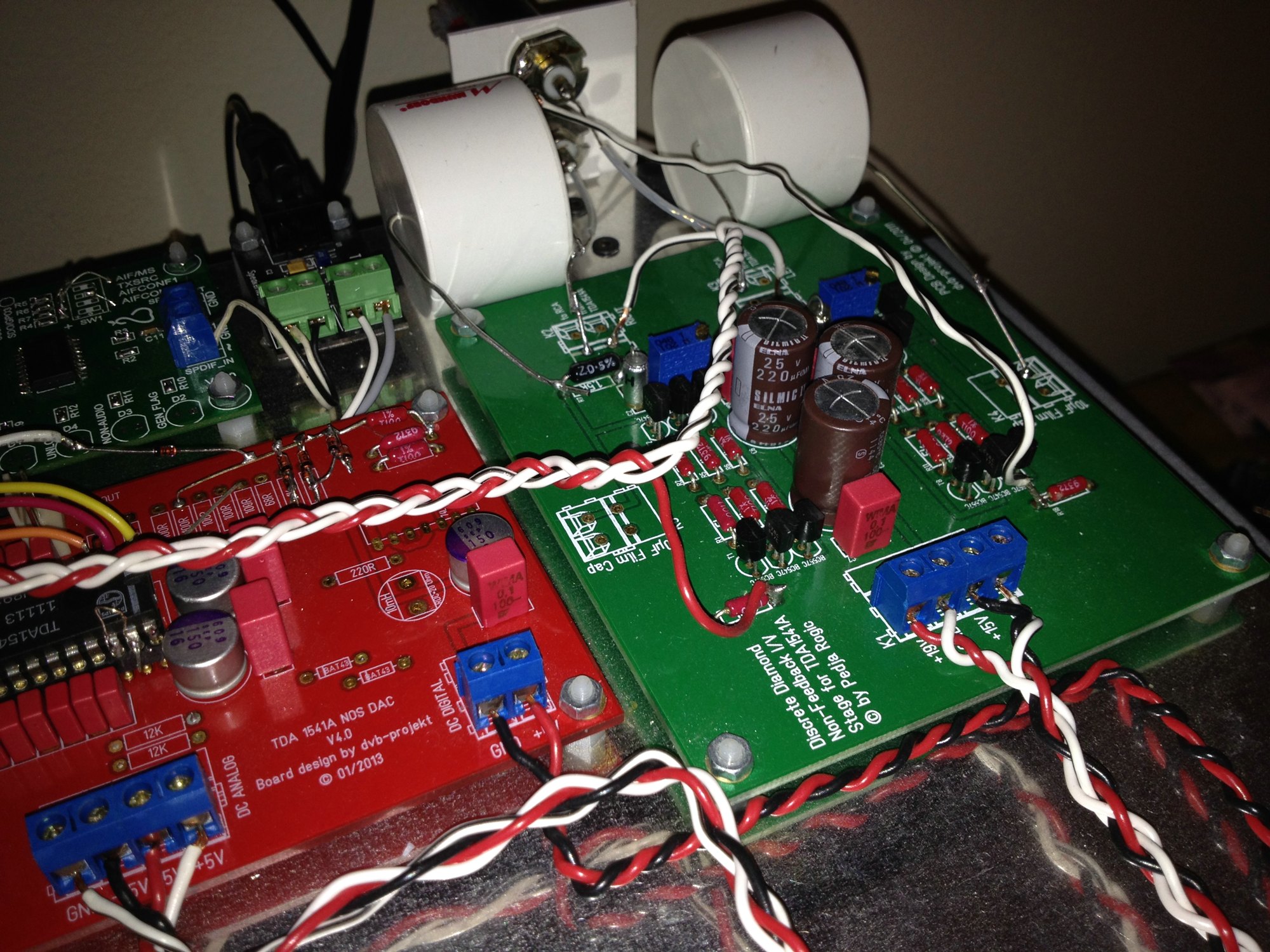

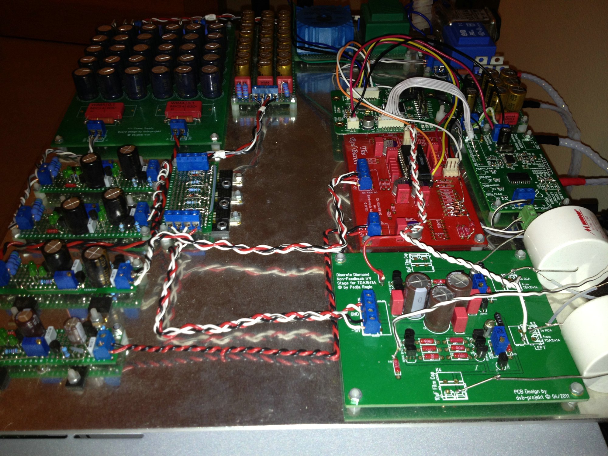

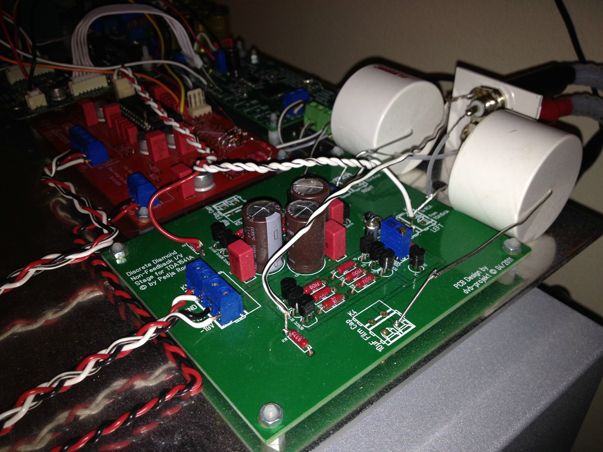

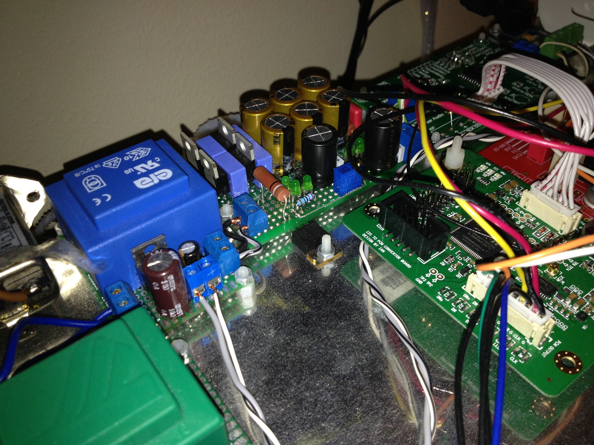

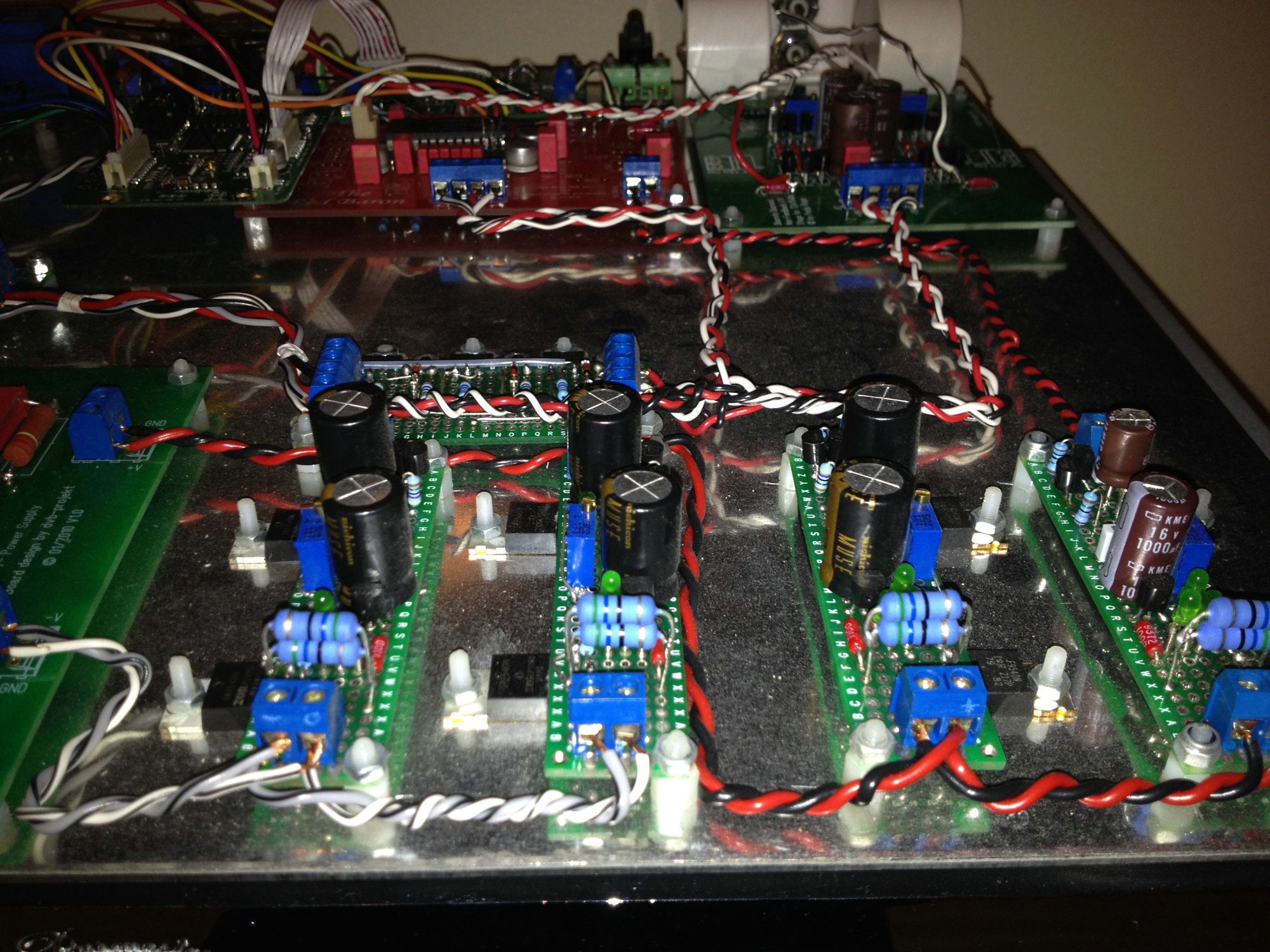

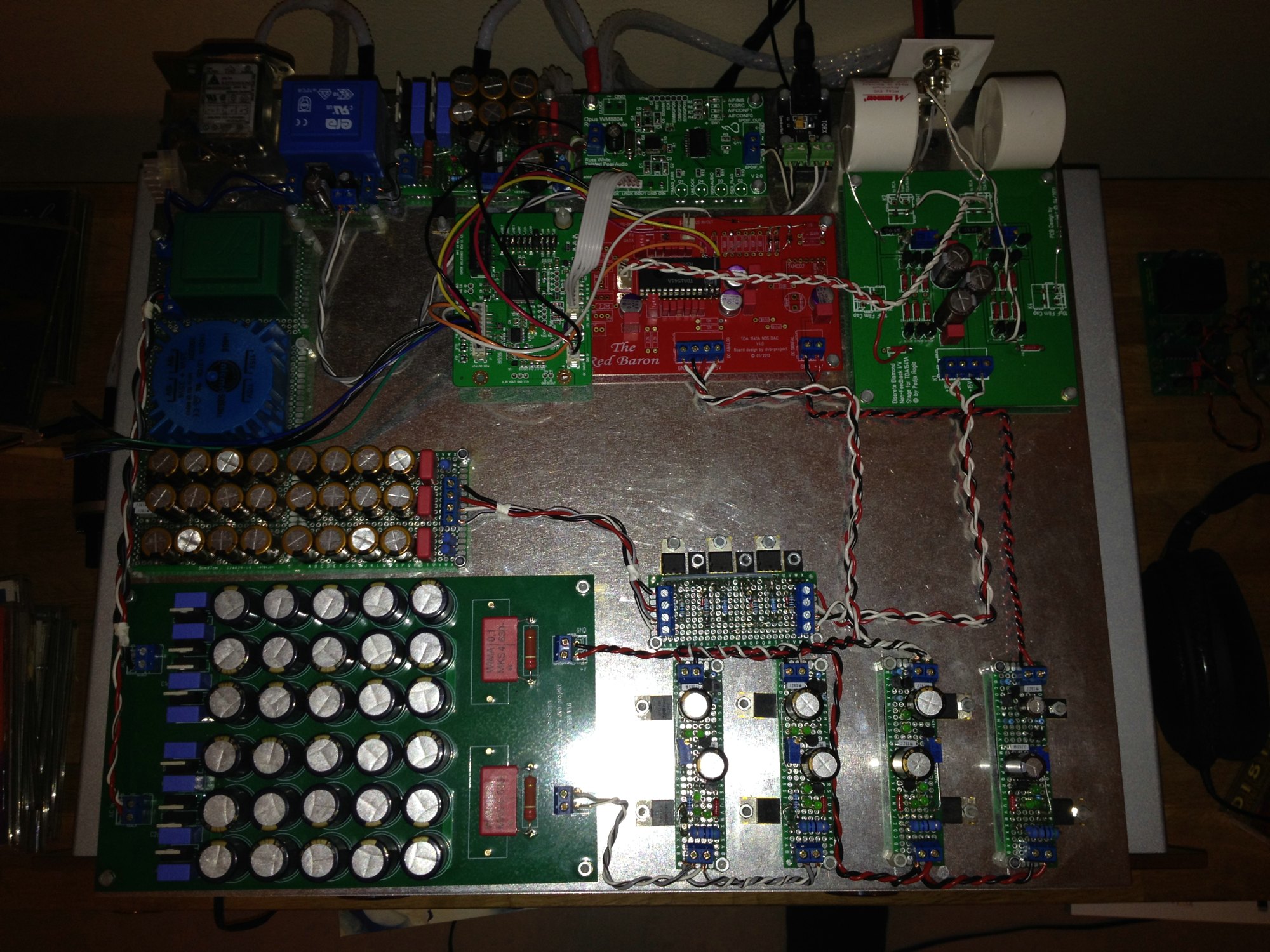

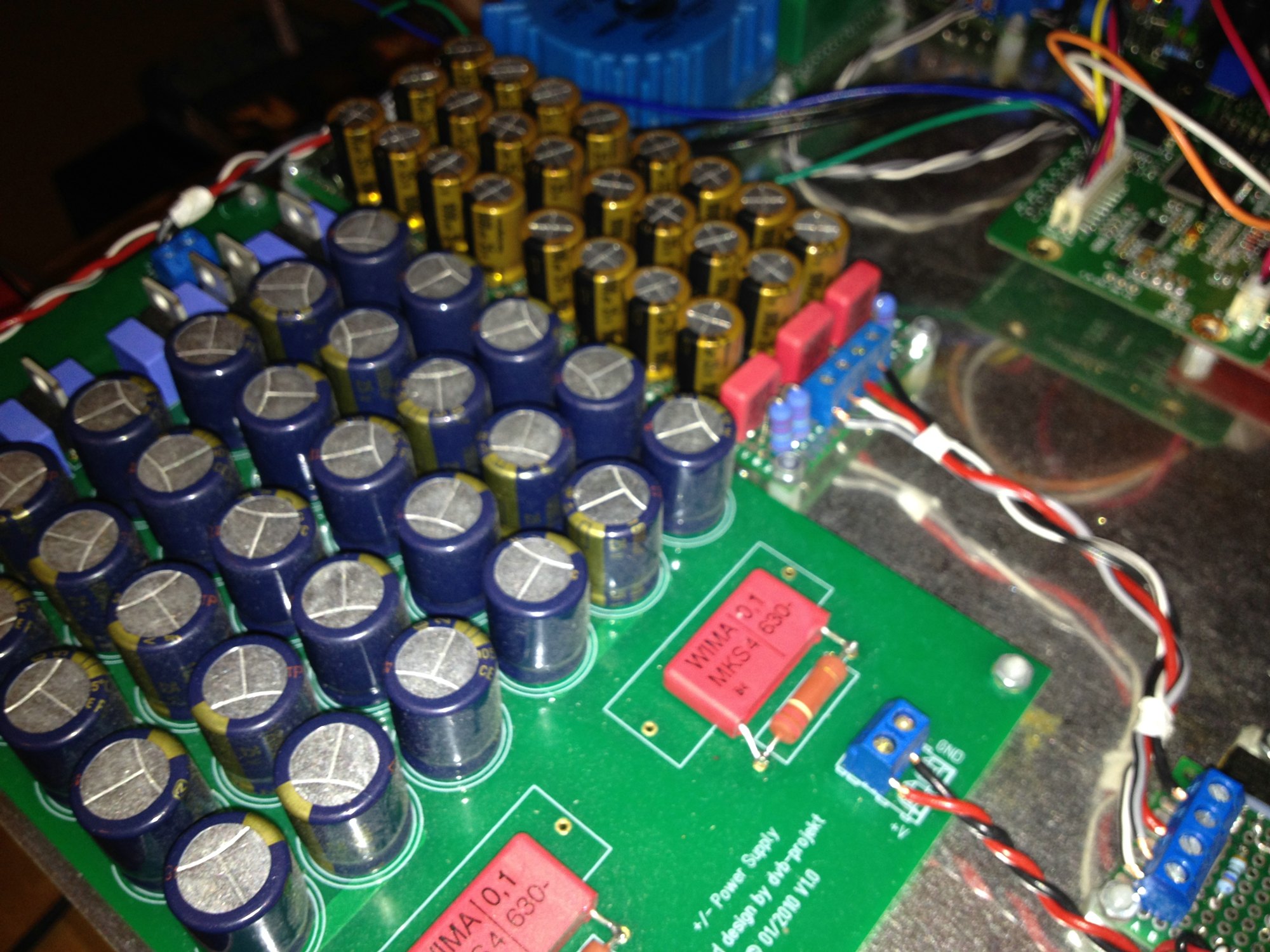

Can you post a picture of your implementation?
Sure, here are few pics.
