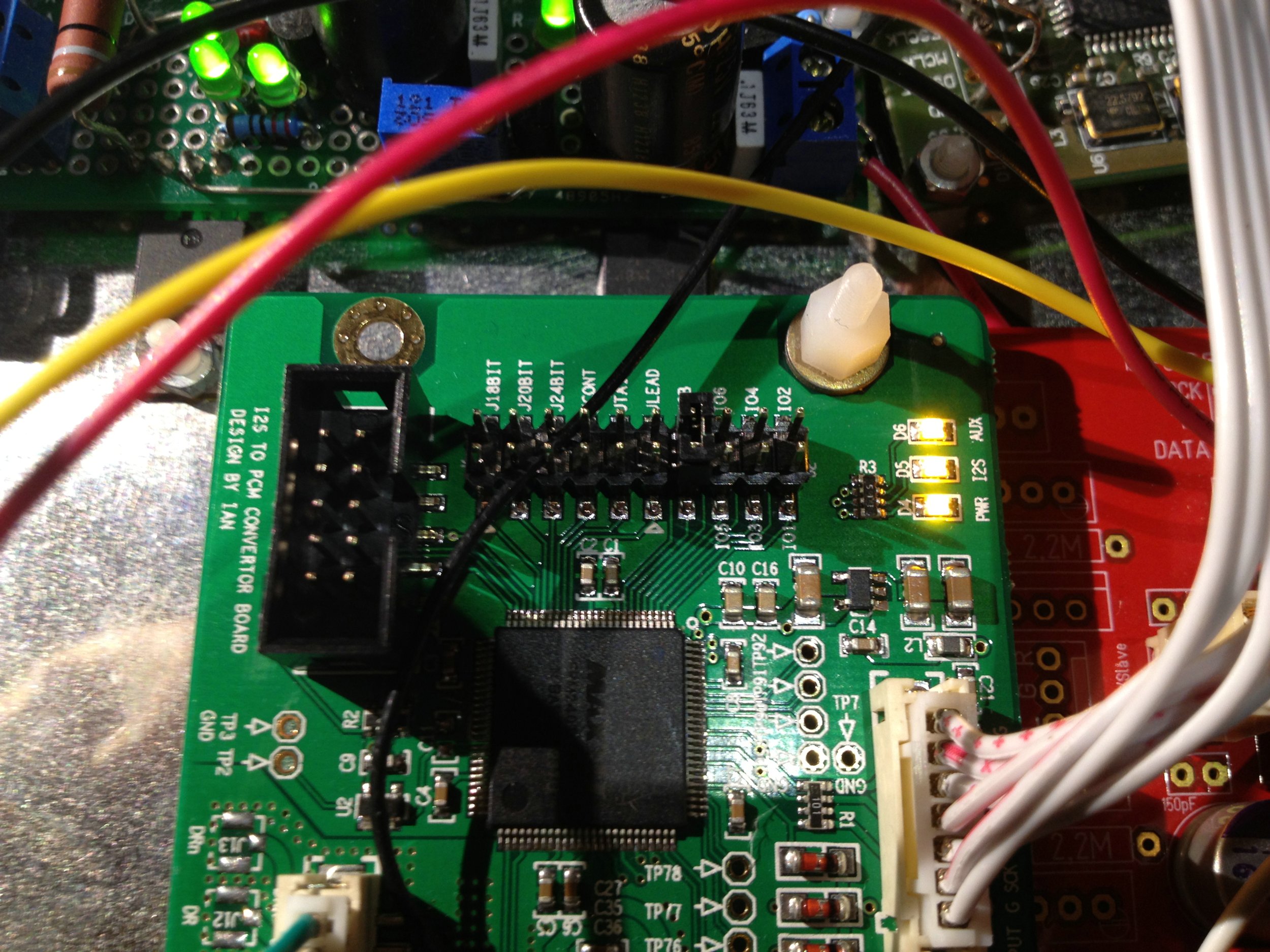

here is how the TPA and PCM boards are connected:
BCK -> SCK
SCK -> MLCK
LRCK -> WS
DOUT -> SD
GND -> GND (tried to disconnect, doesn't influence on anything)
pcm board and TDA are connected as in the Ian's manual here. DL and DR are soldered directly to TDA chip.
Tried to set the board at half speed, no difference in hissing and all three leds are on (at least that should be good).
Frankly speaking I'm not sure it's something related to Ian's board or connection, it looks more like another issue with TPAs spdif pcb.
I have found a similar issue in Subbu DAC thread where one member experienced similar noise. Turned out to be a dead 12mhz crystal. Does it worth replacing mine perhaps?

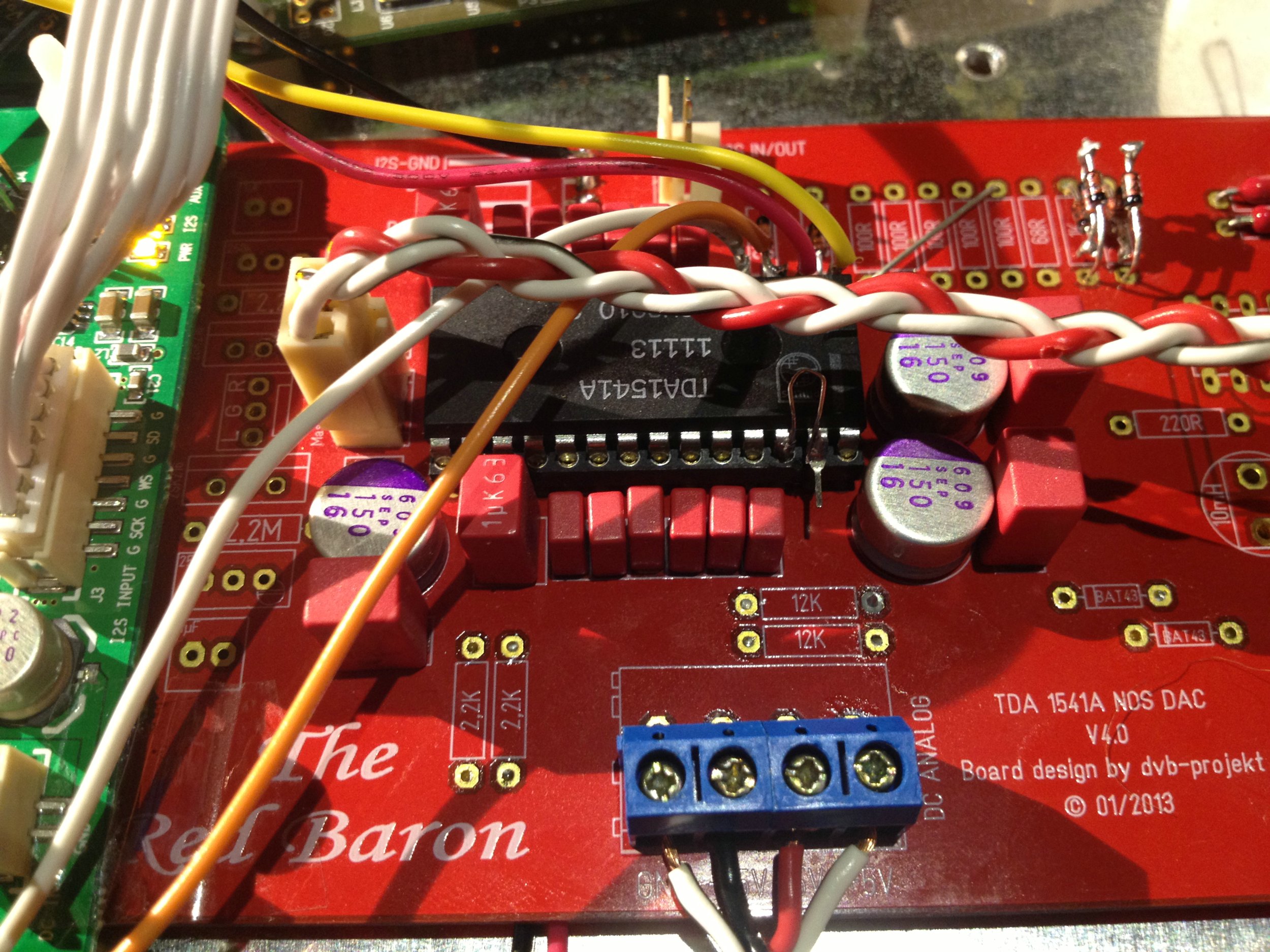

Could it be that the problem of distortions lays in missing DEM oscillator modification?
Pin 27 is attached to negative rail, DL & DR are connected directly to TDAs pins as Ian advised, but I get same distortions and similar hissing I had with TPAs module. :confused:
I would very appreciate any help as I've already run out of patience and ideas why the damn TDA works fine with Amanero, but fails with new PCM module...

It is hard to see on your photo, if the switch setting is correct.
Look to the photo of my TPA i had before:
Only the upper switch must be set to the left position. All others must be set to the right position.
If your setting is ok, i run out of ideas whats up with the TPA... :(

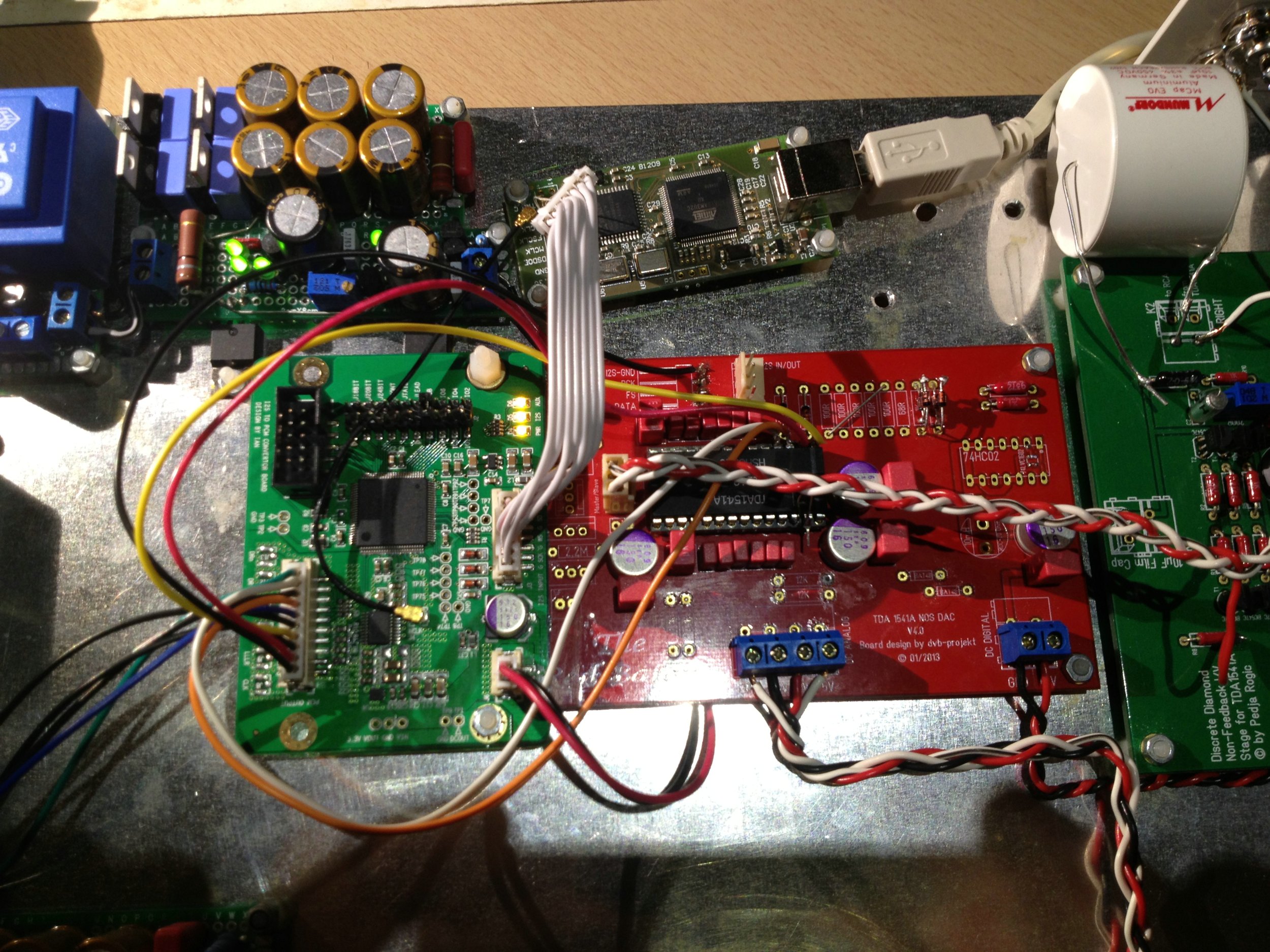

Hi Oliver!
I've already ordered another board for spdif input, so TPA will be left for another project. Funny thing is that I've tried to set the switch as on your pic, but was still unlucky.
Now I've been trying to connect PCM module with Amanero, which works fine with TDA alone. Everything is connected as I've mentioned in PCM thread here and here:
Pretty similar situation as with TPA module and I would even begin thinking that there is something with my TDA pcb, however how does the Amanero board work fine then?! :confused:

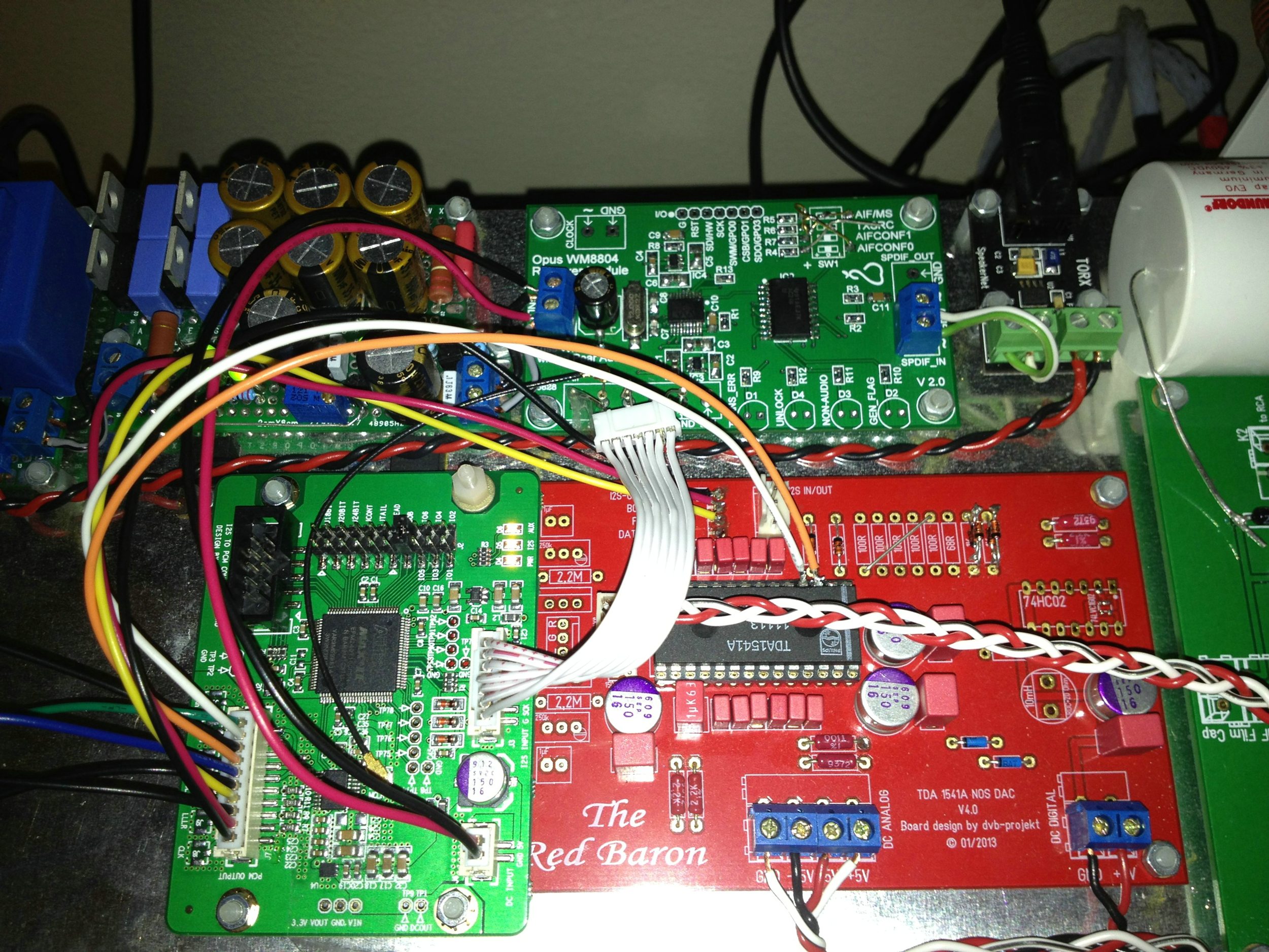

Twisted Pear Audio S/PDIF Tranceiver Module DIP settings
The correct settig without the DIP switch is:
- SW1 Upper connector left (R5) to lower connector right (+)
- all other SW1 connectors left (R6, R7, R8) to upper connector right (GND)
With this setting you´ll get 16bit I2S output (BCK, LRCK, DOUT, GND).
It is hard to see, if the wire is soldered correct...:eek:

it's getting hotter and more tricky!
DEM mode has been implemented (6k8 resistors and 2.2nf cap are below the board), same distortions to follow :confused:
Double check Red Baron board, all seem to be fine. Double checked connection, again everything looks to be fine.
Triple checked power supplies and voltages on TDA chip, looks fine.
I wonder if it's possible to connect PCM board at all:confused:
