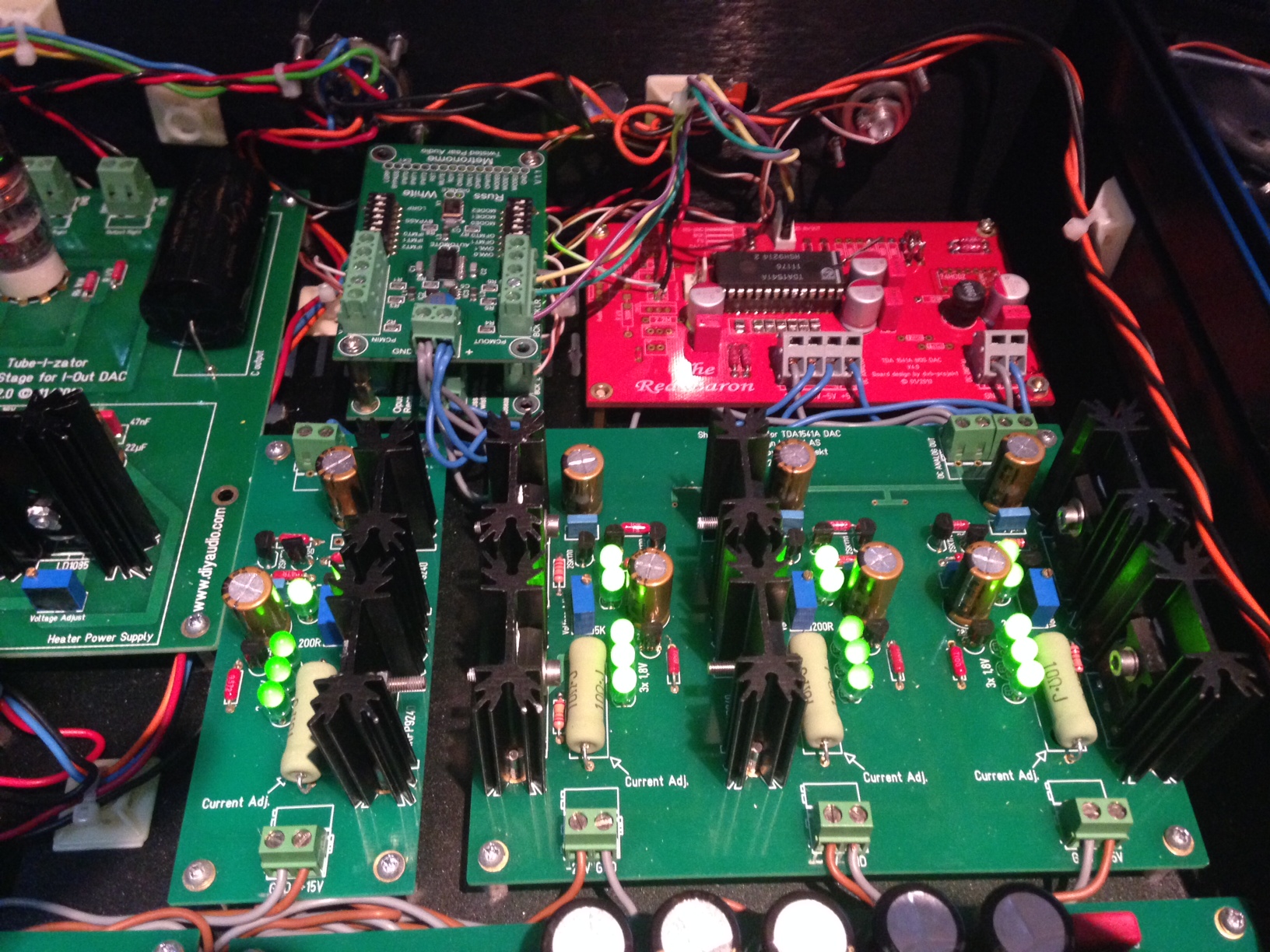

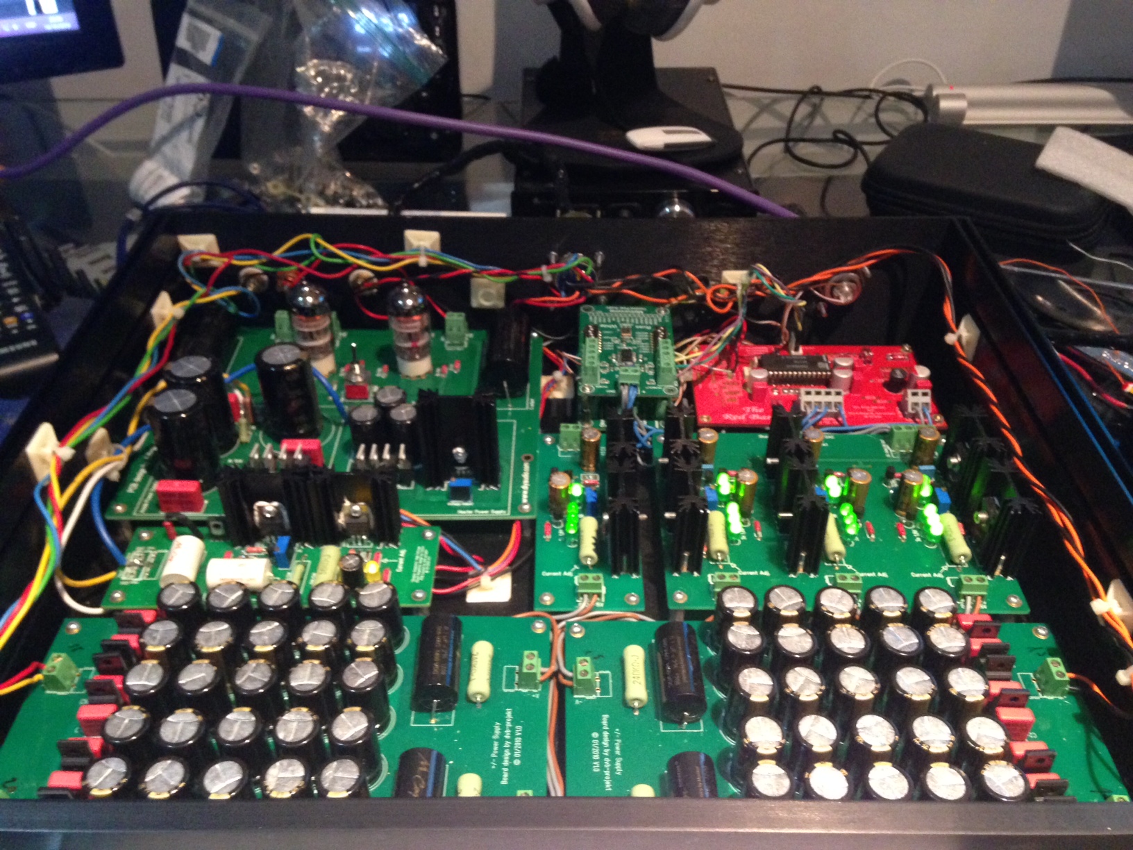

Hi Friends,
This board worked like a champion...
Search ebay for these exact words "WM884 S/PDIF TOSLINK to IIS Converter I2S Coded Project integration DIY"
But I had no way to fit it in the space left for the receiver because I always thought to use the TPA's board. I think that Ian's I2S to PCM will be the best option using the TPA's WM8804 board and no need to resample with the SRC4192 one. Ian's board can be used by itself and I am waiting for it to arrive and check if his board works and if it better soundwise than the SRC4192 already fitted.
I am still wondering how Oliver managed to make it work...:rolleyes:
Jorge
Not too much, but still...
hi Jorge,
I'm in GB too. Payment has been made so I hope to receive it soon.
Don't have any free place as well, however the one you've mentioned looks not that big, though I didn't find any dimensions in the listing. I wonder if there would be a noticeable difference with Ian's or TPA boards?!
Hi Dtses,
Is a little bigger in all dimensions, about 1cm more (near half an inch) and my real state in the really big Hifi2000 case was very short. So...I am going to try to stay with the WM8804 TPA's board and Ian's I2S to PCM above the former with standoffs.
Some pics....
Jorge

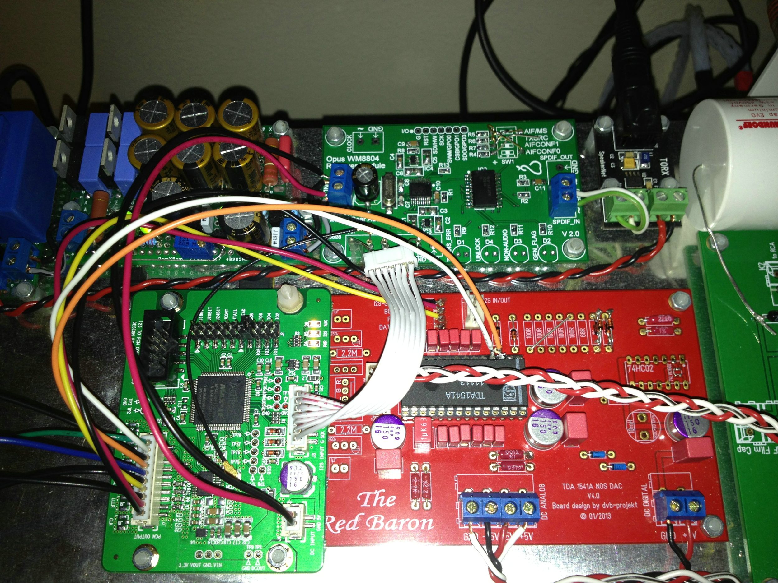

good news, I've got Ian's i2s to pcm board. Bad news, I still got the same hissing after connecting everything according to the manual. The jumper is set to "JOB". Any ideas except putting TPA's i2s converter board to the rubbish bin?!
  1. You might have a large earth loop: the TDA1541 board (older version I have) does not have a earth pad for the I2S, so the 'signal' is sort of is floating; the return must go via somewhere else (the generic earth). The result is unpredictable behavior of the rising edges (and maybe even resonances); this imho can theoretically be worse than jitter. If this is the case in your build, then this can lead to loss of detection. So 'scratch an earth pad' directly next to the connector as I did and connect the 'G' there.
  2. Also you might reduce the 'speed' to 88 kHz - in my current XMOS implementation I get only hiss or one channel only above 96 kHz :( ;
  3. in the channel that works the MSB seems to lack then too sometimes; it is not stable :eek:
So I2S is not as simple as I hoped.
Bernard himself has a very small and tight constellation looking at his pictures (stacking) while I - like most people - have it laid out on the bottom of a box.
Bernard, I hope I am not offending you :eek:
thanks for your help triode_al!
1. it's v4.0 with separate i2s grounding.
2. how to do that?
here is how the TPA and PCM boards are connected:
BCK -> SCK
SCK -> MLCK
LRCK -> WS
DOUT -> SD
GND -> GND (tried to disconnect, doesn't influence on anything)
pcm board and TDA are connected as in the Ian's manual here. DL and DR are soldered directly to TDA chip.
Tried to set the board at half speed, no difference in hissing and all three leds are on (at least that should be good).
Frankly speaking I'm not sure it's something related to Ian's board or connection, it looks more like another issue with TPAs spdif pcb.
I have found a similar issue in Subbu DAC thread where one member experienced similar noise. Turned out to be a dead 12mhz crystal. Does it worth replacing mine perhaps?
jcastellano,
have you already received the PCM board? I guess you are my last hope, if it won't work properly for you as well, then the only workaround would be to replace TPAs board I suppose.
Joined 2006
Hi dtses,
While I haven't got my dac operational just yet, I'm looking at your photo and noticed a couple things. The strings of diodes that replaced the 1K resistors look to be in parallel and the 3 in a string should be in series. You have the BAT43 parts in as well as the 12K resistors, both were recommended to be removed. Not sure about the last 2 being a problem but I would try fixing the diode strings.
