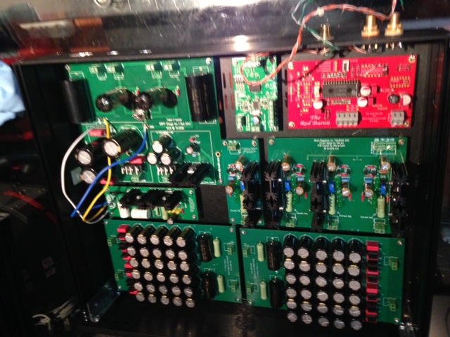

Hi friends,
I am in the finishing stages of my Red Baron plus Tube-I-Zator with all the Salas power supply regulators. For me is a big task due to the parts count. I thouhgt that I could fix everything in one big case but it was impossible. I have to install the power transformers (3 in total ) in another case and run cables from there.
I am going today to setup the wiring and in the next few days I will finish the transformers case. Also I have to find a suitable and reliable way to connect both without electrical risks and also it have to be detachable. I am confident that it will sound very good....
Here is a (bad) iPhone photo...sorry...
Jorge

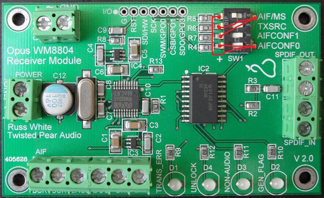

Yesterday I fired it up finally for the 1st time :)
Wow... I even got some music at the output :D
Bad point is that there is so much noise/ hiss/ digital distortion (?!) and it's very loud!
Checked all the power supply, the voltages are correct.
The settings on spdif transceiver are soldered as on the pics 2,3,4 (tried setting AIF/CONF0 to "-" but that didn't change anything, same noise).
I2S is connected in the following way:
BCK -> BCK
LRCK -> FS
DOUT -> Data
GND -> I2S GND
should be correct I suppose?!
Tried with a scope:
-square wave on spdif output of toslink converter
-BCK & LRCK showed square wave as well
-DOUT showed something weird (should it be square wave as well here?)
Would appreciate any advice!:)

I suppose that you have the 3.3v line conected where the old reclock circuit was, I mean, 3.3v to the digital DC input, ¿Is that right? Normally that noise issue is related to the BCK, make sure that the DAC chip receives it properly, and if that is the case check also FS, I do not mean the signal shape itself, I mean if the chip receives those signals properly, because it can happen that they are more attenuated than they should. If you feed digital DC input with 3.3v I think that you do not need that High Speed Buffer PCB, but I am not sure, better ask that to Oliver to be sure (If I am right and the board is not needed probably this is the source of your problem).
I see that you have implemented latest John suggested changes, you must use 1uF decoupling caps for the DEM system in order to work well (I tell you this because I think that you are using 1uF on the MSB and 220nF on the rest of the caps), otherwise you will have high levels of distortion, I do not think that is the source of your noise problem though, but 2.2nF free running oscillator cap must be used with 1uF decoupling caps.
Wargreymon
so it's 3.3v i2s attenuator mod as here. Everything is done as described by Oliver. The HSB in this case is not required.
... I mean if the chip receives those signals properly...
could you please elaborate a bit how to check that?
Need to mention that the DEM mod hasn't been done yet.

OK, as I have seen a image of the HSB on your previous post I thought that you had it installed, I now see that is just the image posted by Oliver some time ago.
By checking the signals on the chip I just mean that when you use the oscilloscope you put the probe directly on the pin/pins of the TDA1541A (In case you are not doing it like that of course), because the problem you describe can be a fault of the i2s attenuators, and if you check the signals directly on the PCB conectors where you connect the SPDIF module maybe you are seeing signals that are OK, but they get lost somewhere in the attenuators without reaching de TDA1541A, I happen to suffer the same problem yo have and it was mostly related with BCK not reaching the chip properly, I do not use TP SPDIF module though, I am using Teralink X2 until I decide on an asyncronus USB interface.
If you have not done the DEM clock mod then my previous post does not mean anything, I would recomend you using that last change though because at least in my case it made a tremendous difference in sound quality.
EDIT: Now that I see your latest images there are some diodes missing on the two diodes of the right (I am speaking about the i2s attenuators), you have a single diode installed in both positions where 3 diodes in series should be, unless there is something different when using TP SPDIF module... ¿You also have the 72HC02 installed? You must take it out.
:wave:
Thanks! Will chech the tda chip then.
There are 3 diodes in series as should be, the picture shows only the top view with two diodes, the rest four pcs are below. Are you sure about the 72HC02 chip, the pic on Oliver's blog doesn't specify any info to remove it?!
OK about the diodes, as I can not see the bottom part did not think that where installed there.
About the 74HC02 I do not have it installed and my DAC works :spin:. Taking into account that you have removed all the circuitry associated with the DEM reclock circuit, I do not think it makes much sense to have that chip installed with the rest of the circuit out.
Here you have the post of ECDesigns where it says that, I understand that "CMOS crap" is the 74HC02: http://www.diyaudio.com/forums/digital-line-level/79452-building-ultimate-nos-dac-using-tda1541a-477.html#post3411085
thanks, Wargreymon!
Will remove then today and check TDA chip as well.
