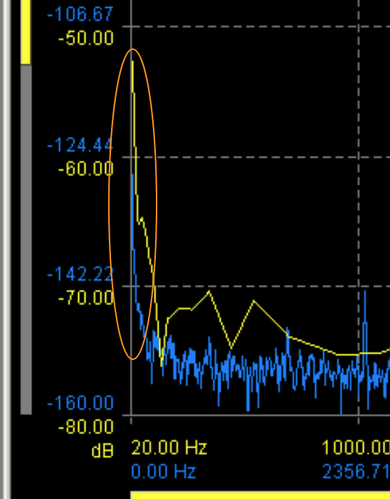

If anyone didn't see it yet https://www.superbestaudiofriends.org/index.php?threads/soekris-dac2541-technical-measurements.10561
Jitter suppression on the next-gen dac/amp (non-DAM) is really good. I do believe Soren knows what he's doing...
I guess that the jitter suppression is as good in the 1021. Same DPLL and short fifo. Just confirms that what we might hear as "coming thru" is not jitter but something else. Most probably the incoming clocks frequency variation (wander) and how that effects the behaviour of the DPLL... But jitter, it aint ;)
The measurements comments seem to miss the potential close in phase noise behaviour of the Si5xx? See picture. This is a result of the clock changing or/and the less stellar close in PN from the Si. But again - it aint coming from outside - the fifo kills all incoming jitter but passes wander. All "problems" are "domestic"... On the other hand - the title says "Jitter Suppression" - suppression being the interesting world indicating that this is not focusing on total jitter but rather what is suppressed from the outside - now the measurement cant sort out what comes from where so... intrinsic jitter is in the graph too. It is hard.
