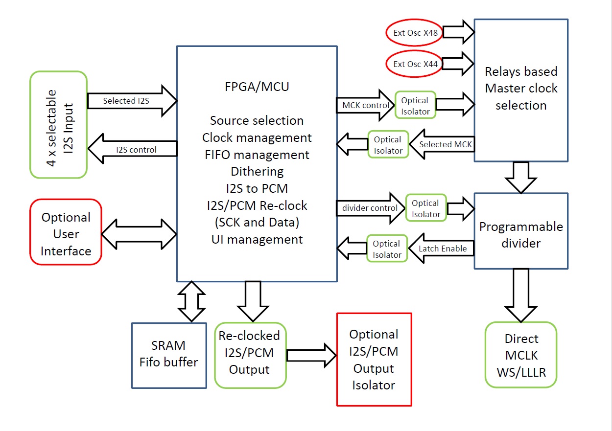

Curious andrea, given that you are very much into clocking and reclocking, why do you say there is little difference between reclocking before the FPGA (dam1021) and after the FPGA (dam1121)?
Because in my honest opinion the problem is not related to the reclocking.
There is no reclocking in our FIFO Lite, we have implemented a totally different approach.
In our FIFO the time domains before and after the FIFO are fully isolated, the LRCK does not come from the FPGA, it comes directly from the master clock that operates in a separate domain and the FIFO buffer is slaved to this clock.

That does sound good. I was under the assumption reclocking after the FPGA did the same thing. In my case:
RPi PLL rubbish -> galvanic I2S isolator -> dam1121 into FPGA
...FPGA does FIFO buffering...
...FPGA slaved to Si570 *after* the FPGA emitting clean source.
Part of the DIY fun is learning by reading so where am I going wrong here?

IMHO the FPGA does not provide a clean source and I have already said what I think about the Si570.
Our approach is a little different, please see the attached picture.
I thought it was clear, I wrote several times that I don't agree about the design choices of the DAM1021's front end.
IMHO there is a better way to feed the DAC so our upgrade follows our different approach (the FIFO Lite). ... snip...
So, we can look forward to a redesign of every DAC that you don't think is correctly designed - is that correct? Why just this one?
You say "... is a better way to feed the DAC.." But you are not feeding "the DAC" (Soekris DAC), you are feeding a ladder of resistors... the test will say noting about how a DAM DAC would sound with an other clock / DPLL - sorry, it doesn't work that way.
