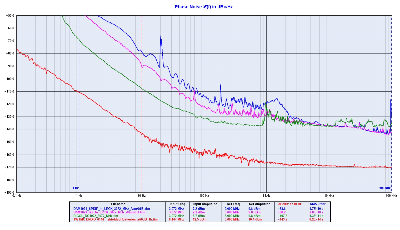

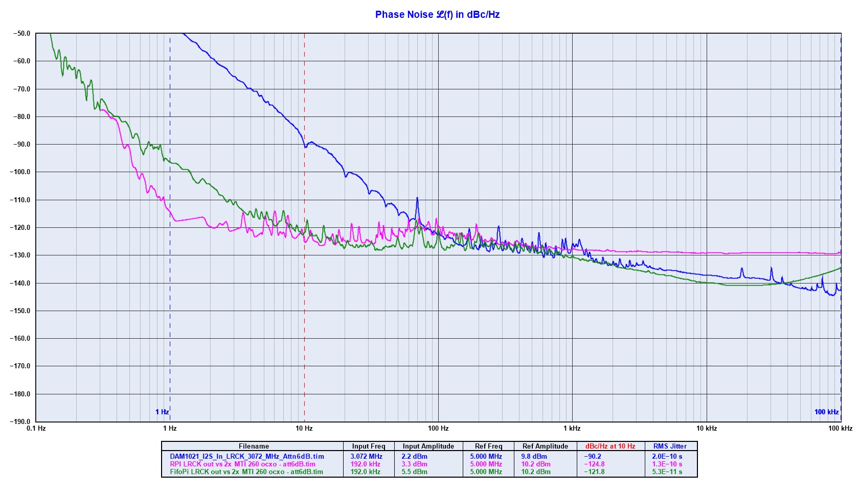

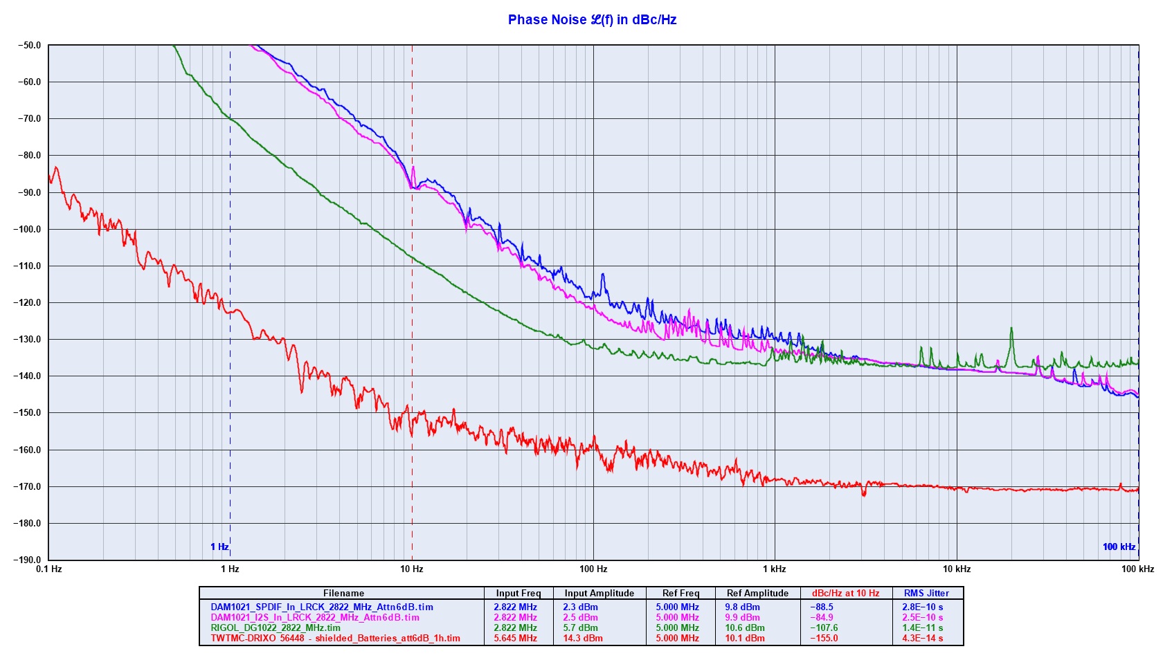

Phase noise measurement results
I attach the phase noise (and jitter) measurement plots of the DAM1021.
First plot is about the LRCK of the x44.1 kHz family:
- blue line, DAM1021 spdif source
- pink line, DAM1021 I2S source
- green line, Rigol DG1022 DDS signal generator
- red line, state of the art oscillator at double frequency
Second plot is about the LRCK of the x48 kHz family:
Third plot is a comparison about the LRCK of the x48 kHz family:
- blue line, DAM1021 I2S source
- pink line, RPI I2S output
- green line, Ian's FifoPi LRCK output with Crystek oscillator and RPI I2S source
The phase noise plots talk themselves, no needs of explanation.
Looking at the third plot I wonder where is the 74 dB jitter reduction.

I'm trying to grasp the third plot. It seems that:
1/ phase noise for the RPi 4 on 48 kHz is pretty close to Ian's FifoPi with Crysteks!
2/ below 10 Hz the RPi 4 performs worse than FifoPi
3/ and again from 1 - 100 kHz the FifoPi is 10 dB better but who's to hear at already -130 dB down?
4/ the FifoPi has an order of magnitude lower jitter
If the RPi is that good as long as the clock is divisible, I'd say that is quite a find! (and reclocking would go into the valley of diminishing returns)
Do you have a similar graph for 44,1 kHz?

No, sorry.
