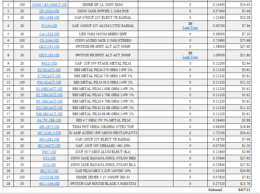

It certainly looks neat, but, seems a little expensive if it doesn't have a mic preamp?
For those that feel this is not much gear for a bit price tag, here is a list of the components used:
That is enough for 20 of these jigs. Notice the cost plus I need to pay sales tax on it.
Consider the time it takes to sort and bag the parts, build the enclosure, make the front panel, make the back panel and all of the other things that are not obvious to someone who hasn't done this sort of thing.
Still seem expensive?
sorry - not when you consider the effort it takes on your part making small batches.
It only seems expensive compared to mass "made in China" consumer goods...
I shouldn't complain, I haven't made one for myself yet. No, I don't want a refund.
