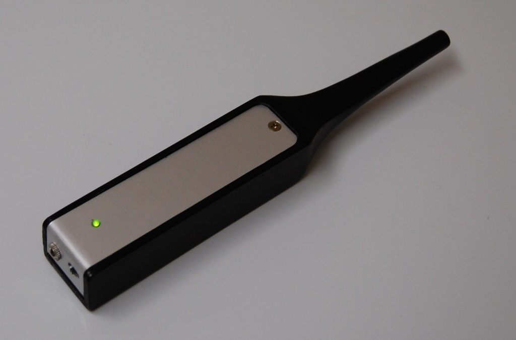

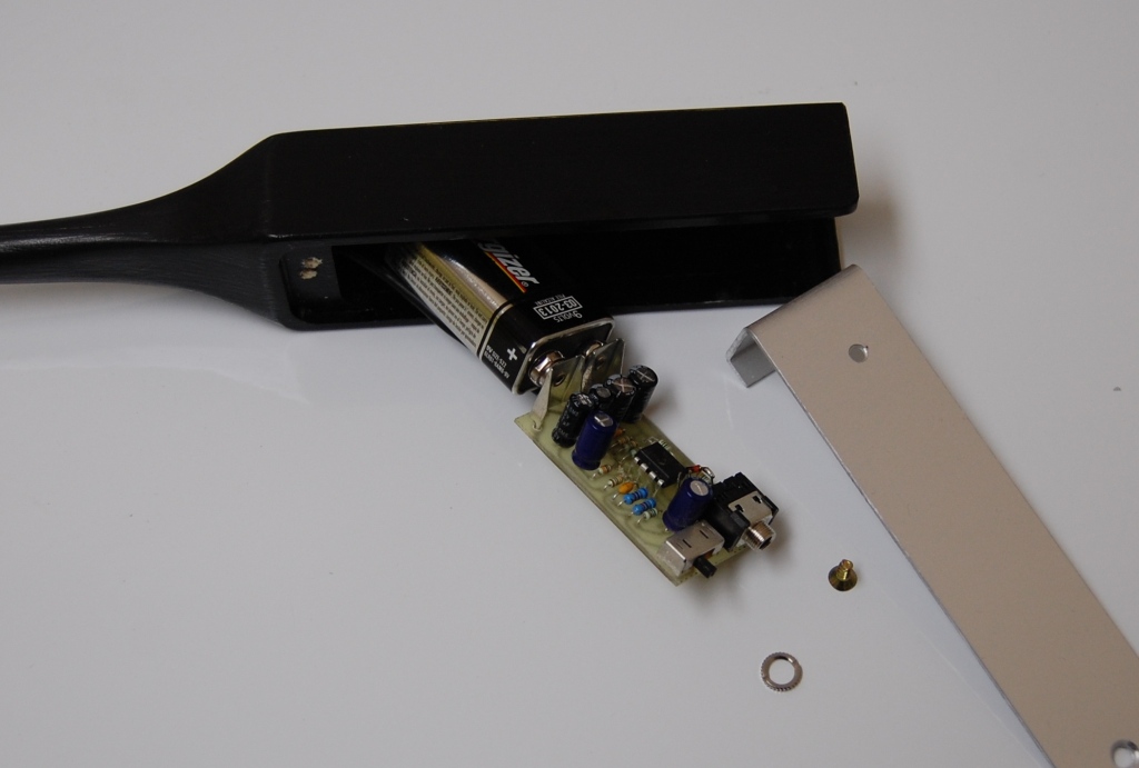

Also I have had several inquiries about the microphone posted earlier and would like to see if there is any interest in this as a kit also:
It uses the WM-61A capsule and has a built in battery powered preamp. It is perfect for the speaker testing jig - just plug it in and turn it on.
Post you thoughts here.
I will be ordering a limited number of PC boards for these to start. I will post back here with pricing as soon as I have that pinned down.

Count me in... I like...perfect mate for jig.

Regarding the mic kit - can you test capsules vs a calibrated mic or such?
I've built a few DIY mics with Panasonic capsules - I just use them without power or pre-amp straight to my sound card. Works OK, maybe greater dynamic range with the power/preamp setup?
It'd be awesome if we had some way of having (at least close to) calibrated mics for cheaper. I've got a few mics, none calibrated.
The only way I see that happening is if we find that a certain "batch" of WM61A capsules are all pretty close, so just one needs to be calibrated and then if we buy the kit, we can all use the same cal file with decent results?

I'm working on it - I need to come up with an easier way to make the case. The original is wood, which is fine for a prototype by doesn't fit for making multiples - it would be too expensive.
I don't think calibration is really needed for the DIY use of a measurement mic. There is a generic cal file available for the WM-61A capsule that flattens the HF response. The WM-61 is very linear in anyway.
SPL accuracy is not really critical, you want to be able to measure each drivers output relative to the other drivers and measure each speakers output relative to the other speaker.
If calibration is something you feel you need, the mic/preamp unit can be sent out for calibration, just like any other mic. The calibration comes in the form of a file they you input to the measurement software you're using (like Speaker Workshop or HOLMImpulse).

Ok, some interest but not as much as I expected. It would be nice to see a few more hands...
I'm not sure just how good the mic input on a soundcard is - they are not supposed to be very good but it is probably good enough for speaker testing. I've never tried to use one for that before.
The preamp I have in this microphone is VERY good though and has a couple of handy features for measurement. First it is ultra portable - it is a self contained mic with preamp. Heck, when you are done measuring you can even do some Karaoke with it, just plug it in to any amp and sing along...
It has 2 gain settings, 20db and 10db for nearfield measurements. It's ultra low noise, battery powered with regulated phantom power for the electret capsule. Low current drain, a 9V battery will last a loooong time.
Enough pitch, I will order a few boards, see what I can scheme up for the case and ask again if there is any serious interest in this unit.
I can say that it has made these kind of measurements very convenient for me, I won't look back.
