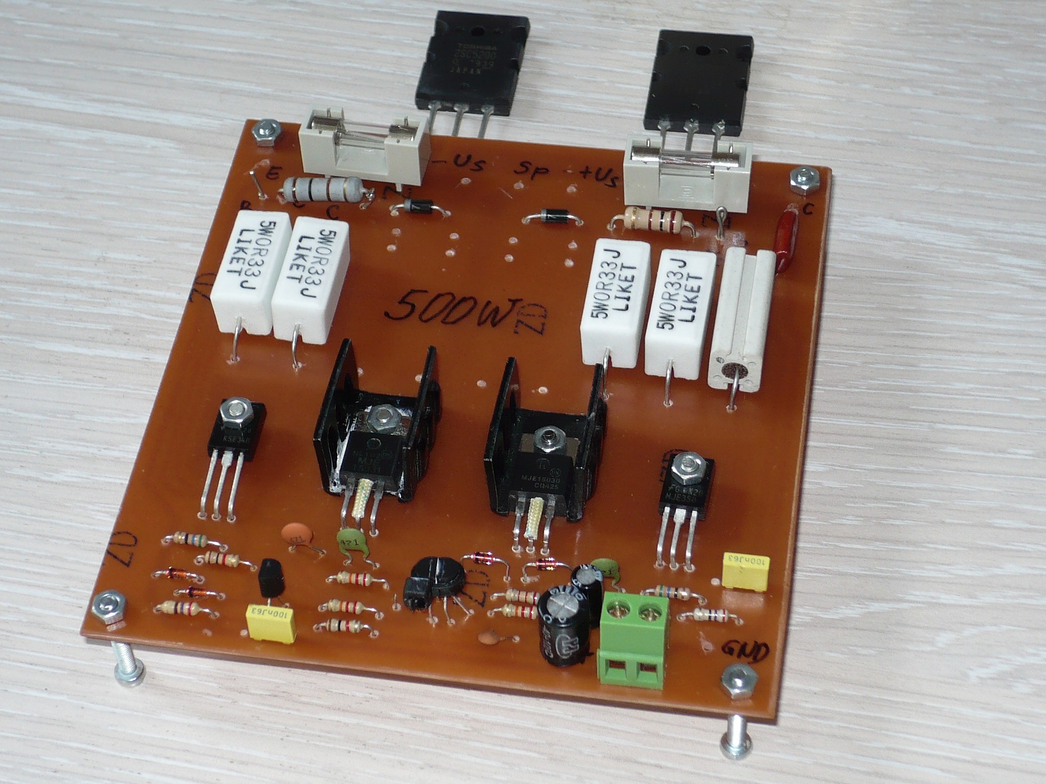

in schematics 2 caps 2.2 and 100 micro farad
but in layout there is 1 and 47 micro farad what is right sir?
Any of them will be ok, regards

Hi Mile!
I made this Quasi amplifier (picture below), but two things bother me: Why security diodes 1N4007 are connecting to the PCB in front of the fuses and why 0,33R/5W resistor is connected to the collector output transistor (2N3773), not the broadcaster?
Mile you do not need to make a correction?
Waiting quick response after I made amplifier!
thanks and cheers
