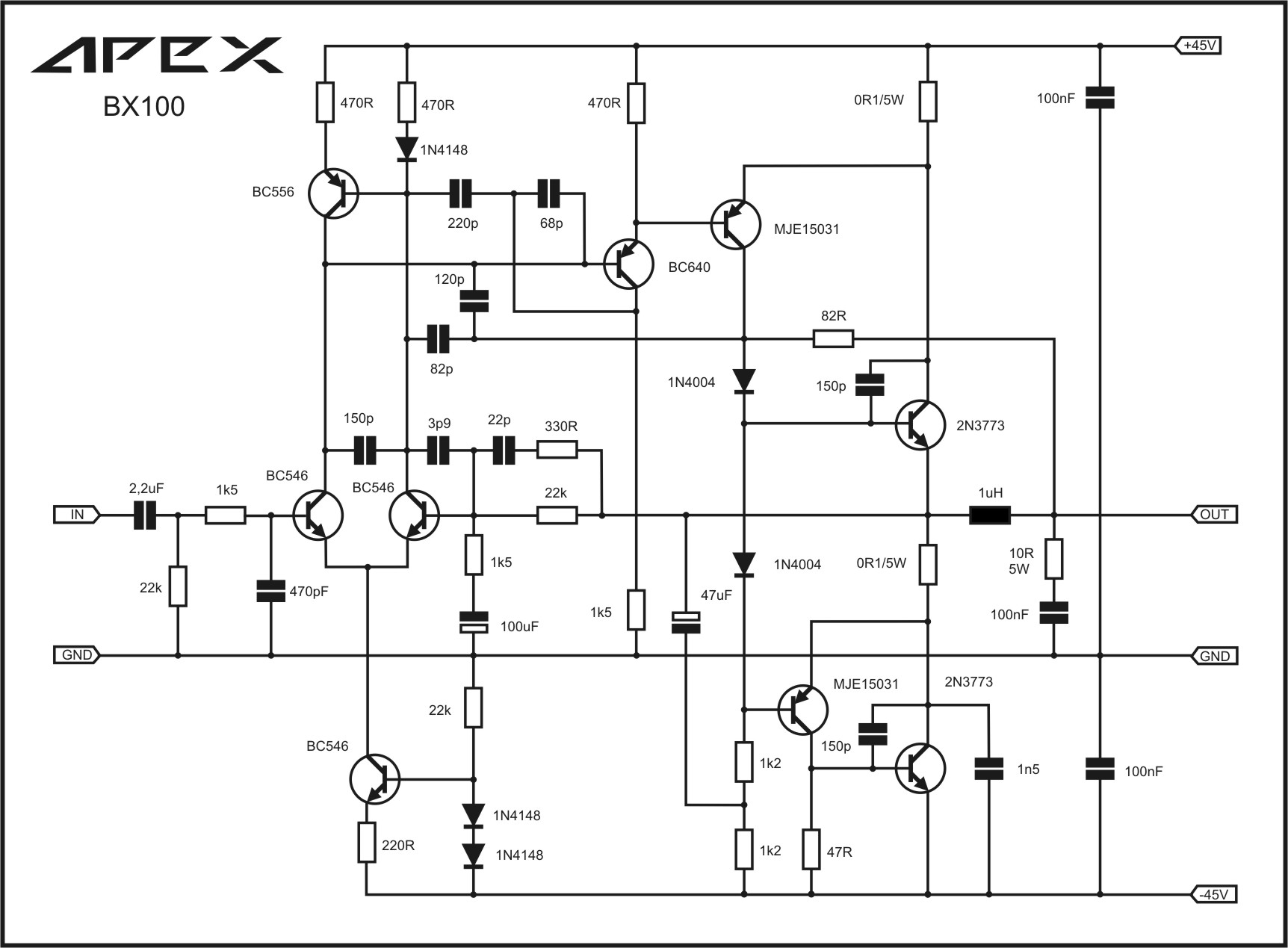

dear apex,Quasi complementary amplifier based on old Dynacord. For begginers Class B without adjust.
plz send me pcb image by which i can make by toner tranfer method.thaniking u.
dear apex,
in circuit input electrolytic cap is 2.2and 100micro farad respectively,but in component plan there is 1 micro and 47 micro farad what is right.regards
dear sir
transistor bc 546 is 80v trans.,bc547 is 60v trant. plz give me the equivalen of bc546 thanks
DUS = 1N4148
Use this pcb as start point and AX11 schematic with MJ15003/15004 in output... and you will have nice smal PA amp with overcurrent protect (BC546, BC556, 1k, 470R...)
