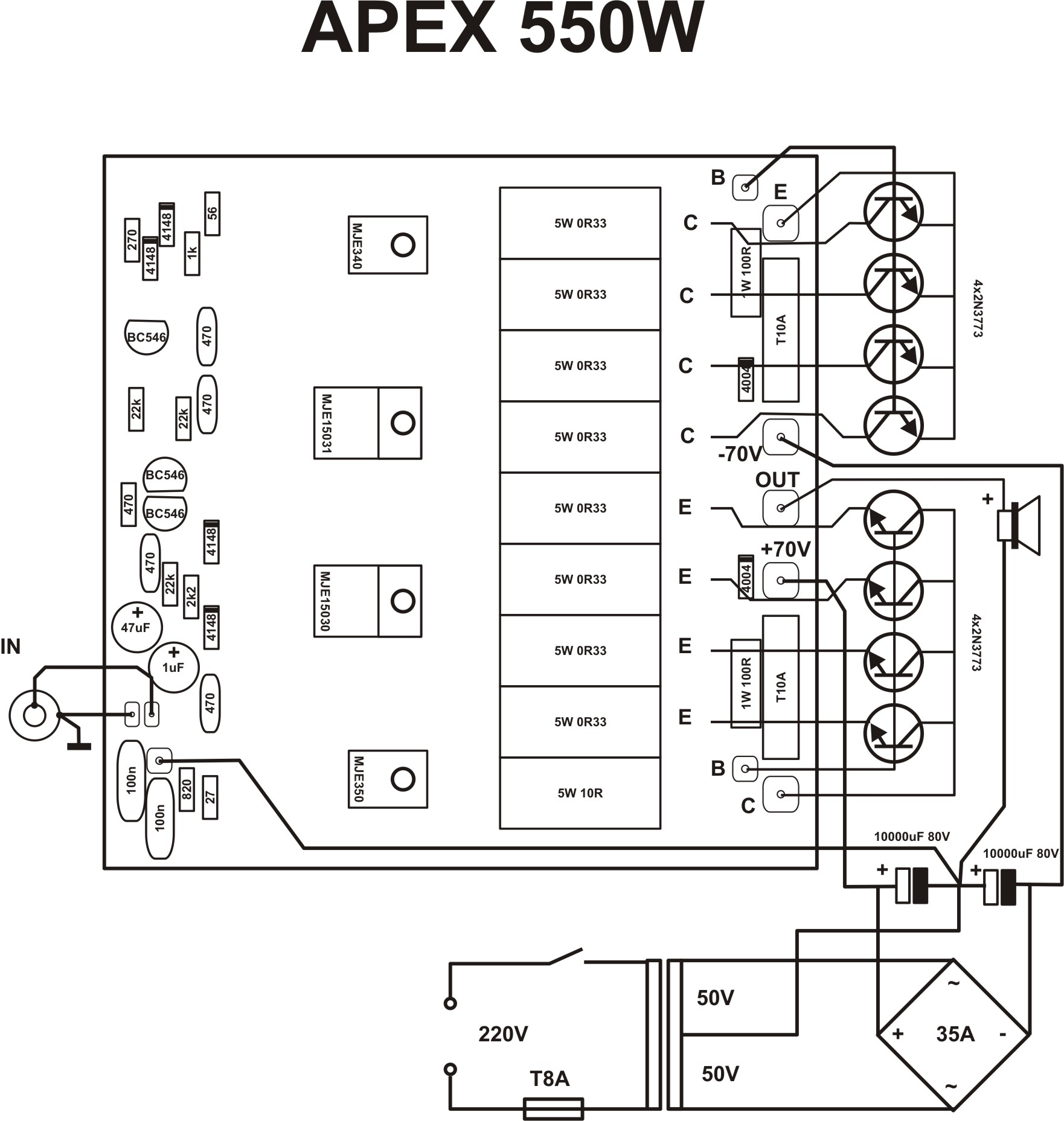

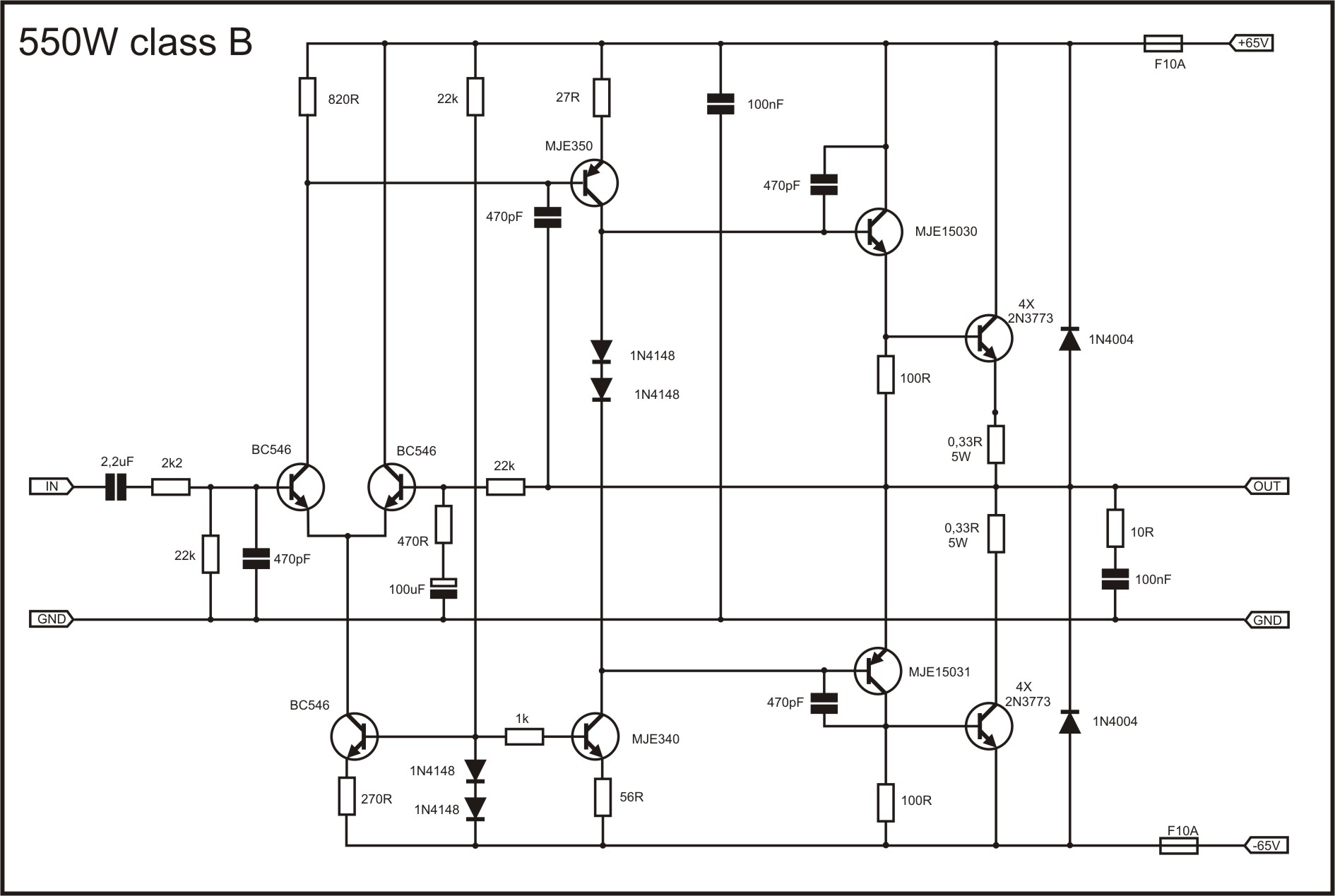

Quasi complementary amplifier based on old Dynacord. For begginers Class B without adjust.

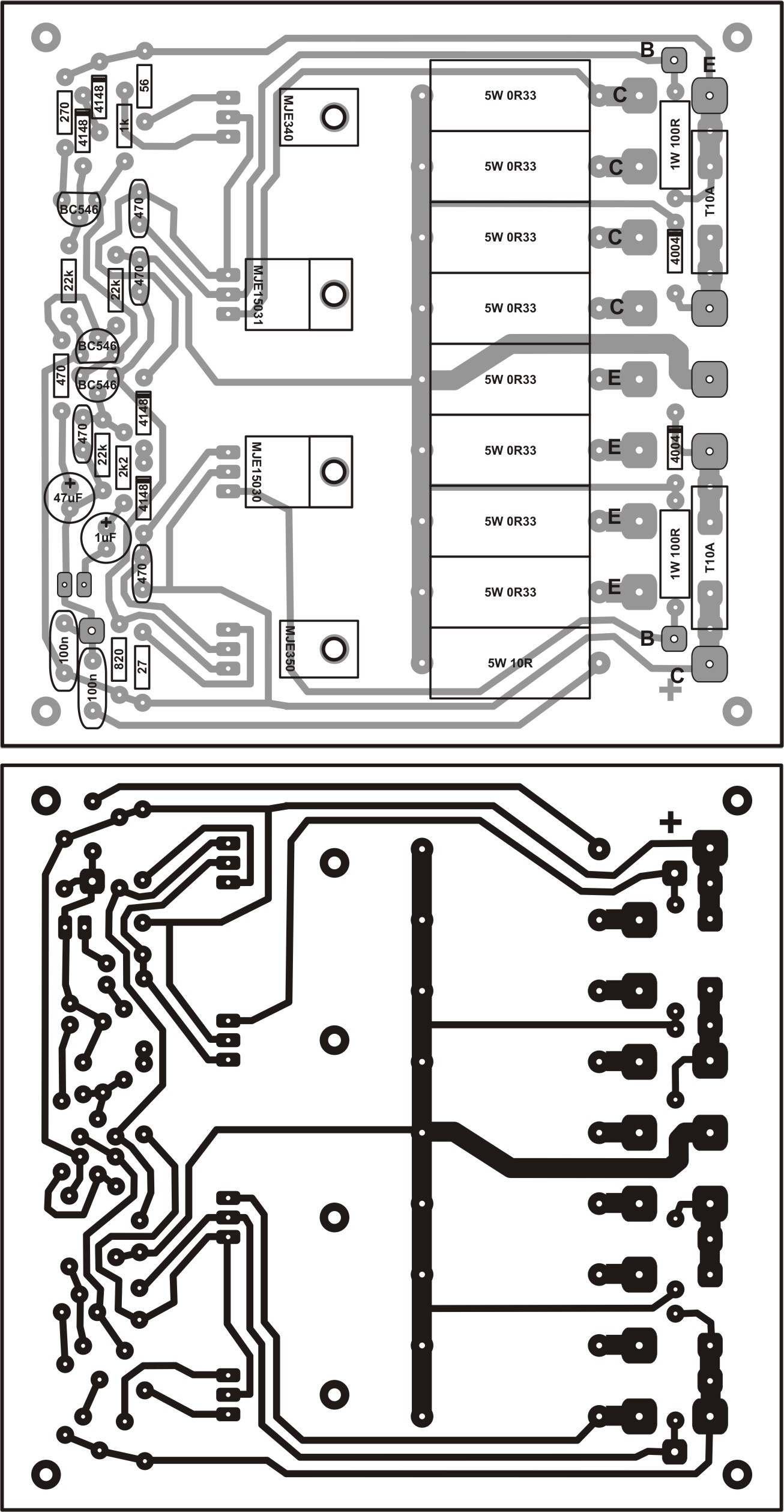

PCB with corect is in post #294
I use this circuit many times in the past for quick build 100-500w amp with parts which I already have, work every time, low cost and even begginer can do it as first amp ever. With two 2N3055 on +/-30V DC you can have 60W amp.

I have to honestly say that I dont think "beginners" should be building powerful amps. I also don't see why theres no adjust - a resistor, a trim pot and a transistor dont exactly add a lot of complexity to the circuit.
Beginners who want to build powerful amp for party... can start with this amplifier with single pair and add more outputs later, and they don't want adjust bias, just connect power supply and play.

I have not slew rate and distortion levels, I use this Dynacord clone long time ago, and there's no any modification for this circuit, but this simple circuit give you great chance to build or fast repare any old amp. This is retro design.
