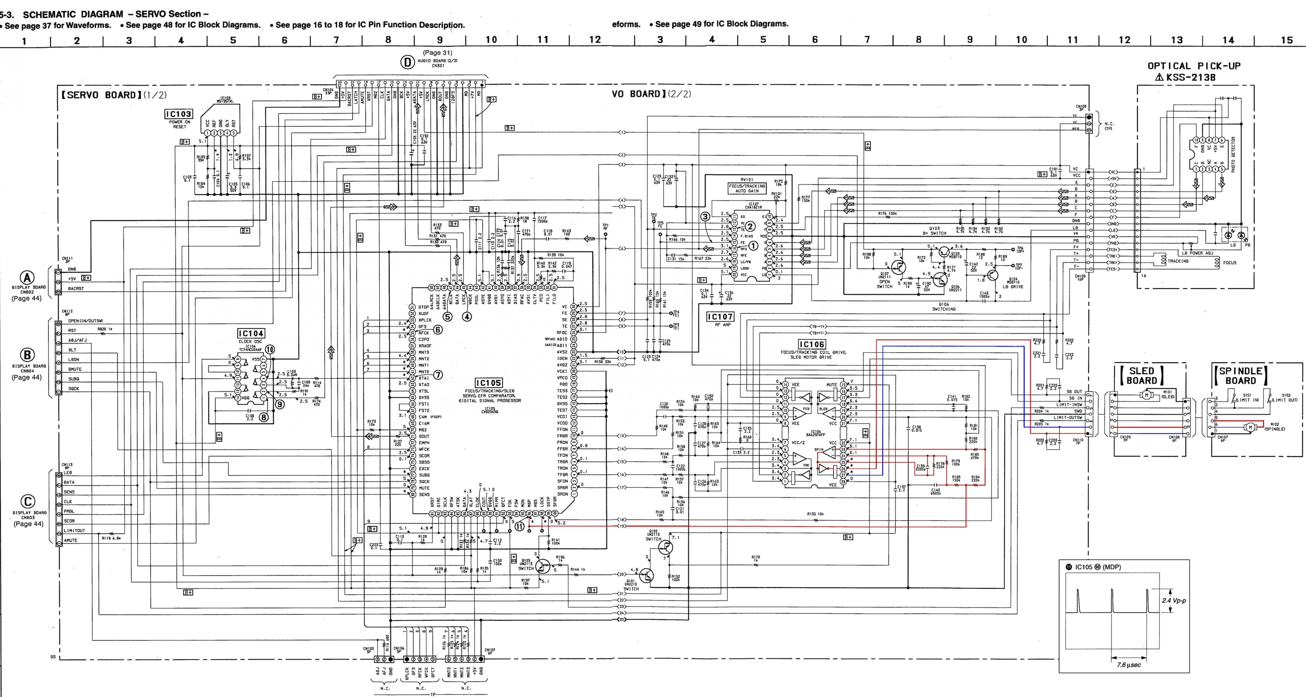

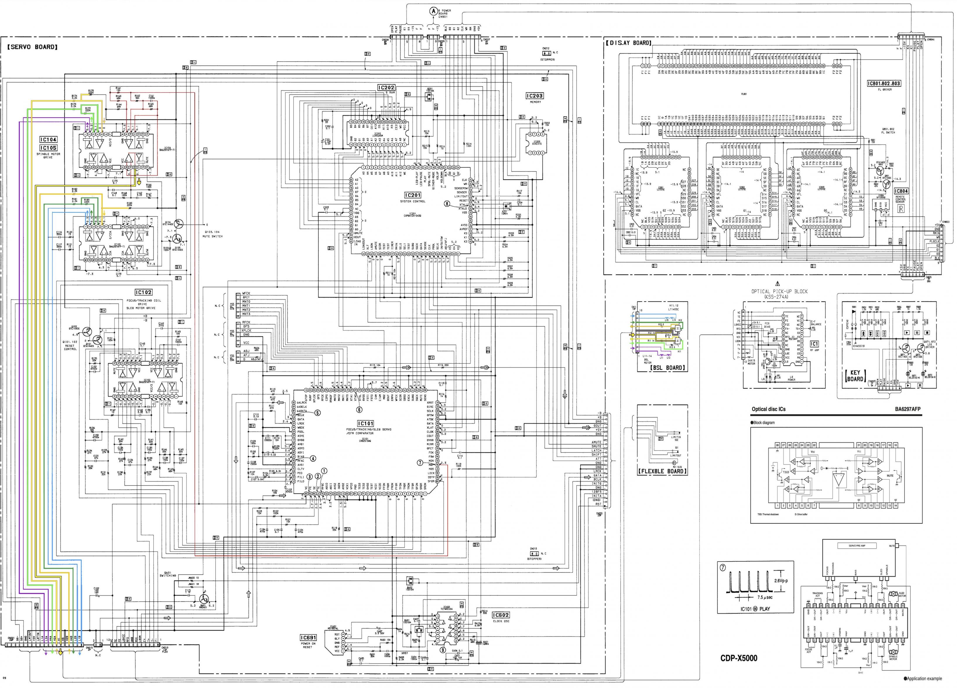

@miloyd:
Here is a comparison of a Sony CDP-X5000 (brushless motor) to a
CDP-X3000 (brushed motor).
Both use the same IC for driving the motors, BA6297.
I tried to understand the principles by coloring the traces but went not very far...

Interesting. The brushless motor does not allow the driver IC to directly drive the motor does it?. I would think that there is a motor controller that interprets the drive signal and performs the requested actions. That is something to examine, because all the brushless motors I have seen take the error signals and power supply. All the drive electronics are internal to the motor. Maybe they found a cheaper way to do this?Both use the same IC for driving the motors, BA6297.

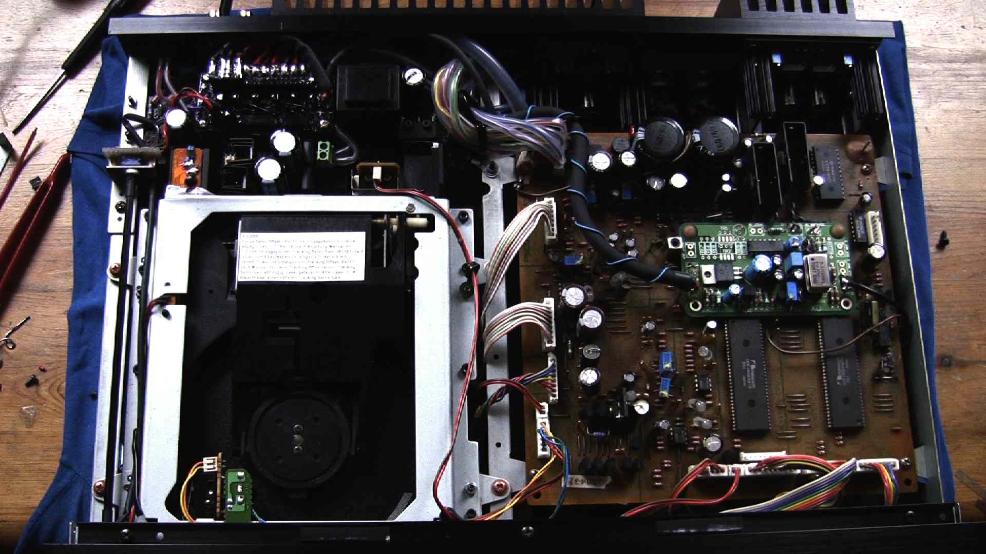

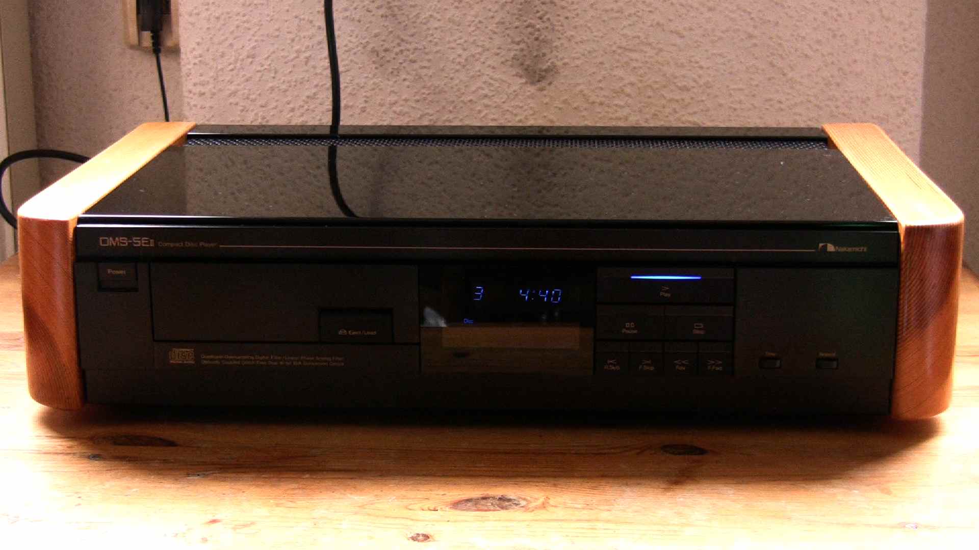

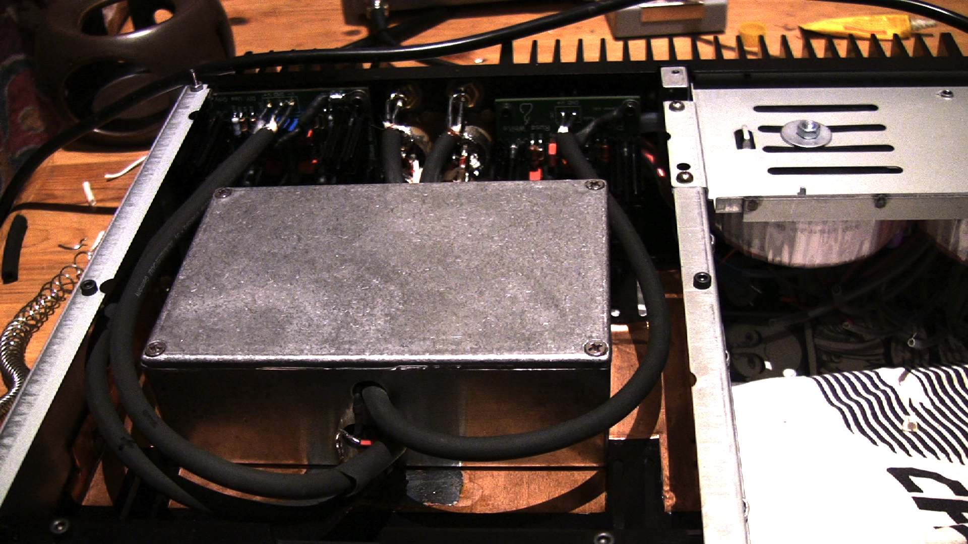

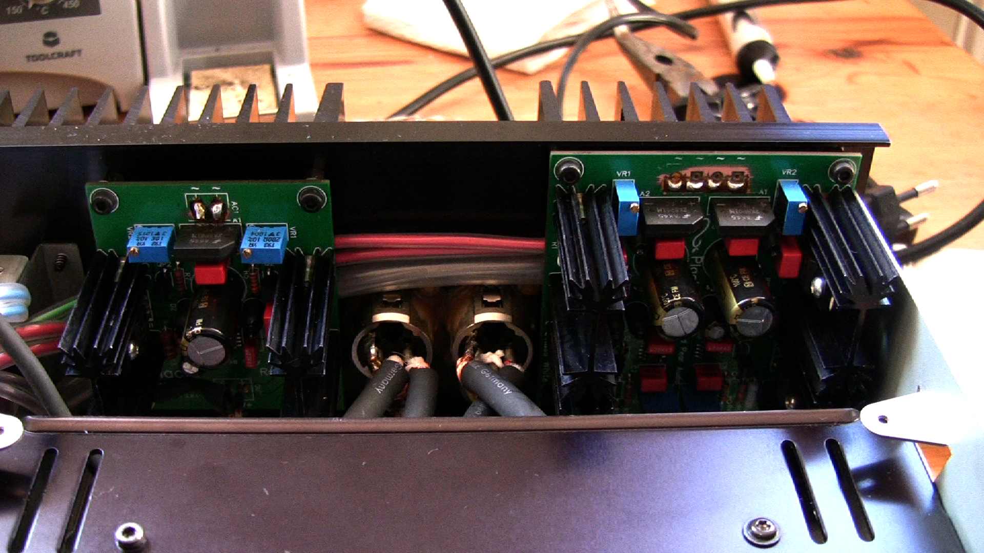

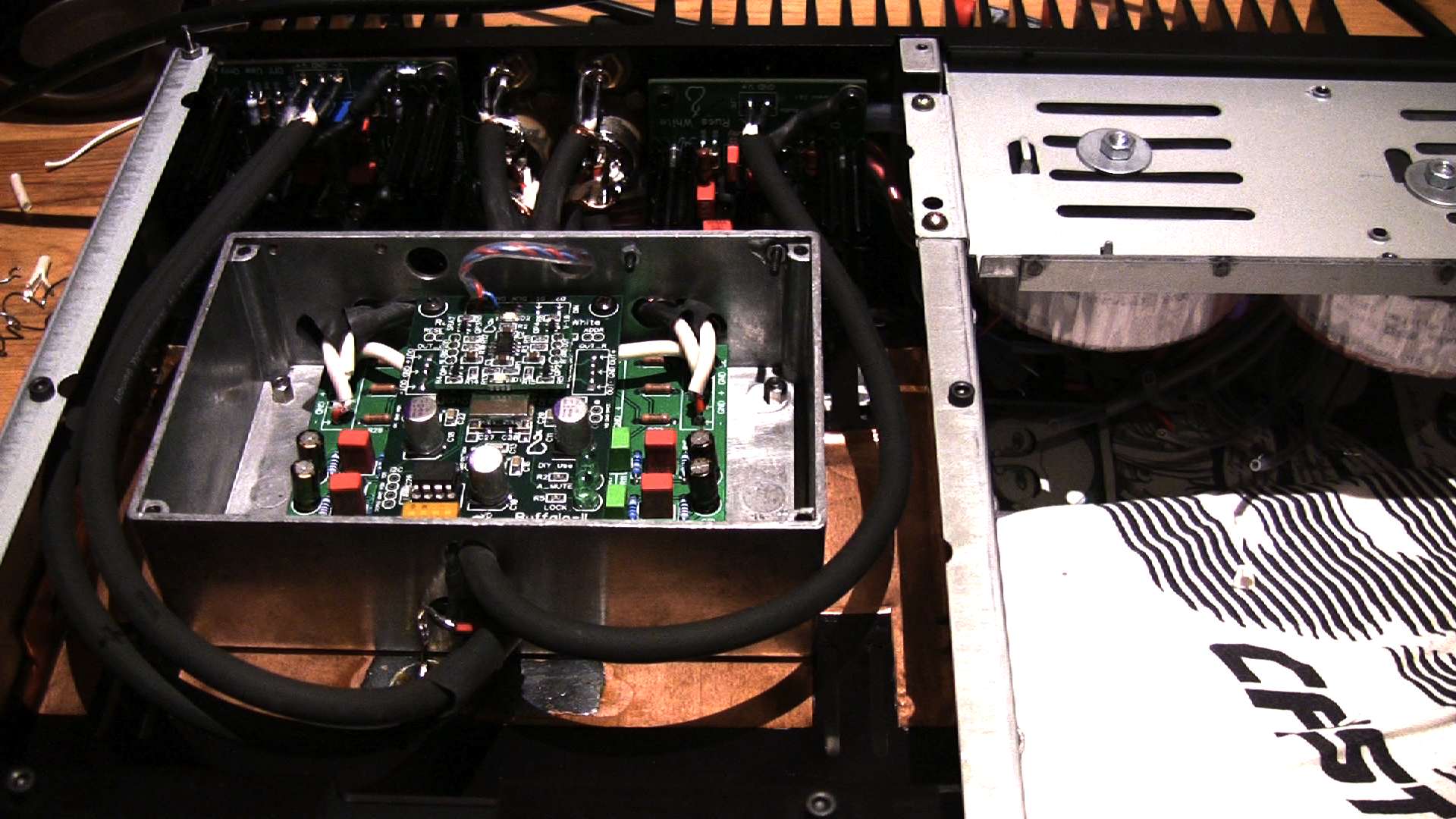

Did all this (6 inputs) with my Nakamichi - OMS5II and built
in a Buffalo II, to my ears one of the best.
Thus the Nak serves as Player and Dac, player circuitry
can be switched off.
Only AES and external clock are missing
Will definately do it with the new one plus
all the means to make it a good DAC.

No - Buffalo II is an ESs Sabre 9018 32/192kHz DAC.
http://www.diyaudio.com/forums/twisted-pear/219921-buffalo-iii-se.html
BTW, the original PCM 56 in the Nak I replaced with the Buffalo was 16bit/176.
Here are pictures of the mod:
Hi Salar,
How did you convert the digital audio stream to a newer type?
When I do my mod, I think I would want to put that much stuff in an external box. The clock and LR CLK and audio stream would be buffered and run into the outboard box. There is already a lot going on inside an OMS-7.
You can reply to this via normal email if you want. I had almost resigned myself to buffering the eye pattern and sending it into a complete chip set. I would need the mute lines in that case as well.
-Chris
Edit: How did you make the display blue? The buttons are easy - blue LEDs.
-Chris
I am Sorry, wrong naming:
I meant DIT4096
http://www.ti.com/general/docs/lit/getliterature.tsp?genericPartNumber=dit4096&fileType=pdf
All the best, Salar
I meant DIT4096
All the best, Salar
