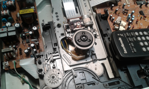

Inspired by this thread, I opened one CLD-1750K and plan to make top loading CD mechanism out of it. Then at the same time I might modified the DAC analog circuitry (they use terrible opamps, which might be why they sounded that cheap)...

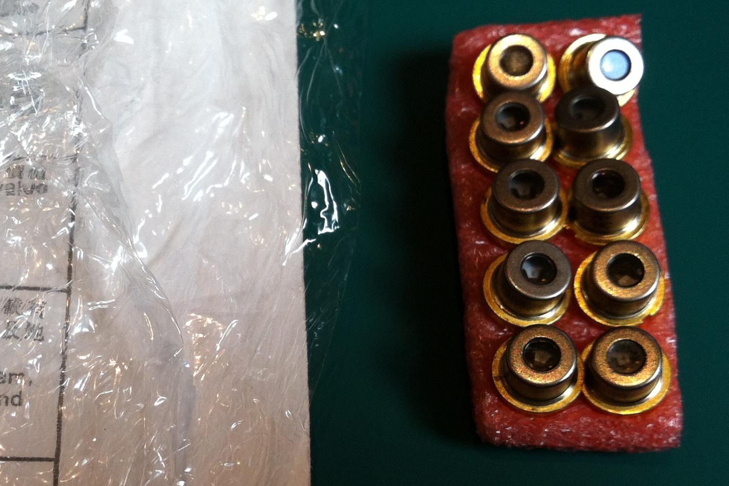

I got 10 Sharp Diodes from this seller today:
5pcs LT022MC Sharp Can 3 | eBay
They are meant to test ways to align the diffraction grating.
The photo shows how they were packed, no ESD protection to my eye at all.
Just the red foam, some plastic foil, a paper bag
Are they dead? Is there a quick way to test them without building them into a player?
Hi Salar,
Sure, pull the flexible PCB off an installed laser head and insert one of your new ones. Power up the CD player and measure the light output.

Thanks a lot. Somebody guessed that the pink foam on
the photo where the lasers stick in is conductive. Can anybody confirm?
About light output: I cab not measure lase power, only if the laser lights up i.e with a Digital camera wich reads infrared light.

Hi Salar,
The pink foam is very probably an anti-static. That might mean that it doesn't generate a static charge rather than being conductive. Conductive materials are usually black because that is the colour of the material that is conductive. It feels "soft" in the fingers.
