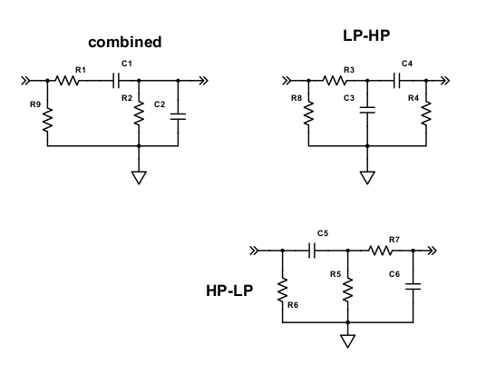

KK I am confused here is a high pass filter forming with C1 and R1 or C1 and R2 or is it C1 R1//R2 ?

The input HP filter can be before , after, or combined with, the input coupling HP filter capacitor..
The input network is a little more complex than a simple RC single pole high pass filter,
but that is its main function.
The input HP filter can be before , after, or combined with, the input C coupling HP capacitor..
The input network is a little more complex than a simple RC single pole high pass filter.

If the input network is complicated for filters how does one design it? I have seen tutorials where they shove just a high pass filter and a low pass and be done with it.
Here are three possible input RC filter circuits (omitting the single supply biasing network).
