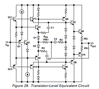

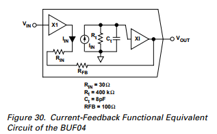

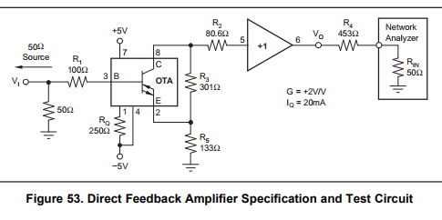

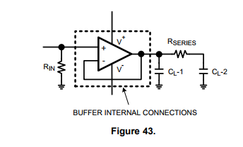

The fact that a BJT has a shared pin for input and output and typically an opamp does not is a mere detail; if someone made an opamp with the -ve input and output sharing a pin would you say that as a result of this it no longer employs feedback?
I believe you can buy a closed loop buffer chip that is just an opamp with the output internally connected to the inverting input.
It is also used inside instrumentation opamps.
Edit: found a couple. The BUF604 is interesting because it is internally a CFA with the output hard wired to the inverting input. How's that for controversy - a single post heresy on emitter followers AND CFAs. 100% feedback and it is all invisible!
Jan

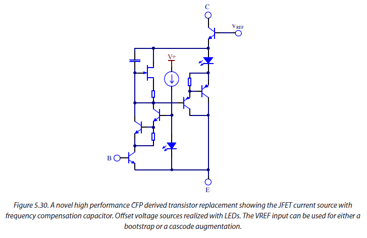

When you start to follow that train of thought, all kinds of interesting circuits pop up.
Most here are probably familiar with the so-called 'ideal transistor' or 'CCII' or 'diamond transistor' or whatever marketing came up with, like the OPA860.
Illustrates nicely the familiar resistive feedback divider feeding back to the emitter which functions as inverting input.
Jan
Jan
That, Sir, is your privilege, and you are fully entitled to it..... I am unable, at the moment, to understand .....
Consider a CFP. Here you do see the 100% feed back loop and the two transistors actually make a one transistor emitter follower
Another nice example!
Edit: here's a super duper 'emitter follower' from Arto Kolinummi's book.
Linear Audio | your tech audio resource
Jan

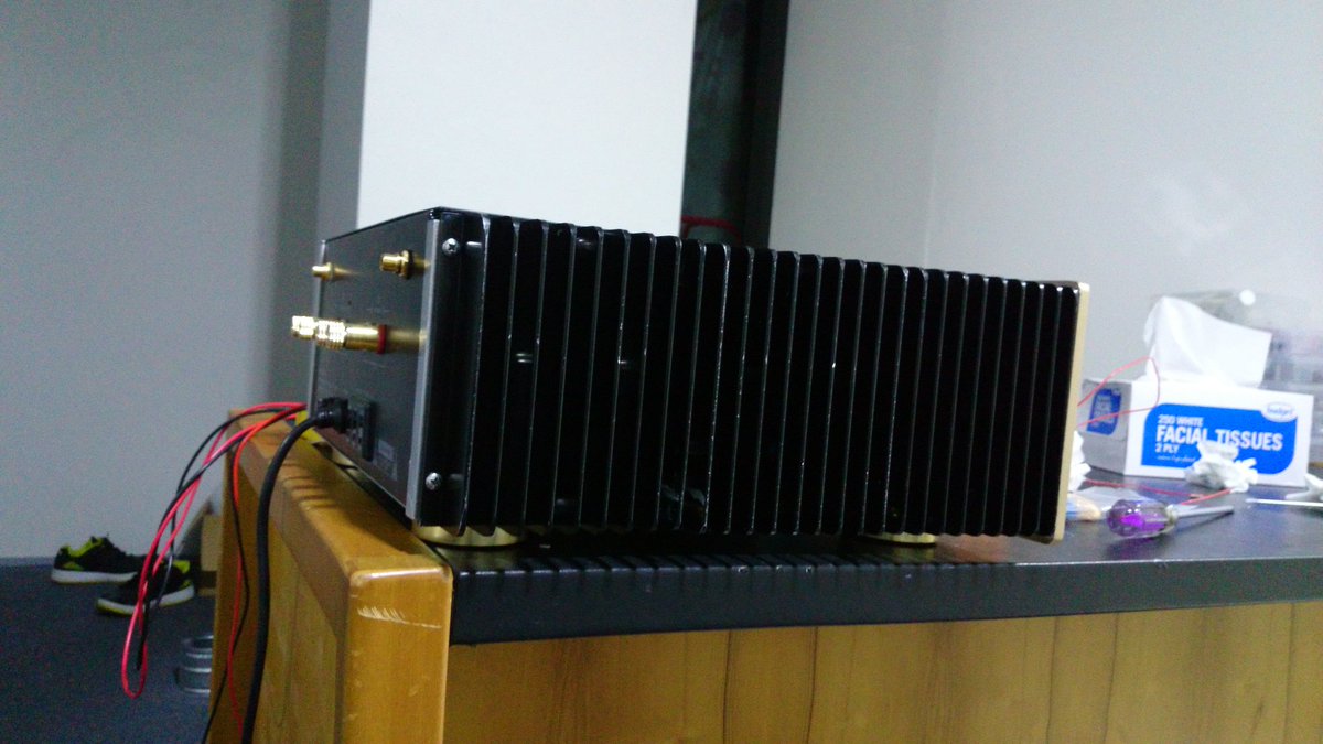

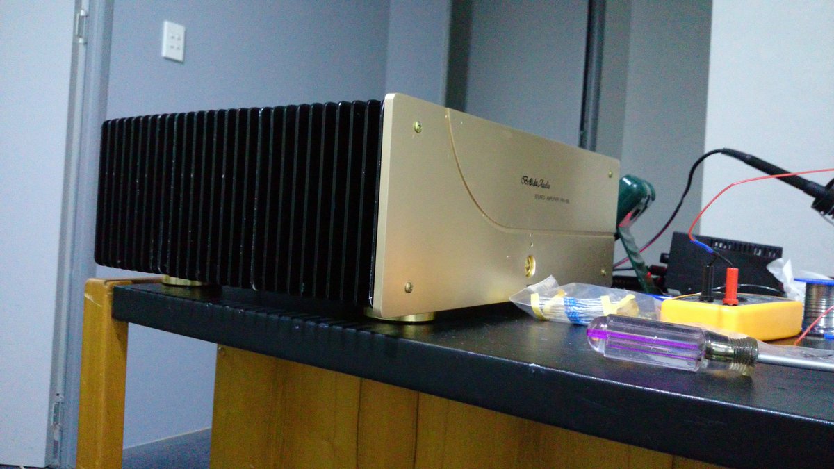

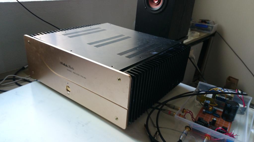

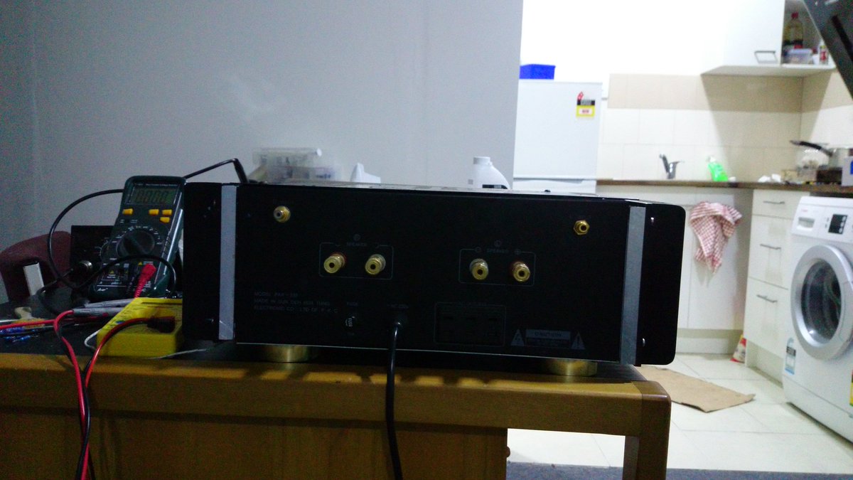

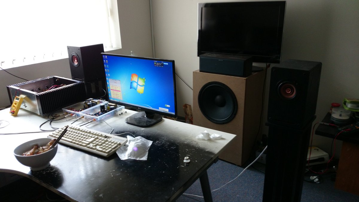

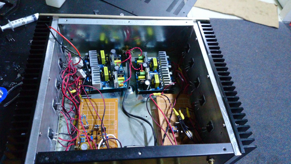

The main reason keeping me away from the L channel is that I did not realised I had 2 extra 24v supplies in my house untill I found out.
I installed my other channel and stuff is geting a cooking hot inclduing the switch mode inside. Drilled holes to increace natrual flow to the switch mode power supply.
I also did a minor mod to both channels, small mod but big diffrence in sound quality, sounds like a whole diffrent amp after the small mod.
Also swapped out the sanken transisors for tip3055 2955. I used sanken because I had 6 pairs of them. But after a direct comparison with l and r channel. Sankens soundled like a whole other amp with very poor resolution in midrange.
TIP3055s kept me away cause I only had 3 pairs of mospec and another 3pairs of st microelcotirc, did not want to use diffrent brands on l and r channel but ended up doing this cause I did not want to use my new 10 pairs of tip35c. (6pairs per channel of 36c 35c for next project class a)
TIP3055s sound perfect through all frequencies. Much more tube like taste and smooth golden warm midrange, I have tip35c 36c but those are for my next project with increaced cooling and +-24v to +-36v. Also with extra transistors in voltage gain stage to boost sound quality, if my new schematic dreamed of will operate.
I never had thought japanese transistors sounded that bad.
I knew from my exprience just changing out all japanese transistors to non japnaese transistors sounded better, but did not realised how big this impact was untill I had a direct comparison.
EDIT: with the from pannel instealled everything has heat sink paste in contact, so the heat sink in contact with the case also transfers heat. The front pannel also is very hot hand boling ,little less hot than heat sink but hot.
Bias current stays the same about 2.5amps but temps droped about 3C

My amd gpu x128 heat sink runs at 80+C and ran well for more than 5 years. It actually still works today but is too slow, outdated.Hi Mrcloc,
Yes, I got where he was coming from.
It's important to remember that the heat sink temperature is Ta, the ambient temperature, and the case temperature is higher than that. The die temperature will of course be even higher, and this is the temperature that matters. So a larger heat sink will not allow you to run it any hotter at all. It will lower the temperature if the total heat dissipation of the transistors remain the same. Yes, you can spread the dissipation out across more transistors. This will increase the SOA of the output stage.
The increase in sound quality is due to the idle current and not the temperature. This is especially true for Mosfet devices, but I find BJT transistors more linear than Mosfets are. The advantage with a Mosfet is that their SOA curves are higher than a similarly rated BJT. That and the amount of energy required to drive a Mosfet is often lower than a BJT, but they still need power to drive the gate charge. That means you need something better than a stage made from TO-92 devices to drive them properly.
The main point I'm trying to illustrate is something you said as well. Cooler devices will last much longer, and temperature is not the thing that allows a transistor to be more linear. That depends on current levels. A larger heat sink helps to lower the temperature at the same power levels.
Best, Chris
I'd assume transistors used in amplifiers to have equivlant or better heat tolerances.
I had ran to-92 transistors with bias boost and calculated internal temp was about 100-110c. max temp is 150c. It was heat sinked and ran at about 480mW. It ran for more than 3 monts still going untill I modded my amp again.
For my 3 pairs class ab vs 7 pairs output class ab. Both situations idle current was kept excatly the same. Had actually measured the idle current. I went from 3 to 5 pairs, then went from6 to 7.
Can hear a big diffrence when going from 5to 6 pairs, still a diffrence from 6 to 7 pairs but less noticble
