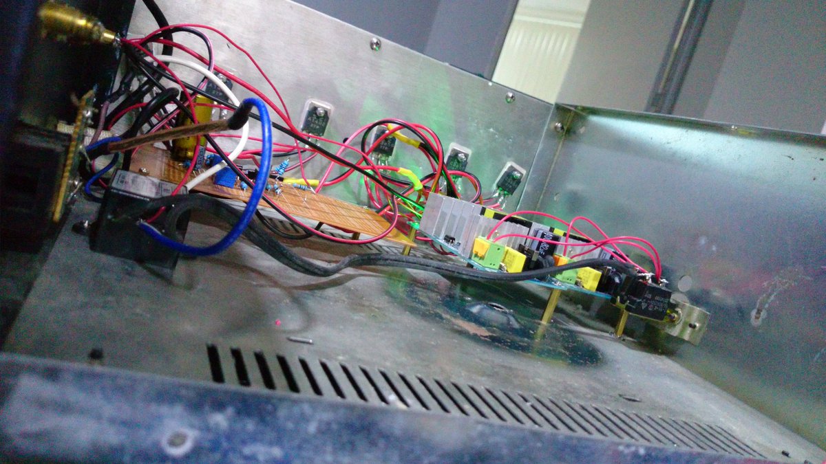

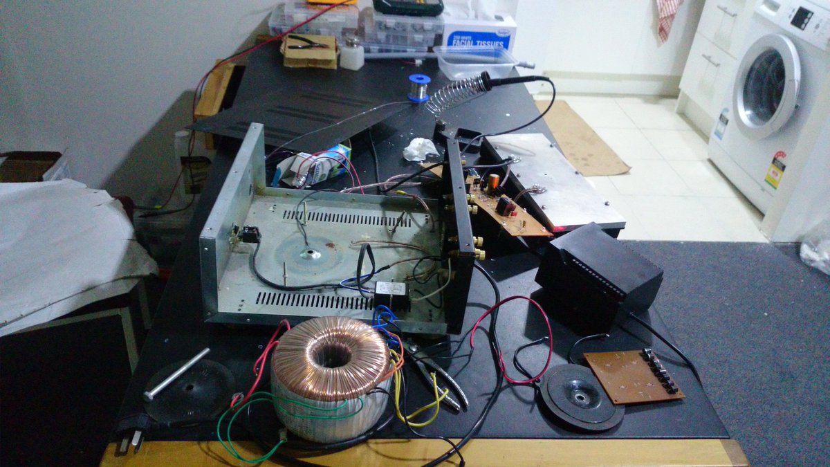

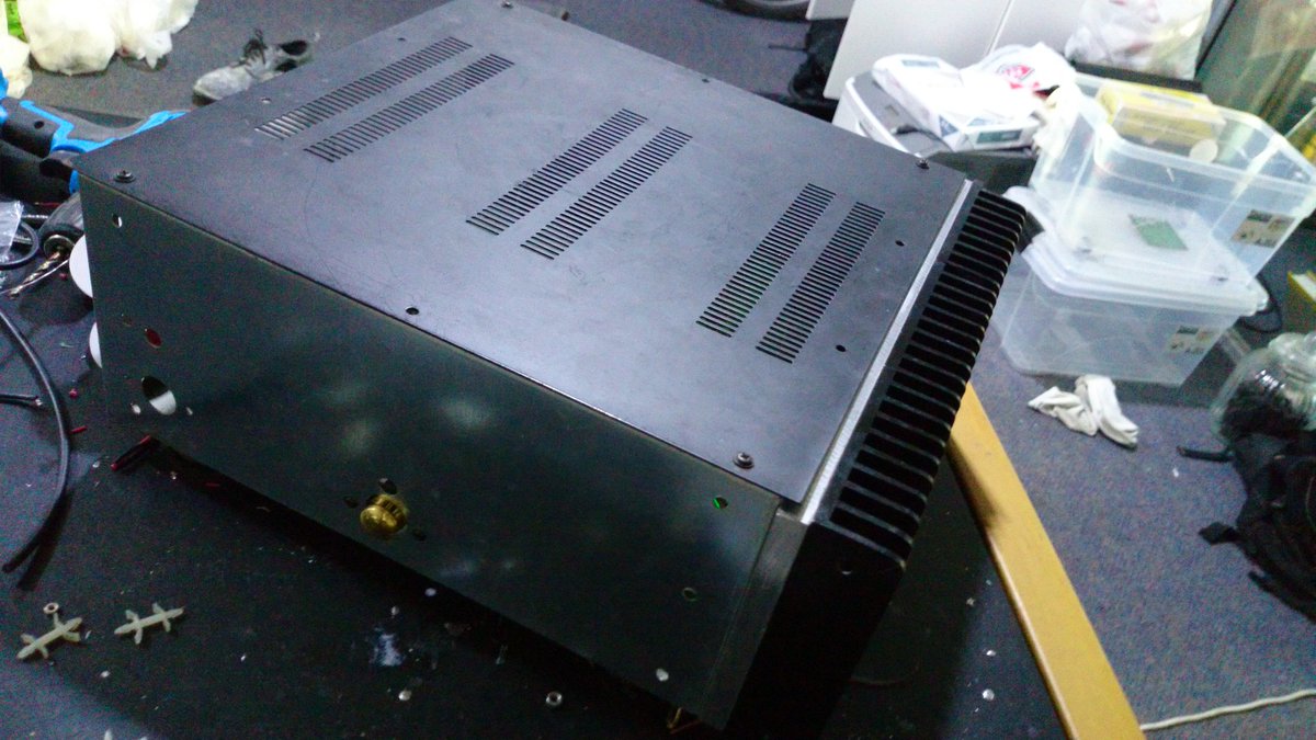

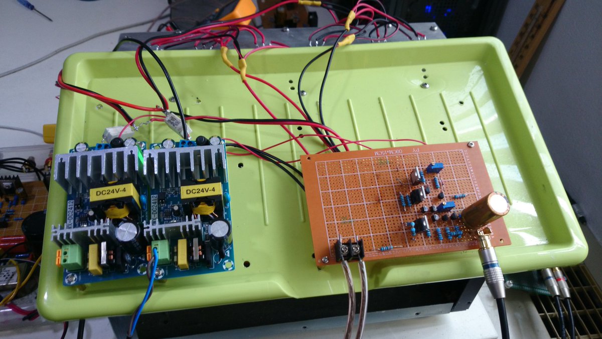

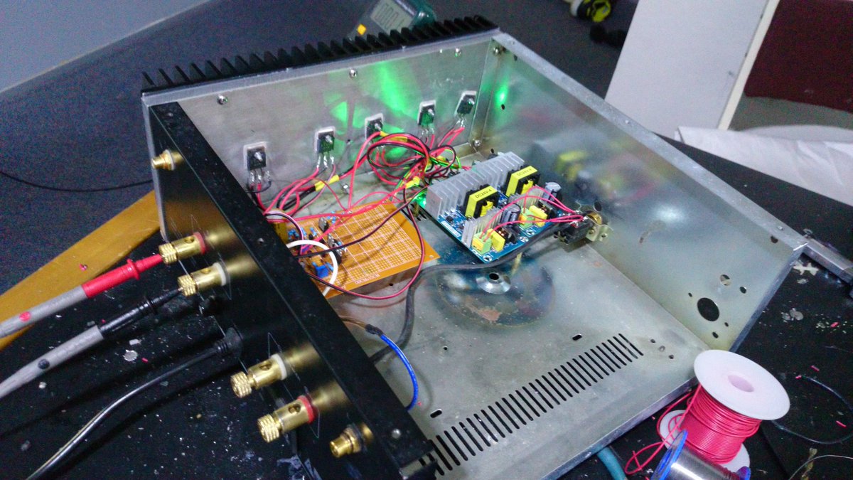

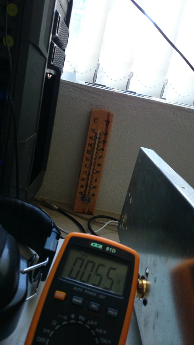

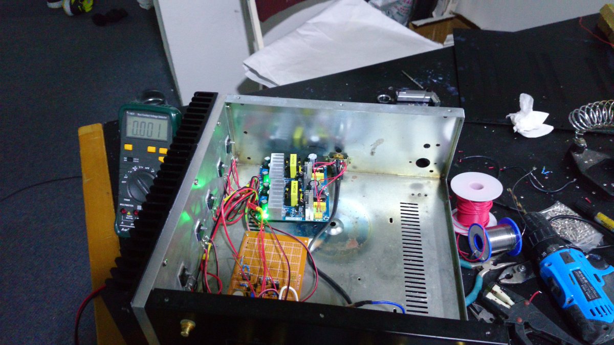

Rebuilt +-50v amp to +-24v Class A
As promised I will let you know if I modd my amp
Idles at about 2.5Amps, maximum output voltage is about 40-44v pk-pk without any distrotion or clipping, very clean and crisp.
The amp outputs in excess of 50W peak power (25w rms)
Because the amp operates in super class a(idle current dosen't change) up untill very near clipping.
Very loud music on 15 inch sounds much better than before, overall sound quality improved.
In the new circuit, there were a few refinements made to the circuit, and it has been redesigned to run on duall 24 volts.
No input or output caps, pure ocl.
I also kept my orignal pcb that operates on 2x50v so I can revert anytime if I want, thats why the new amp was built on a project board

It is best to design with the right voltage level and quiescent bias to match the expected load. For Class A these have to go together; too little current means early clipping, too much current means overheating. For Class B they can be considered somewhat separately.SMY14INCH said:Hey guys thanks for the response, I may want to conclude that change in supply voltage dosen't effect sound quality and its better to have lower voltage outputs with higher bias current.
No, that is Class A.SMY14INCH said:Because the amp operates in super class a(idle current dosen't change) up untill very near clipping.
Caps do useful stuff, which is why they were invented.No input or output caps, pure ocl.
explain why it is not Class A.

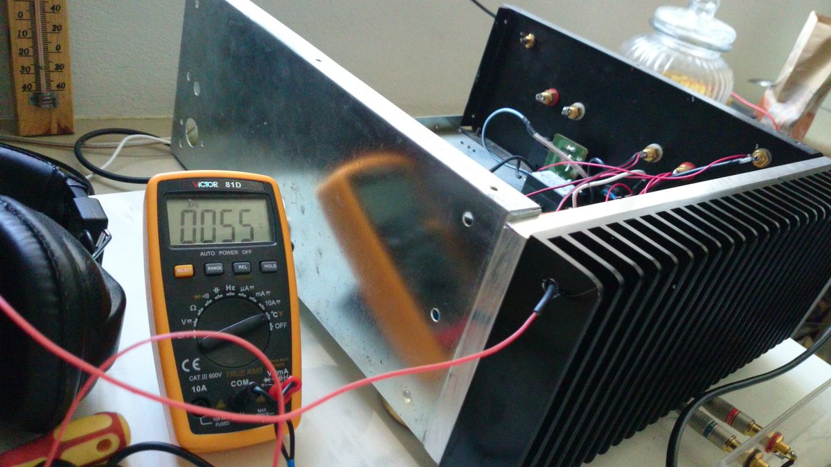

Clearly mine is Class A, it idles at about 2.5Amps, when music is playing current dosen't change, right up untill near clipping when driving a 100W low sensitivity speaker for testing purpourses.
The heat sink is 3.4KGS and you can see in pic 55C at approx 15 c room temp.
thats 120w of power consumed at idle.
I want to say caps do nothing but distortion, you put ac voltage through caps, theres phase shift and dilectric losses and all kinds of distrtion, a copper conductor direct input to a fet is always less lossly than a cacpacitor input.
If PCB are used, then resistance from transistors to transistor varies. with wires used, all resistance can be equal and the effective resistance would be lower than on a pcb without added copper tracks
Each wire used can take in excess of 5 amps, approx 8amps no plorbem can do 10amps warm.
With the orignal pcb for the amp it is impossible to have equal emitter and collector resistance for all transistors at output stage
No they are not and they all share the load nearly equaly. Wires are all same lengthAll bets are off with the length of those wires to the transistors...
Amplifiers with flying wires are far more likely to misbehave than ones without them. You may get lucky, you may not. You may equalize the resistances, but now have a lot of unnecessary inductances - including the mutual kind.
Even if the amplifier does not oscillate, you will have nowhere near the distortion and noise capability that the circuit could otherwise have. With a simple circuit, and class A operation you may get away with it. But you later go to build something bigger the same way and it doesn't work. Then you'll be back here asking why.
I thought you said my amp wasn't class A but apprently that wasn't the case.
Wasn't awake this morning when I did the reply
What I was implying with the idle current is that it dosen't need to increace right up to near clipping, for a 40v pk-pk the current through transistors required are about 2.5amps, i'm idling somewhere at 2.5amps.
Class a means half of maximum current when driving a speaker, whats happening here is little bit more extreme than class a so i called it super class a.
Thanks for the tip, but in my point of view, then noise picked up from the wire is negible and low same with inductance.Amplifiers with flying wires are far more likely to misbehave than ones without them. You may get lucky, you may not. You may equalize the resistances, but now have a lot of unnecessary inductances - including the mutual kind.
