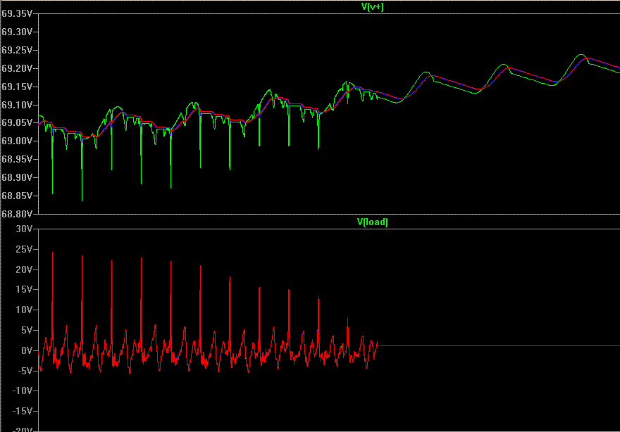

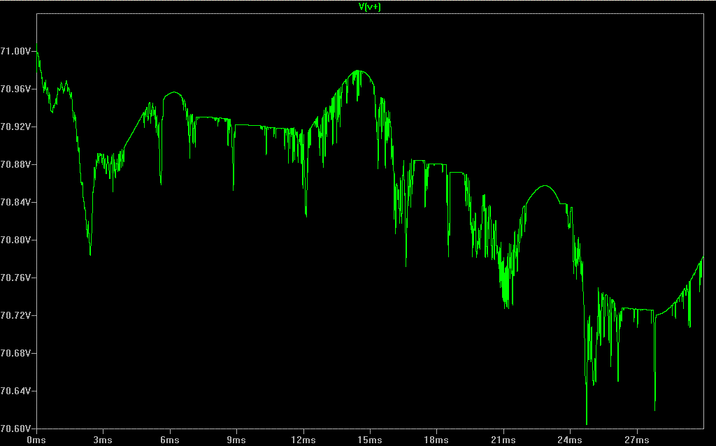

Thanks very much for pointing that out, mightydub, I've just started playing with what you put up. As a simple start, just adding ESR to the smoothing cap's ...
So, now be afraid, be very afraid ...!!!

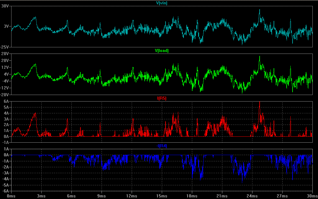

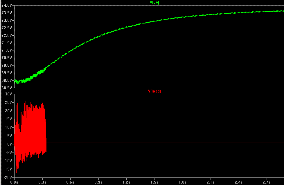

What I did was use a jazz track WAV file to drive the current in the load resistor, in other words, a real world situation!
This is rough, very rough, but gives a starting point to show what happens in real components ...
Woah!! Scary stuff, what does this show? The top pane is the +V voltage rail!: green is when ESR of the 35,000uF smoothing caps is 30mR, a quite excellent figure for a typical electrolytic, blue is 3mR, red is 0.3mR. Bottom pane is the driving audio track, the voltage across the load resistor; a high volume but one that the amp should deal with ...
To "prove" this is not a fake, then go to the end of the track, audio drive drops to zero -- we then get the classic, textbook ripple across the smoothing cap, voltage building up again to unloaded level ...

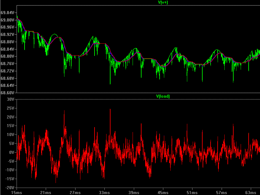

Now, zoom in to a small part, and really see how the load current is badly upsetting the voltage rails:
This is the real world, and we haven't even looked at any of the other parastics in the game, yet ...

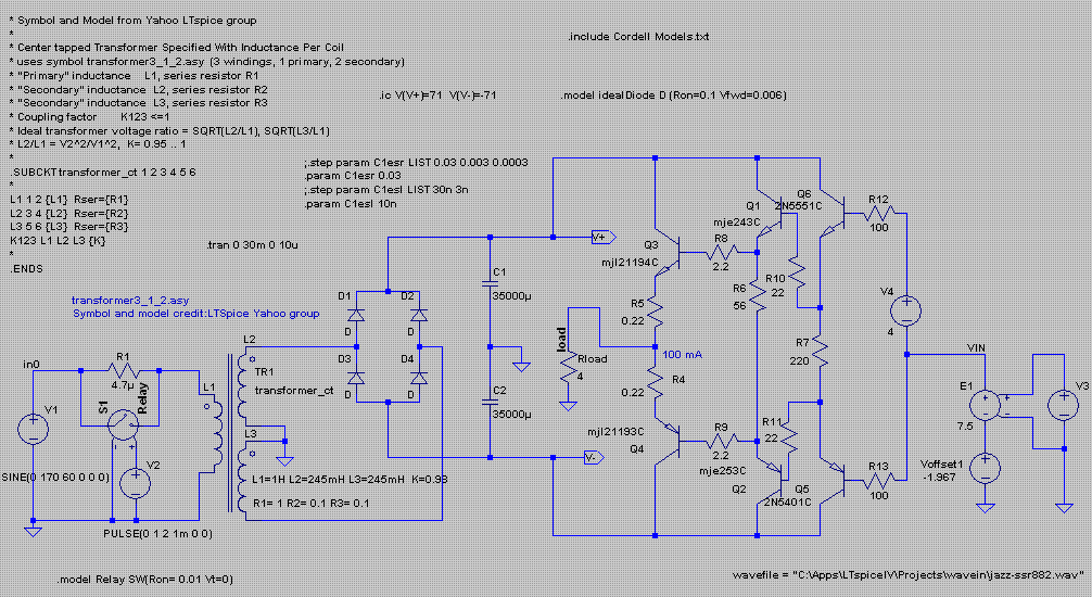

Okaaay, got something a bit closer to a real class AB amp working, driving the power supply, and this is combining mightydub's power supply sim, and the back end of Bob Cordell's posted LTspice model, from another thread here:
Note that this sub-section of the amp, which is mirror reversed compared to how normally shown, to match the original class B source, is merely a current amplifier, no voltage gain here. The VAS, so to speak, is device E1, an ideal voltage gain stage, shown here with a gain of 75. Again, the source input is a jazz track WAV. And there's no feedback, so there would be a fair bit of distortion if you looked closely, but that's not the point at the moment, we're looking at what's happening to the power supply.

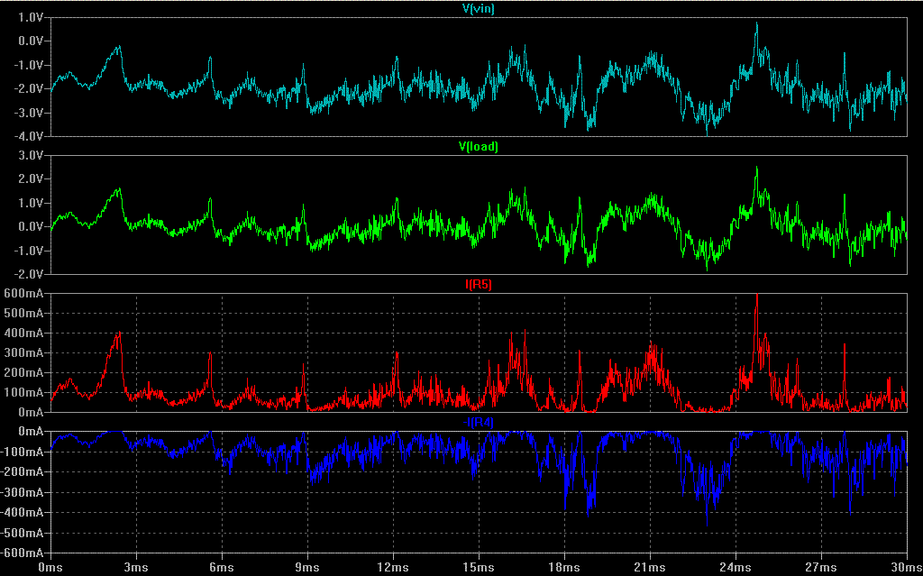

First off, to show this is true class AB, we'll drop the gain to 7.5, where the output devices are sharing the current drive to the load much of the time:
This is not taxing the supplies severely, but there is still quite a bit of noise on the voltage rail; power supply as before, with ESR of the smoothing caps at 30mR, a quite realistic figure:

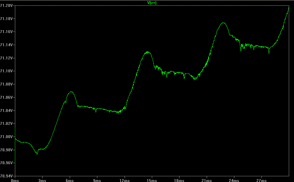

Now, we'll drive the output stage hard, push it heavily into class B territory, by upping the gain to 75:
Note the output transistors are really switching off hard now, but that's not the real story, here's what's happening to the voltage rail because of the high current drain:
Next will be to start playing around with the parasitics, and the smoothing circuit area, to see what can be done to help matters ...

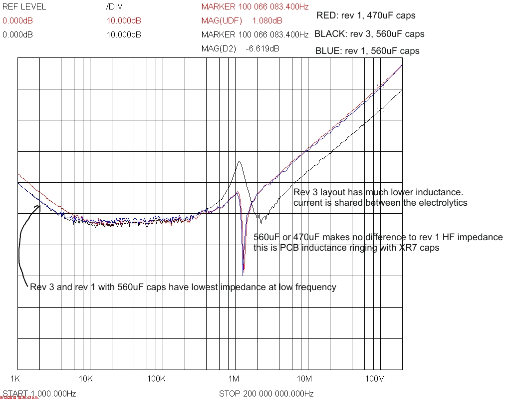

here's an output impedance plot for the LVDC bus on a +24V 100W smps. Both layouts are on a 4-layer 2Oz 1mm thick FR4 PCB. the Rev 1 (Red & Blue) layout had a small bank of X7R caps at the rectifiers, but the layout was not as good. The rev 3 layout (black) was re-arranged such that the load current was shared more evenly, and the X7R caps were moved to the load end.
Both measurements were taken at the load, with the rectifiers removed, scale in dB-ohms. although the sharp impedance trough in rev 1 might look like a good thing, in practice it means there are some complex resonances involved which are poorly damped - never a good thing. rev 3 reduces the impedance swing by 10dBOhms and its fairly well damped.
thats only 9*560uF 35V RubyCon ZLH caps = 5mF, and |Z| = 10mOhm @ 5kHz. Layout is important, but its clear that 50mF should drop this down to below 500Hz. LF performance is the parallel combination of the DC bus impedance and the transformer/rectifier output impedance, but I havent got any convenient plots to share.
this DC bus was designed to provide a specific lifetime at a given ripple current, with a nasty height constraint, for the output of a PFC flyback converter. Measured with an HP3577A + HP35676 50R signal divider. full one-port calibration at the DUT (I have a set of DIY "calibration standards" with vertical SMA sockets, and I attach an SMA socket to the DUT so the interconnect is pretty much excluded)

How about posting the .asc file(s)?
What diodes are used in the bridge? Maybe right-click on them and put some "real" power diodes in?
Need to model at least the main power-rail conductors, between the smoothing caps and the load, as series inductance and resistance (25 nH and 1 mOhm per inch).
Lower priority: Maybe try two of my transformer model, or similar, since the one being used doesn't have leakage inductance. (Might need a snubber, then, however.)
