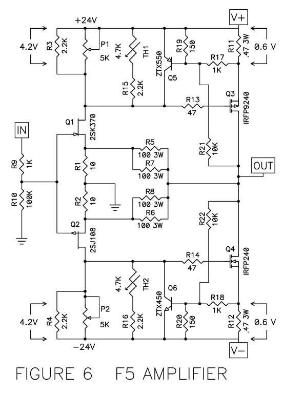

Hi guys,
Here is an example of some of the ideas discussed on this thread regarding local decoupling. I'm working on this F5 layout since I might be doing a second amp. This layout is not finished and there are several errors in it so this is just to show one way to accomplish the local decoupling using 47u + 220u + 2200 or 4,700u and would like to hear your comments.
On the running amp I have decoupling done with 4,700u plus a film 0.1u which I will replace in the future with a 220u and see if I can here differences. The PSU is quite heavy with a couple of 800VA trafos and a CLC filter feeding both channels.
The new amp will have only one trafo and a similar CLC PSU
What do you think?
Cheers, Tony
Tony,
A schematic would be great.
What are the R11 values? And what do they do? Damping?
Wow, are you actually bringing separate power and ground to each decoupling cap?! Coool!!
And two parallel paths from there to the device! Nice!
I wish there was some way to get the decoupling caps closer to the device. But the parallel paths will help mitigate that, a lot.
Are you sure that your high-current traces are wide-enough?
Is there a ground plane that you didn't show? Otherwise I would worry that the "signal in" and "signal ground in" are separated as they are. You need a separate ground plane for signal ground, for that area, to stay over or under the signal in. Otherwise those two will have some "enclosed loop area" and will be a hum and noise antenna. Alternatively, you could try keeping those two very close together, everywhere.
It looks great, overall!

Thanks for your nice words, schematic is for the Pass F5… you can see attached. The layout is a work in progress, not finished and power traces will be thicker, left side (IRFP240) is finished but the right side is only a mirror for the moment, the idea was mainly to show the local decoupling with separate power ground for each cap and near the power tranies with actually three separate traces to the load.
R11 + R11B sum 0.47R and is the source load.
There is no ground plane, it's a one side PCB. Signal ground lands at the input with signal and from there we have a connection to star ground near the PSU. As far as you may see the circuit doesn’t allow many ground options. I have an F5 amp working with that exact arrangement with no trouble but if you see better ways to handle the ground I'm all ears.
Cheers, Tony

Tony,
Totally-crazy idea: Use a two-sided PCB. <grin>
Seriously, I made two-sided PCBs by hand, all the time, a few years ago, and with MUCH-smaller features and larger board sizes, with just a 20-year-old laser printer, some paper, and a clothes iron (and some swimming pool acid and drugstore H2O2), "in under an hour" from computer to copper. Traces and trace-separations down to 0.01 inch were like child's play. I also put a component-layout "silk-screen" on every board, since it was so easy and quick to do. I "think" that I documented the 2-sided techniques that I developed (along with documenting the basic board-making process), at http://www.fullnet.com/gooteepc.htm . [And much better info than mine is probably now available in the Homebrew_PCBs discussion group, at yahoogroups.com.]
I actually quit using protoboards (especially those white ones with the plug-in rows of holes), beacause it was so quick and easy to make a pcb that would be so much more reliable (i.e. trustable) in its performance. I made at least one a day, for a while, back then.
It will help a lot if you have good PCB-specific software, since doing "copper pours" that automagically flow around (but don't touch) existing copper would make it much more practical.
Back when I started doing my first one-sided boards, I was using MS Paint! It worked. But wow was it tedious (although not as bad as people might imagine, once you get a "library" of your hand-drawn "component footprints" all saved in one big bitmap file).
