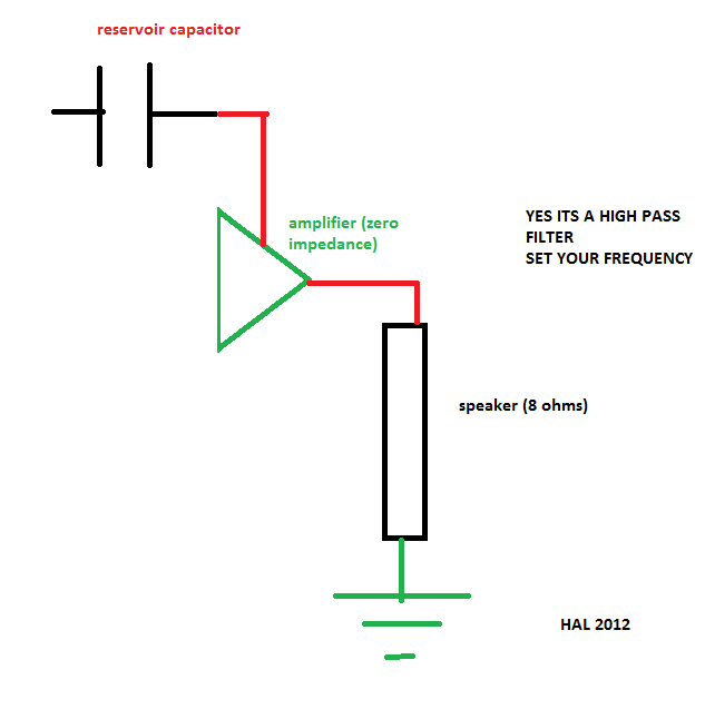

http://www.diyaudio.com/forums/atta...727278t-power-supply-resevoir-size-simple.png
This is the way I approach it now.
It is a filter.
This filter should not interfere with the action of the NFB.
This filter should not be the dominant roll-off of the bass frequencies. The input filter does that.
I set the pole of the reservoir capacitance at least a full octave lower than the input filter.

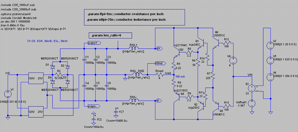

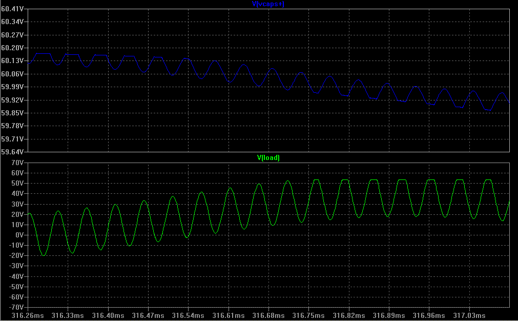

But, that 20V does appear at a simple glance to be what's needed. For the sake of consistency, in comparing like with like, I used and adapted Tom's last posted circuit, for the moment "ditched" his fancy capacitor model because there were some spurious glitches appearing in the sim:

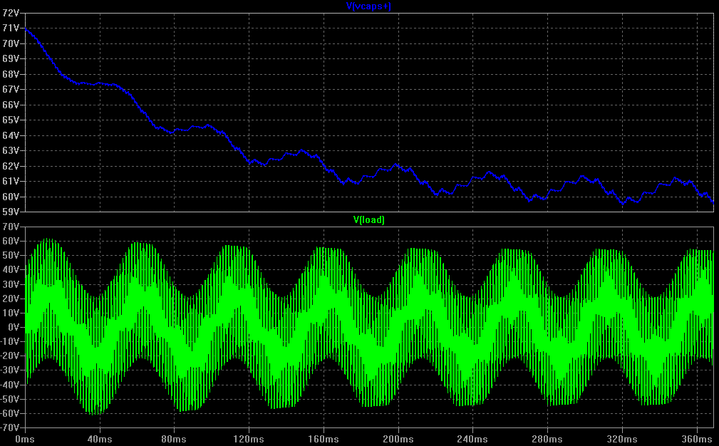

The PS rails with no load, the output stage disconnected, sit at 82V. Then, reconnected and idle current flowing, the rails drop to 71V. Finally, add a rather vicious, constant load of summed 20Hz, 635Hz, and 20,000Hz (635 midway point ...) sine waves which peak just below clipping, and see what happens to the rail:
Sags right down to 59V in less than half a second -- that 20V margin doesn't look that bad after all now ...
And what happens to the output with droopy rails? A nice bit of clipping ...

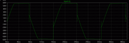

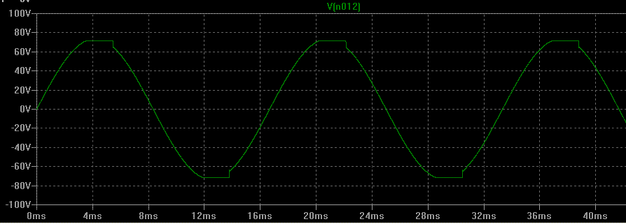

At idle, the output stage dissipates about 13W, 5W in Q3 and Q4, 1.6W in Q1 and Q2. Then, driving with a pure 1kHz tone to just clipping, the voltage sag is stable at 57V. Voltage p-p is just over 100V, and power dissipated in the 4R load is 320W.
Frank
320W into 4r0 is 50.6Vpk (101.2Vpp).
That is a reasonable unclipped maximum from a loaded PSU supplying +-57Vdc, i.e. 6.4Volts of losses through the amplifier. Particularly when the 57Vdc is actually modulated with the PSU ripple (what is the loaded PSU ripple when delivering maximum power?). This leaves the Vsupply minimum ~55V, or really a 4.4Volts loss through the amplifier.
Can you change the transformer data/model to more realistically mimic what a "normal" transformer shows when unloaded/loaded? Maybe Gootee could supply data.

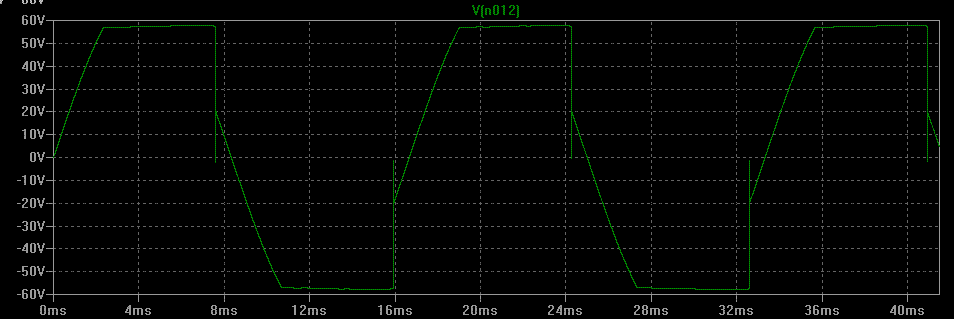

This is where the action is. The transformer, as "supplied", has secondaries looking like this at full power, 320W into 4R:
Nasty looking, eh? But how realistic ...?

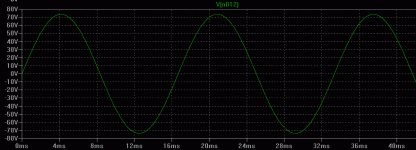

If I back off to idle, things improve somewhat ...

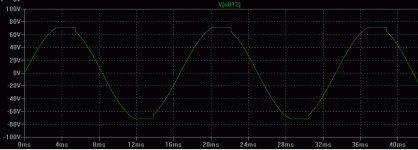

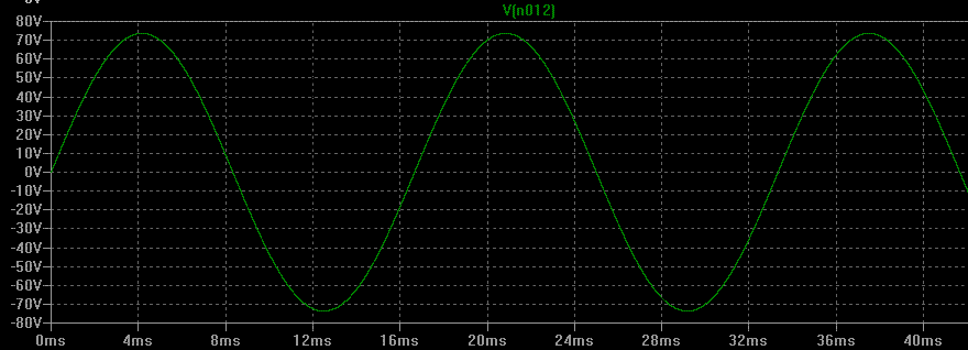

Then, disconnect all load to the rails, and we get the textbook result:
Interesting times ahead ...
Frank
Sorry, ignore that figure of 82V I posted earlier for no load conditions. As Andrew pointed out, there was something awry there, and it turned out to be a combination of me being confused with a result taken under different conditions, earlier on, and not allowing sufficient time for the voltage to settle. A much more accurate value is a touch under 73.4V, so the transformer model is most likely to be of good accuracy ...
However, that doesn't change the main story that significantly, on the need for close to 20V "safety margin": 73.4V no load, 57V for full power, no clipping ...

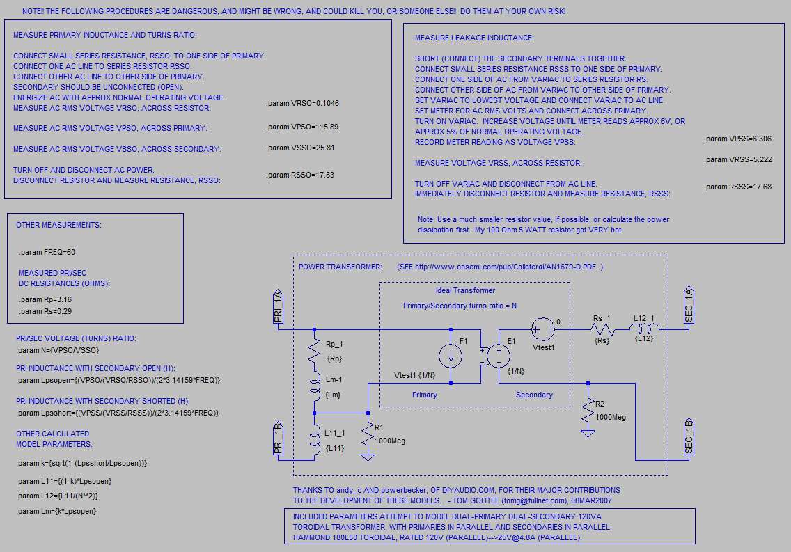

Here is the transformer model.
The only transformer models I have made are for transformers with around 22-30V outputs, since those are the only ones I measured (see measuremnt steps in model image).
So what is being used in the simulations is this model, but with a much higher input voltage amplitude than normal, in order to make the output voltage higher.
I just noticed, too, that the inputs and outputs are labeled. When identical labels are used in spice, those points in the circuit are joined, as if with a wire. So in the simulations so far, the secondaries of the two transformers have been in parallel. I will change that and see if it makes a difference, and will post a new overall model with the correction.
P.S. Frank, I lowered the input voltage to 321 V, to get an unloaded output voltage of roughly 71.136 Volts.
