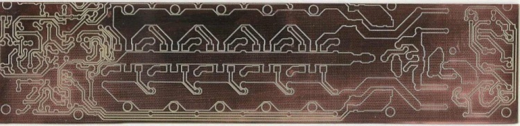

Hi Q, First test at routing your layout on a piece of scrap.
I'm planning on building 4 of these boards (10 fet version) to build into 2 stereo PA amps.
I'll post some pics of the progress.

I intend to drill the holes aswell but at the moment I am limited by the artwork.
The CAM program I use requires outline vector artwork and there are a number of steps to get from Q's PDF to this!
I have not added ground planes to the board, I just create an outline milling profile that isolates the tracks, this leaves behind what look like ground planes but are infact not connected to ground.
