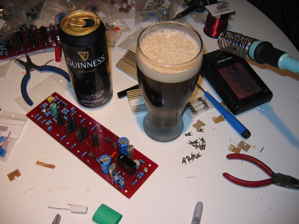

Beers & Boards go so well together...
Another round of PCBs coming together. Toshiba 2SK1530 samples were shipped bulk by BOAT across the Ocean and I will not see them for some time! I looked at some offshore knock-offs today and they were obviously poor quality...I will wait and finish the case(s). The knock-offs were like $4 each, much lower than the 1's and 2's price of the real device which varies from $10~$15 US or CAN funds each.
Shawn.
