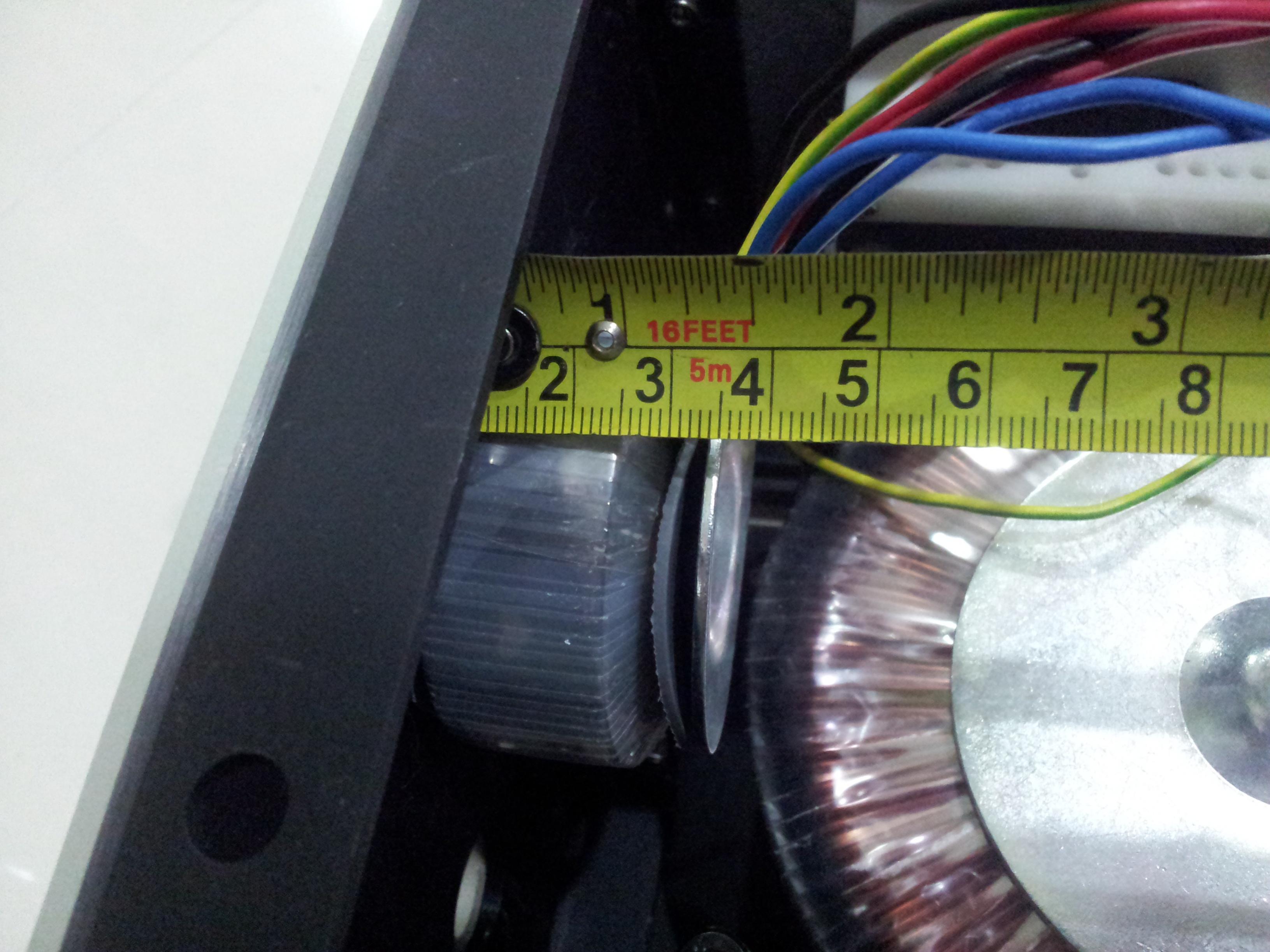

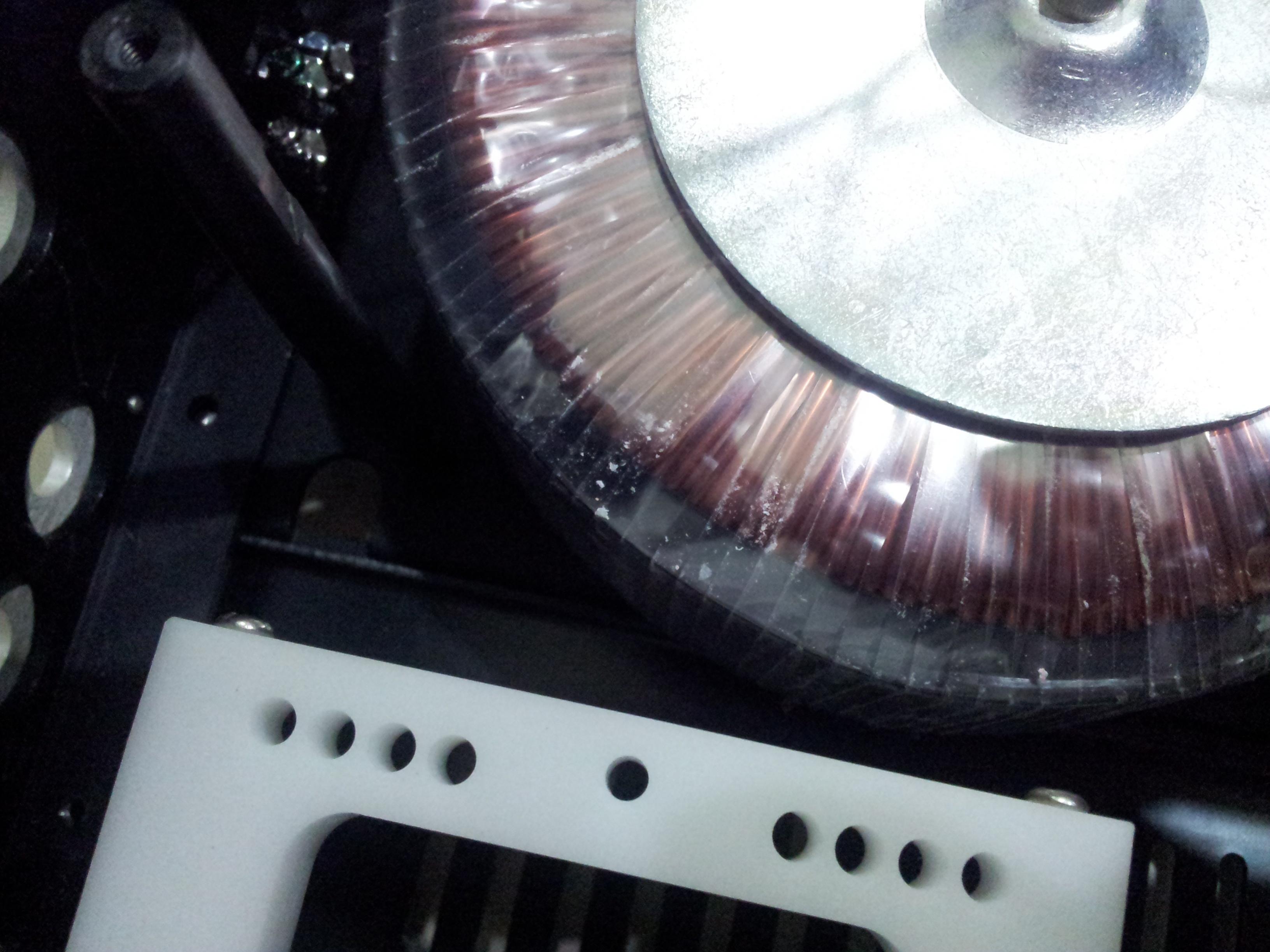

Attached is the photo. The transformer is about 34-35mm including the metal piece and the pvc rings that comes with it. Without those, I guess it is about 28mm according to the specs given by Toroidy, as attached by Heinz.
There are pieces of foams (for protection during shipping) in between the transparent sheets that wrap around the transformers. Is the transparent sheet necessary? Shall I remove it to dislodge the foams?
Thanks.

I would not recommend removing it, at it is part of the transformer, with the end of protecting the enamel coated winding.
Now I am switched on.
The transparent tape is wound around the secondary to keep the electricity in.
And to keep your hands and tools out.
Do not remove that tape !!!
The little balls are expanded polystyrene. Often used for packaging and transport protection.
If you can carefully prise them out with a toothpick, then go ahead.
They are very squidgy (soft). Bolting up the transformer using the kits parts will squash those balls to insignificant thickness.

PM Choong,
Your (our) problem of the AUX Transformer comes from the fact the the transformer is not potted with epoxy in the centre, with a mounting hole drilled.
This then requires the steel washer and the rubber gasket which adds to the thickness and creates the volume conflict.
In our original prototype, we used a transformer that is potted, so we had sufficient clearance.
Give me a couple of days to see whether I can find a solution for you for the least trouble.
e.g. potting the centre with epoxy putty is a simple way out.
Patrick
Patrick
A dished washer plate will help. But still leaves the compressed thickness of the rubber protector washer and the plate............Give me a couple of days to see whether I can find a solution for you for the least trouble.
Be careful with a homemade epoxy fill. The Mylar tape will resist adhesion to most glues. The fill must also use the mechanical lock of the non parallel sides of the "hole" to give a reliable grip.
I had a look at my own examples of the AUX Tx from Toroidy.
The centre hole is about 13~16mm.
A couple of quick solutions :
1) Use a 2-part epoxy compound and pot the centre hole yourself. When dried, drill a hole 5.5mm, and use a nut at the other end. There is no need to pot full hieght.
2) Use a rubber Well Nut of the correct outside diameter at the free end, and the M5 mounting screw to expand the rubber nut to grip the Tx. See :
Rubber well nuts M5, M6 and M8
The high end solution would be a machined flanged plug from Delrin with a threaded hole sized to the Tx. Probably also the most expensive (5~10 Euros a piece). But if one of you has a lathe, it is very easy to DIY. Wood will also do.
I personally would try the rubber nut first.
Patrick

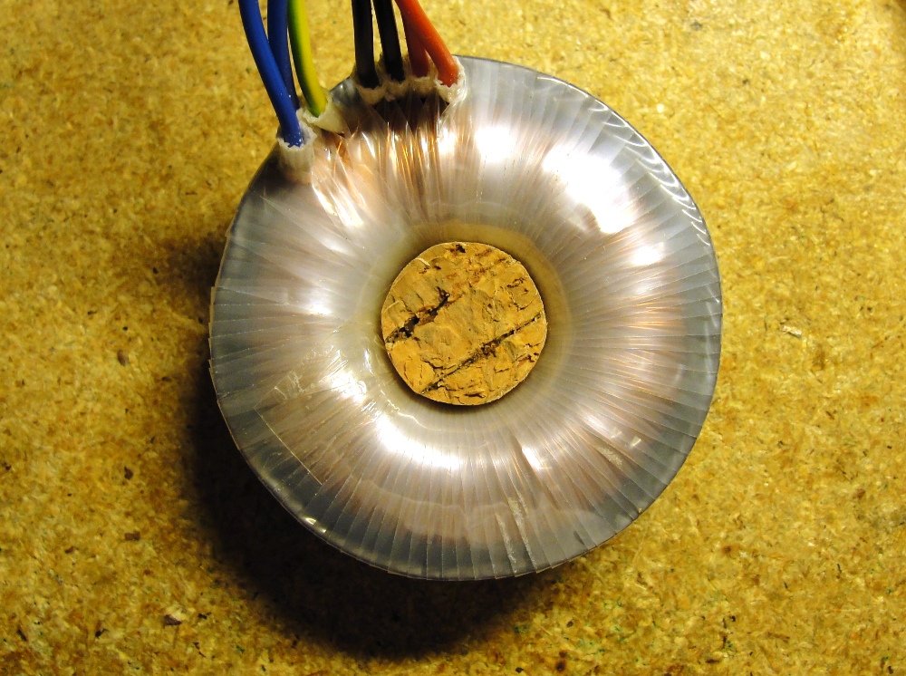

I tried something even simpler tonight. A sherry bottle cork will fit perfect.
You then need to drill a small hole (say 1.5mm), and use a wood screw to secure this in place at the rear bracket.
Do not over-tighten.
Patrick
Patrick
