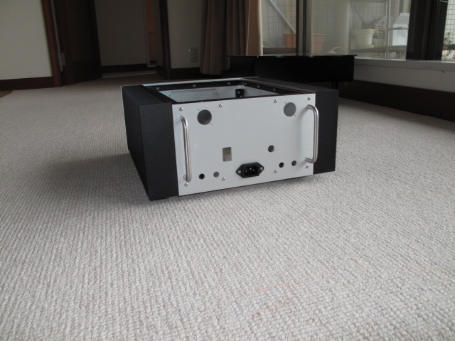

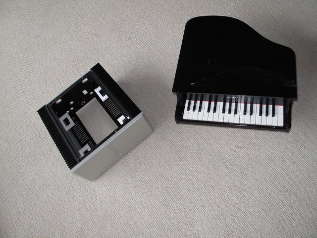

Nice appartment you have.
Could you send me a copy of the piano photo in fully resolution.
We want to place it in our gallery some time later.
There must be others who have now get the case and the heatsinks ?
No one putting them together yet ?
Can't wait to see you build photos.
I have asked fitzfish to put up his build thread asap.
I have seen the first draft and made comments.
Patrick

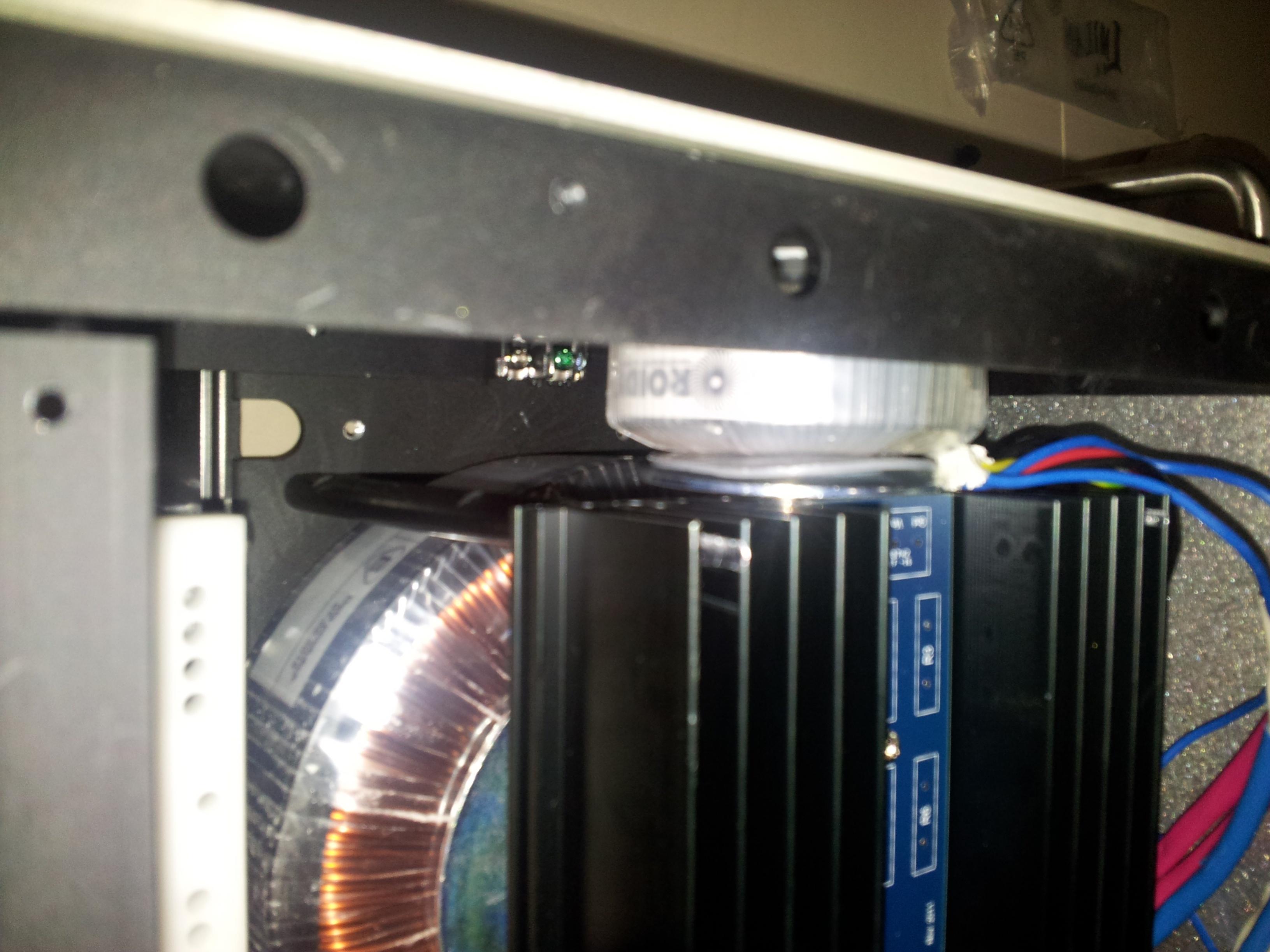

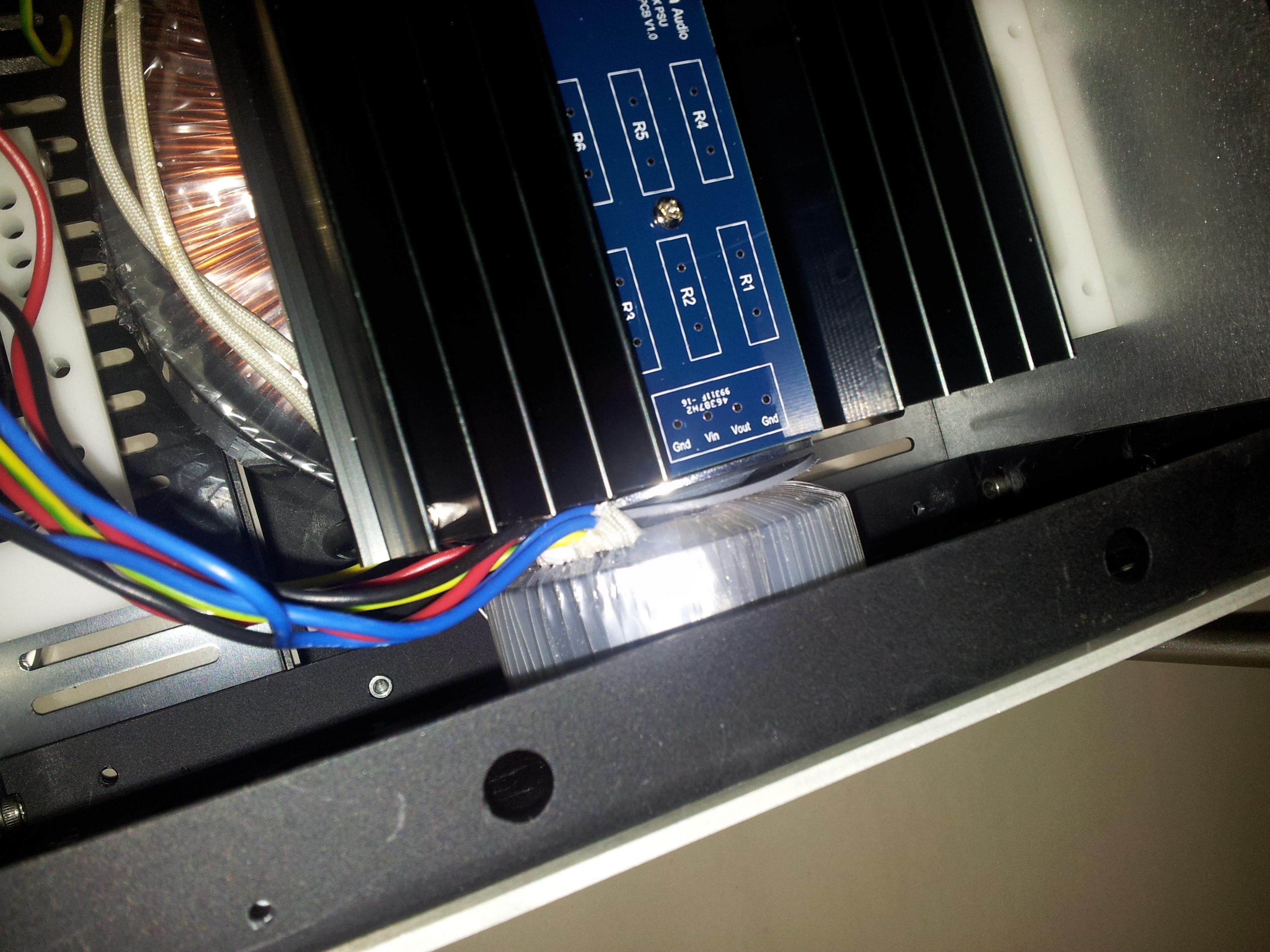

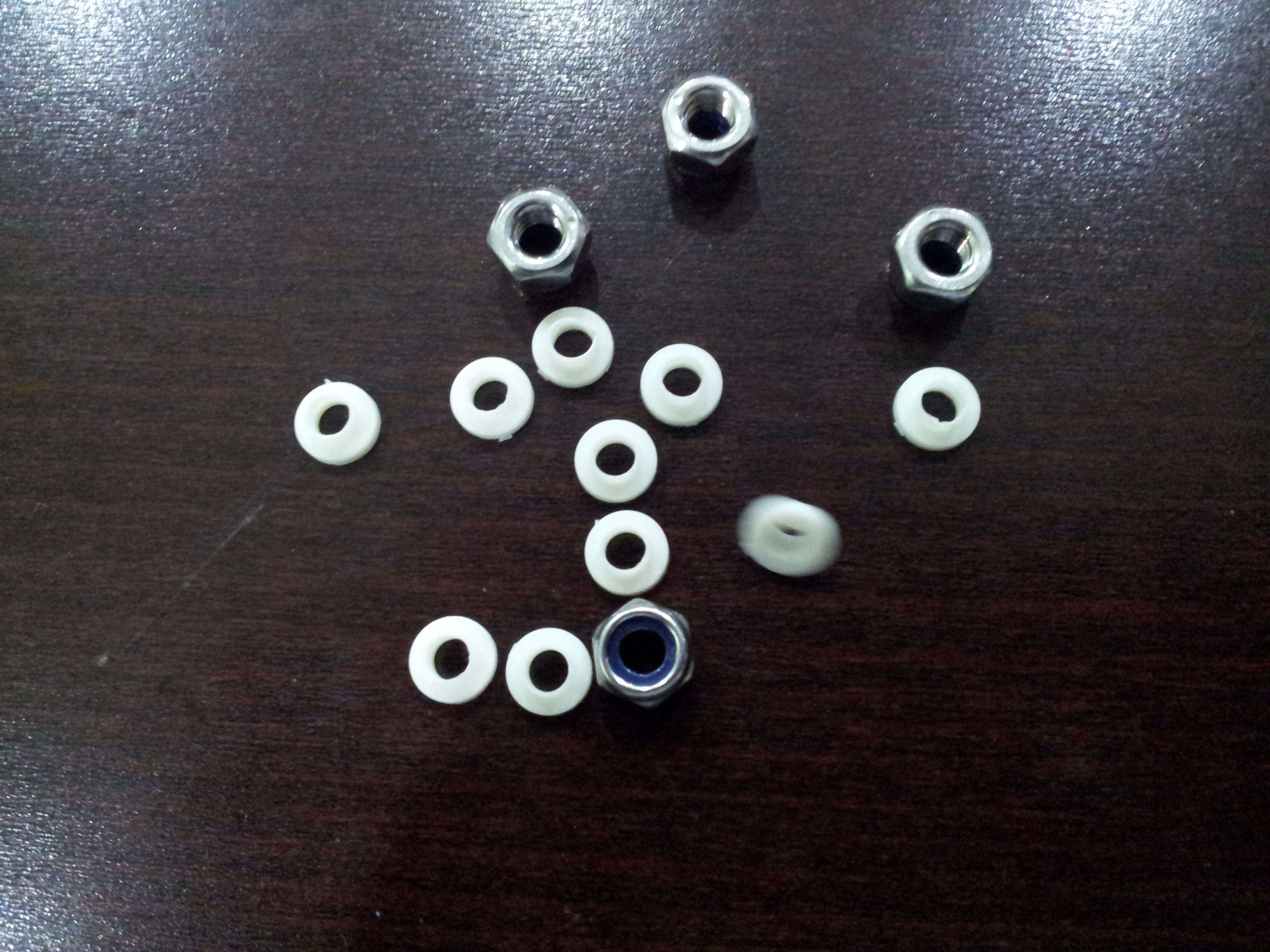

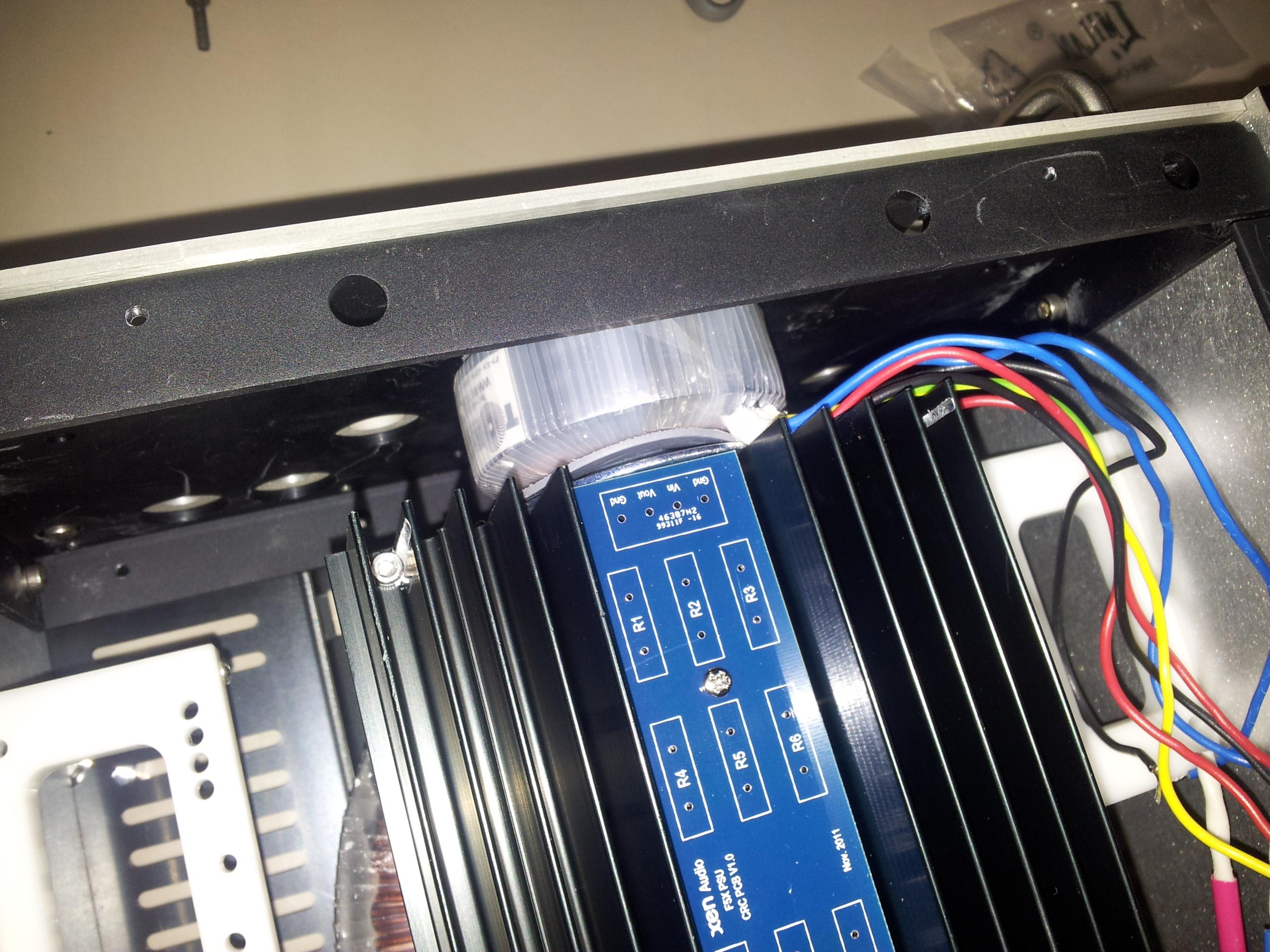

pmchoong,
There should have 35-36mm clearance for the aux. t'former between the reg. heatsink and the inside of the back bracket.
What is the "height" of your t'former?
The white "washer" is used to isolate the rectifiers from the heatsink if required.
The M4 nuts are for the mounting of the loudspeaker protection relays etc.
Mark
Mark
