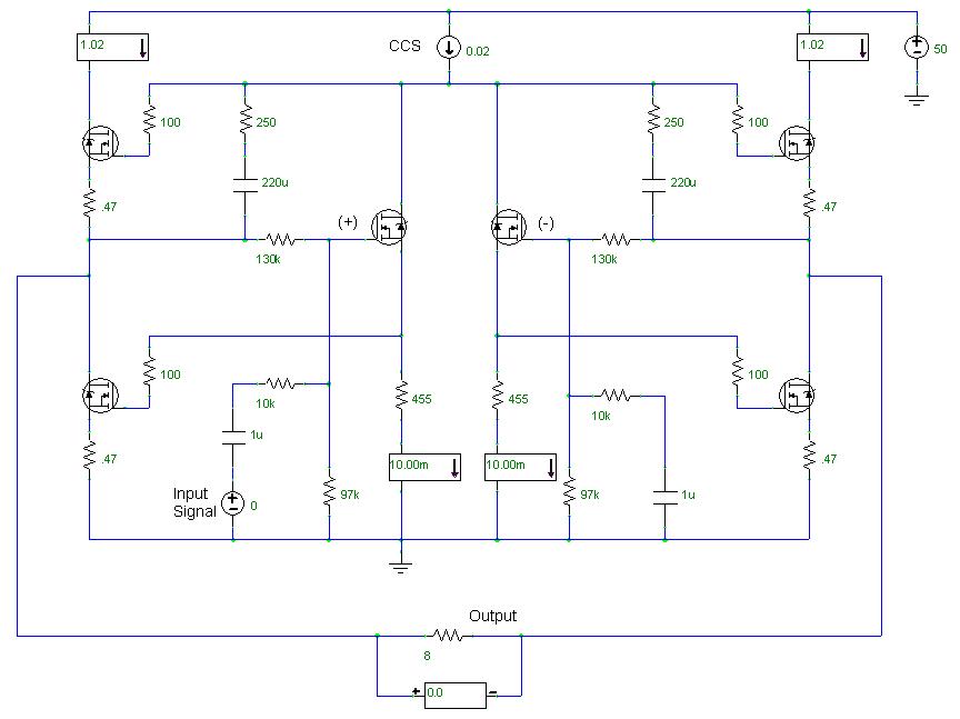

Try Again...
Here's my first try at a Balanced PLH. Something is incorrect. I'll look at it again over lunch.
Just for starters, each side uses 1A bias current at 50V, for a total dissipation of 100W. The power transistors are IRFP type, such as the IRFP044. The signal transistors are IRFD120/123, but the selection is mostly arbitrary. They are biased at 10mA each by a CCS running at 20mA (also an IRFD). I removed the discrete CCS and replaced it with an ideal source to make the schematic simpler.
The (-) input of the balanced pair connects to ground through the 10k feedback resistor and coupling capacitor. The (+) side is connected to an input signal.
