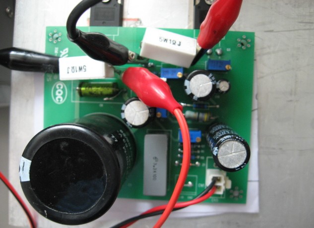

I am builting PLH just now,but it work unsuccessful.
can anybody help me?

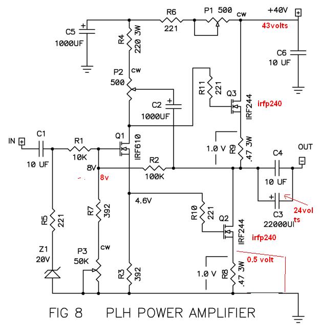

A:
R6(221) means 221 Ohm or 220 Ohm?
R4(220) means 22 Ohm or 220 Ohm?
I consider R4(220) 22 Ohm
B:my vcc is 25V
but the voltage of the midpoint(left point of C4) is above to 17V,
THX!

http://6moons.com/industryfeatures/zen/plh.pdf with 2 irf240 but they burned..and then i used 2irfp240because they are cheap..but i cant see 2amps bias through 0.47ohm resistors..there is 0.35volts maximum at this resistors..i am doing everything but nothing changes..output voltage is25volts dc now.gate to ground voltage is4.6volts and irf610 gate 8volts .power supply is strong enough toroidal transformer is 500watts.it produces 43volts dc..and i used total 38000uf capacitors..what can i do?

umut1001 said:i am doing everything but the bias is only 1.4 amps now
decrease R6
