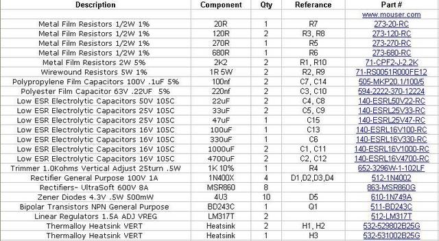

Changed one of the heatsinks to 1" tall to allow placement for the lower circuits in the PS1.

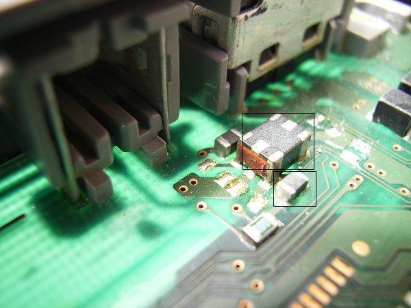

I'm doing the MARK mod replacing the output stage altogether with 3.3uF caps. I completed the process exactly as described, except I accidently popped off the two SMD devices (smaller is a cap measuring .343uF) shown in the attached photo. I also only removed the first two caps of the output stage for placement of the new 3.3uF output caps on pin 15 and 16 (the other 4 caps are still there, the instructions were unclear about their removal). I turned her on and there is a loud hum and the disc spins initially and the startup message is audible behind the hum, then the disc stops spinning and refuses to play.
1. Are the two caps I popped off indicated in the attached drawings possibly the culprit here or are they suppose to be out of the circuit altogether in this mod?

Hi
Its the one at the back that Mike says
needs to go.However before throwing those
two away you have removed you might measure them
if you have a Cap meter just in case you have
to source them either as surface mounts or
more regular caps. You may have to sit with the schematic
and see where they go and if they have any effect.
Others may advise you as I do not have an open
PS1 really handy.

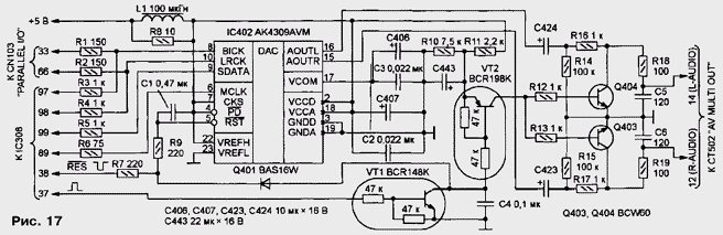

Ps. certainly take out the one at the back that Mike_F
advises. Diagram supplied ma help.

The larger cap has 3 x 15uF (measured at 14uF) and the smaller one is a 333nF unit. None show polarity, so they are film, right? I don't see any of these values on the schematic. I disassembled to check my work and found that the front connectors for the joysticks has a ribbon cable I had failed to install. I also removed the next row of caps (that feed the AV output per Mark's schematic). Now I get no response at all on power up, I'll take off the last row of caps and see what happens...

After some poking around, found that the center cap on the larger 3x (14uF) connected the rca negative to ground and was necessary. The others traced back to the bank of capacitors, all of which I ended up removing, so they were out of circuit. All is well now. I don't think I'm ever going to bother with any mods that involve SMDs again...
