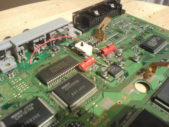

Playstation as CD-player
Top side of board showing 4.7uF 50v Black Gate 'N' Non-Polar caps:

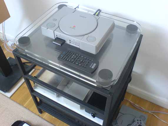

Finished and playing beautifully! Now of course it will probably take the rest of my life for those Black gate caps to break in ;)
Note the model 9002 Playstation on bottom right looking VERY sorry for itself!
Note the PS2 remote - got this on Ebay for £4!!! Works a treat.
