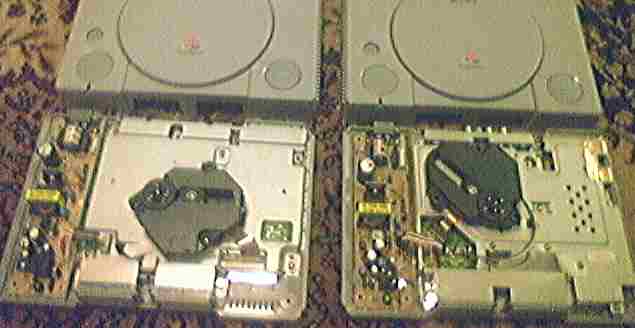

Hi
Today in West OZ, Playstations were on sale for AUD$20
So I went and tried to get another SCPH1002 but
ended up with a SCPH5502 or so it said on
the bottom! It was shrink wrapped and with a
3 month warranty. The others I have
purchased were packed the same way but were SCPH1002s
Well inside it looks like a later model and also
claimed to need just 9 watts rather than 12 watts
to power it! Question is is it still a true 5502
despite the differing features(Ie moving the laser
transport over to the right away from the power
supply heat or have I been deceived? The buttons
had symbols rather than text on them so could it
be a hybrid repair job?? Does it still have the
separate oscillator of 67.7376MHz like the 1002s??
Picture is of this suspect called 5502 on the left and
a genuine 1002 on the right. The 1002 have five screws
and this 5502 had six screws to take of the top cover.
I always throught the 5502 was just a 1002 without the
RCA outs! Was I wrong?
Regards
AnthonyPT
Yes you were. The PS on the left may well be a 5*** and the description in your text fits also. All PS but the 100x have the laser on the right and symbols on the buttons.
Mick
Hi Mick,
Thanks for clearing this up.
So the 5502 removed the RCAs and fixed the
overheating for the power supply. So to be clear;
does the 5502 still have the separate oscillator
of 67.7376MHz like the 1002s thus giving it the low
jitter magic that is the 1002??
Regards
AnthonyPT
Regards
AnthonyPT
Not so sure...
I bought a Japanese SCPH-7000 at my local game store, and they use letters instead of symbols. Also, the PCB and shield are lower (There's much more shielding too) and the transport has higher pins under the rubber mounts.)
It uses a separate DAC also. The only problem being that select button is a visualization mode instead of stop.
Looks like 5502 except the transformer is grey instead of yellow. (And the !#?@$ wire plug isn't exactly the same, since they use 100v, but they have the same wall plugs and the problem is that I just didn't buy the wire, so I use a DIY wire using alligator plugs)

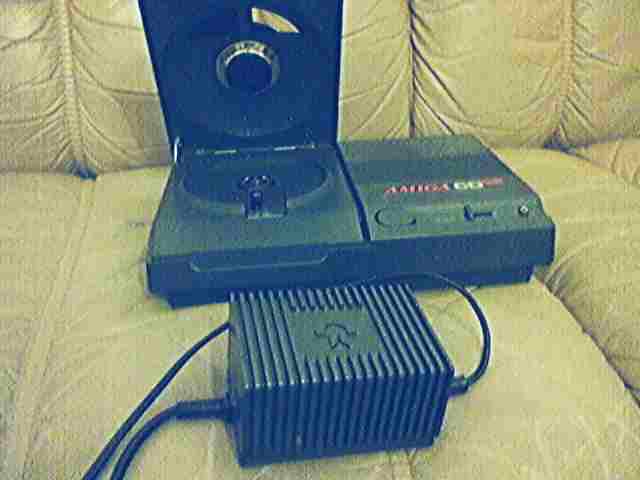

Hi
After these helpful revelations about the SCH5502
still having the 67.7376MHz like the 1002s (True?)
I became interested in looking inside my
trusty old CD32 CBM box that predates the
release of the Playstation my at least a year
or two. I took it down to the Motherboard
and looked at the components and the build quality.
It was hard to get off the shielding and not as easy
to work on compared to the Sony hardware. The CD32
CD display metaphor is so much more creative than
the Sony one. Also the Power supply is not SMPS
but more traditional. You have 12v @ 500ma plus
5v @ 2.2 amps. Total around 17watts. Now I wonder
if the PS1 at 9 watts (5502)and SCPH1002 at 12watts
could work with the CD32 power block using
LM317 plus LM350 regulators or would we need more power
for the 7.6volt supply? Its a neat 4 Din pin
based block far away from the player. The Regulators
and extra caps could live in the PS1 box and cool
running would prevail? -))
Since CD32s are not flavour of the decade maybe
two CD32 power packs giving you 4.4amps at 5v and
1amp at 12v.
I enclose a picture of a CD32 and power block
for reference.
Regards
AnthonyPT
PS. The Playstation WIKI has a list (it looks like) all Playstaion
models regardless of their distribution areas.
