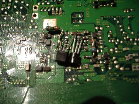

And here`s the bottom side:
Personally I prefer this solution to the others I`ve tried. The sound is less dependent on the PSX following preamp.
Jürgen
