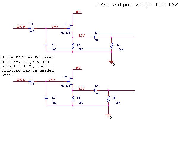

So far I`ve modified my PSX by shorting the coupling caps of the AV output and feeding it directly into an AC coupled preamp. Although I enjoy the sound of this solution there are two major drawbacks:
DC output bias causing “pops” and fairly high output impedance due to direct feed of DAC outputs to the preamp.
To overcome these, I decided to use below shown JFET source follower stage between the DAC`s outputs and the muting circuit. I have used the RCA outputs and kept the muting circuit, but removed the “strange little thing” (which is a common mode choke from MURATA) and also the SMD ferrite beads. Apart from the cap at the output of the muting circuit I have removed all other caps connected between the signal and ground in order to avoid further high frequency attenuation.
This “buffer – solution” leaves me with only one coupling cap per channel as I can use the DAC`s DC level for biasing the JFETs. The JFETs provide a high impedance seen by the DAC which is favourable. thus the DAC and the output are nicely decoupled.
You can of course use other JFETs than 2SK170, but you may need to adjust the circuit slightly.
Listening tests are ongoing so I´ll keep you informed.

Hi Mick,
it will be quite exiting for me too. I have already done this kind of modifikation on a Pioneer DVD player (DV-343) and the result is very good, indeed better than my so far playstation. Now it will be fun to see if the playstation can pass my favorite again.
By the way: I took my idea from the decware web-site where Mr. Decker is modifying a DV-343 with a tube cathode follower stage. For me the tube stuff was to much effort, so I decided to go for the JFET.

Just a side note, which may be interesting for those of you, who suffer from the low output voltage of the PS1:
The NJM2100 opamp is used with unity gain in the stock form, but it can be used with higher gain. Replacing the feedback R from 18k to 27k will increase the output signal voltage by about 50%. E.g. at 1 kHz there is an increase from 1.1V to 1.6V. The signal is still undistorted and there is no clipping.

Hi gents,
yesterday evening I finished implementing the JFET output stage in my PSX. In contrary to my drawing I have used 3u3 output caps (MKT type) because space is very limited and I tried to keep the circuit as small as possible.
Before closing the case I did some measurements. Gate-Source voltage is 0.1V which seems a bit low for me. Maybe it would be better to use source resistors of approx. 1.5k.
Anyhow I left the resistors, screwed everything together and started listening. First impression was an increase in detail and space, I enjoyed the sound and soon forgot about testing.
So I will have to do more A/B comparison with my other PSX using the AV connector (direct DAC output).
My preamp is a Pass P clone, the poweramp an Aleph 0s clone. I am using Canton speakers (Ergo RCS) togethter with a Linkwitz dipole sub crossed over at 50Hz. My listening room has 35 squaremeters.
More listening experience and pics of the mods soon.
Jürgen
