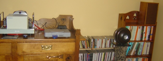

Well I was going to post some pics to the speaker forum, but I have built a neat second system based around the Playstation (Mick_F edition) as the front end. standard Sonic T amp and a pair of speakers I made from tangband drivers (871's) and some wooden vases. A truly diyaudio inspired second system. the other kit looks on in disgust :)
I guess a truly underground system would have a modded T-amp and Cyburg Needle speakers, but my carpentry is not up to them (yet !)

phn said:
That Radford (?) tube amp isn't too shabby either.:D
well spotted. He does look like he's wearing the T-amp as a party hat doesn't he ? Mistress LS3/5a is not amused.
I remember the L75 - I think my parents neighbour had one. One of the few TT's with 78 RPM support too as I recall. very well built. We were a Thorens houshold - the TD150 would also be a nice choice. Sorry for the rathole.
My intended point was that a PSone makes a great source for a budget system far cheaper than any magazine "best buy"
