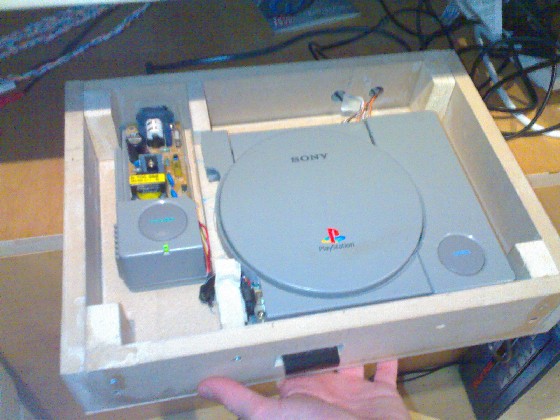

Research Paid Off
Hi all,
New to posting here, but i have been reading this post avidly for the last few weeks.
After some lengthy research across the internet world i finally decided to commence my own construction.
I folllowed the instructions from:
which are very good.
I used a SCPH-100*. fitted the extra circuitry featured on the site and used new gold phonos from maplins.
I replaced the original laser with one from a PSone and adjusted to avoid skipping. though not to the values on the site.! The power supply is from a SCPH-550*. Though to fit this i had to 'bodge' the 7 pin cable into a 5 pin cable. Seems fine, just conencted the ground to another and didnt connect the reset (as the button is unused).
Then decided to fit the whole thing into an MDF box, using the original lid mechanism. Cut some air holes for the power supply and sprayed the lid black with car bumper paint. Fixed some cherry wood to the sides to match my speakers (MS 902's decleration) and varnished it.
I also have incorperated the PS2 remote which works fine. Hopefully going to invest in an SONY RM-AX4000 touch screen remote, which should replace this (if it works).
I used half squash balls for the four feet which have been superglued on.
Only part unfinished to date are the buttons, i am looking for some 40mm black rubber grommets to cover the buttons below in the rough cut aluminium polished sheet.
The quality of the player is very good and is a lot lot lot better than my cheapo dvd player. I can hear a difference but think it is on par with my friends £500 marantz universal player. I am extremely pleased with it and in total probably cost me the best part of fifty quid. (i did have to buy 5 psx's, components, soldering tips and timber though!!).
Basic pictures below, more can be posted on request and extra details if anyone is interested as this is just a brief overview!!.
Thanks for listening, i highly recommend this as a cheap fun conversion with exciting rewards.
Tim.
