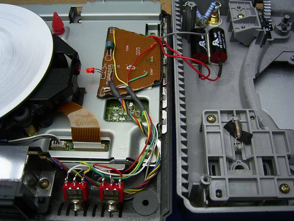

I thought I would go against the grain and say my PS of choice is the 5552, just remove two 10uf caps and wire direct to the pads joined to pins 15 and 16 (you will of course need to fit your own rca's).
It sounds the same (to me), as the 1002 but has more room inside the case for your Caps of choice,(You can fit fairly big poly's in the lid).
The ones in the picture are only 1.5uf but I have also used 4.7uf in previous trials. The 1.5uf caps are used with 100k grounding resistors to give me what I think is the best bass.
I have also fitted the controller inside (well it's guts), to give on-board control of, play/pause..stop..skip and previous via two toggle switches. The red led came with the cheap controller and I have since changed it to blue, (looks better if nothing else).
I am really enjoying this new cheap hobby, (the 5552's are only costing a few quid each).
Thanks to anyone for pointing me in the right direction, Barry..

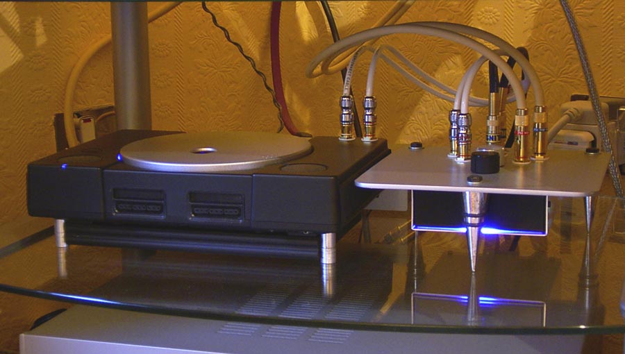

audio1st said:Here is a picture of the outside before fitting the switches...
Nice! and the caps were probably twice what you paid for the PS1!
So you jumped out from the DAC as per Mick's mod but straight to the RCA's?
How about combining the two? your T and the PS1?
I've already had a go and it fit's in the case!! I'm even looking at a common power supply.......
By the way...nice wallpaper!
