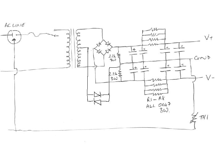

AndrewT: perhaps I wasn't clear... the single transformer option would be a commercial offering - one secondary with center tap giving 18-0-18. (The secondary is rated at 10A, so the whole thing is about 360VA, if I understand correctly.) The idea would be to use this in the schematic I posted above in post #17 to power both channels. Do you think this would be good? How would it compare to the original FirstWatt design?
Although I suppose I *could* see if I can get price for having one specially wound.... maybe I am being too pessimistic about how much it would cost... What benefits would there be to powering the two channels separately?
I like your idea about doubling the VA rating if not too expensive - it appeals to my instincts to make everything bigger and stronger than necessary to have a nice safety margin.

njepitt said:
So what about the attached circuit ... ?
... but how would it's performance compare with the original, or anything else you would recommend?
I would attach diodes between the centre tap and GND, as shown, in case that there is unequal secondary voltages. Or, I will go with each bridge at each secondary.

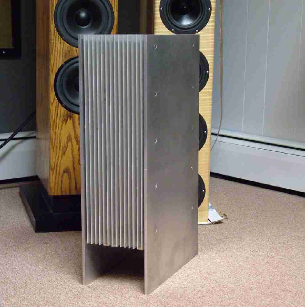

Jupiterjune: Looks good! I like the way the sides extend below the heatsinks to make a stand. Might copy that idea on mine... (hmmm...) The heatsinks look a lot taller than mine, though... (I presume there is another one on the other side?) How large are they?
Babowana: I don't understand what the diodes are supposed to do. If you use two diodes end-to-end like that don't you just let current pass in either direction? How is that different from just a wire? (Did I misunderstand something?) You also suggest using two rectifier bridges, but this seems to be contrary to advice AndrewT gave above... (which I thought I had understood, but maybe not...)

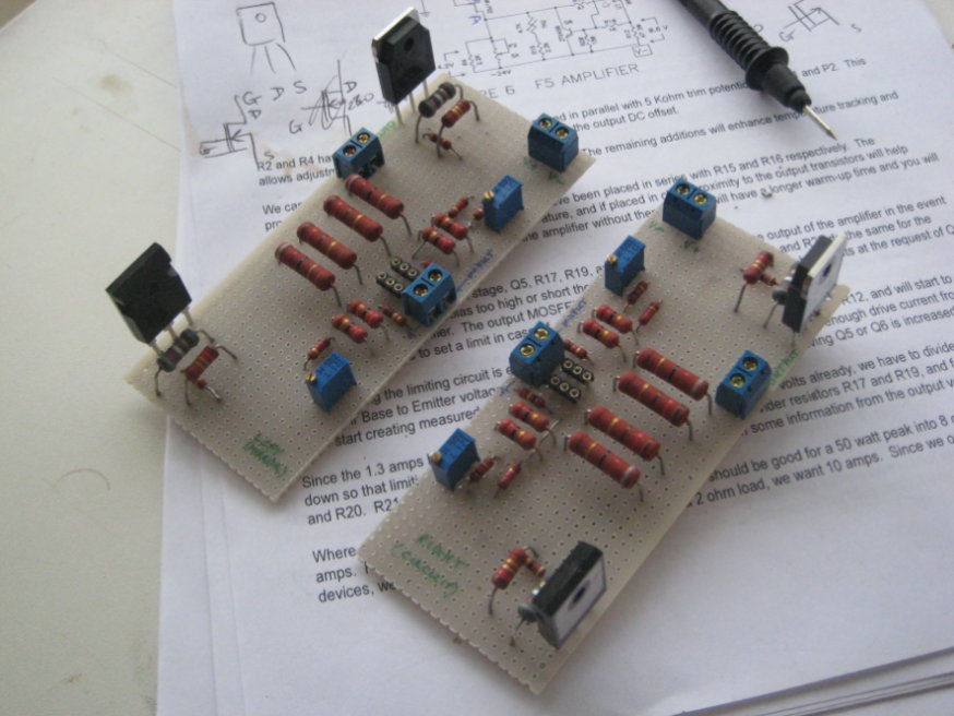

I've just spent a very enjoyable afternoon soldering up the amp boards. (These were partially done already...) The main amp circuit is now done (although still to be checked again), the protection circuitry and the thermistors are still to be donem naybe tomorrow night , family commitments permitting. Here is a photo of the boards, for those who are interested.
The diode has a barrier voltage of about 0.6V-0.7V. Therefore, the two diodes (post #23) provide the barrier voltages of about 0.6V in either direction. But, there is no such barrier voltage in a wire.
When the secondary is centre-tapped, we have a possibility to have unequal votage dividing. In this case, if the voltage difference between the upper and lower secondary is within 0.6V, the diodes will help in avoiding the disadvantages coming from the voltage difference.
You know? Papa always says that the devil is in detail . . .
By the way, I like your board-look . . .
Babowana: I have just spent about an hour looking things up on the internet to try to understand your answer - I'm not sure I have it all yet, but it is clear what my basic misunderstanding was. On the wikipedia page for diodes there is a graph which shows the current flowing through a diode as a function of the voltage applied. By "barrier voltage" I now understand that in the forward direction (where the diode is *supposed* to let current flow) current actually does *not* flow (at least, only very slightly) until the voltage is greater than about 0.6V, as you say, at which point it flows just fine. So the pair of diodes acts more like a switch - that is, over 0.6V it is (almost) like a wire, but below 0.6V it is (almost) like a *cut* wire. Which is what I had failed to understand - if the two halves of the secondary produce 17.9VAC and 18.1VAC, say, the total across the rectifier is still 36VAC, as before, but the diodes allow 0.2VAC to sit as AC potential across them, balancing the two halves with respect to earth.
How's that?
The part I am not sure I understand yet is what becomes the reference to earth...
In the example above, if I tie the centertap directly to earth then clearly it is at 0 VAC with one end of the secondary at 18.1VAC and the other at 17.9 VAC. If I use the diodes then what gives the reference? One end of the diode pair is at 0VAC, clearly, but what fixes the AC potential of the centertap? I guess ideally this would be at 0.2VAC, with the ends of the secondary symmetric at 18VAC, but why should it not be 0.1VAC, or 0.3VAC, say? (Of course, it won't be more than 0.6...) Does some later part of the circuit fix this? How?

OK, I´m afraid that just begs for another question... and shows what perhaps is the same misunderstanding on my part.... what *would* be the purpose of an inductor where Babowana has the diodes?
Come to that, what would happen in this circuit if the centertap was simply ignored? (I presume something would break on the DC side, but what?)
Sorry, I should have searched for the answer to the inductor question. I have spent a little time reading and will have another go later. One thing that does appear clear, if I understand correctly, is that I would be better off with two secondaries (and hence two bridges) than with one secondary with center tap. I'll see if I can get a quote for having a transformer with twin secondaries wound specially - alternatively, two such transformers, one for each channel..... Maybe it won't be prohibitively expensive...

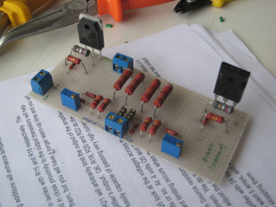

njepitt said:And lastly, a clearer photo of one of them... All comments and criticisms very welcome...
Nice job!

Very neat P to P layout. Mine looks like a cat threw up.
Yes, those heat sinks are a bit longer than yours. My F5 uses the same style of heatsink, 5 3/4" wide, but only 10" long -- and mounted horizontally. Yours should be fine, especially if mounted vertically which greatly improves the heat transfer.

JJ: Out of interest, if the nice-looking tower isn't the F5, what is it? Will definitely mount my heatsinks vertically.
