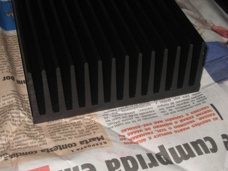

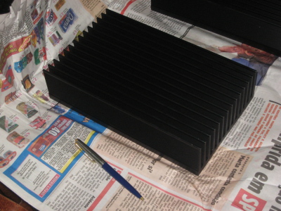

I am pretty happy right now, since the heatsinks have just arrived and they look terrific. (Prompt service and nice finish from a company called Franab, if anyone in Brazil is interested). I'll try to see if I can post a couple of photos, and I'd be most grateful for opinions on question 1 above.

I have attached (I hope) a photo of one of the heatsinks. (Pen included for scale...)

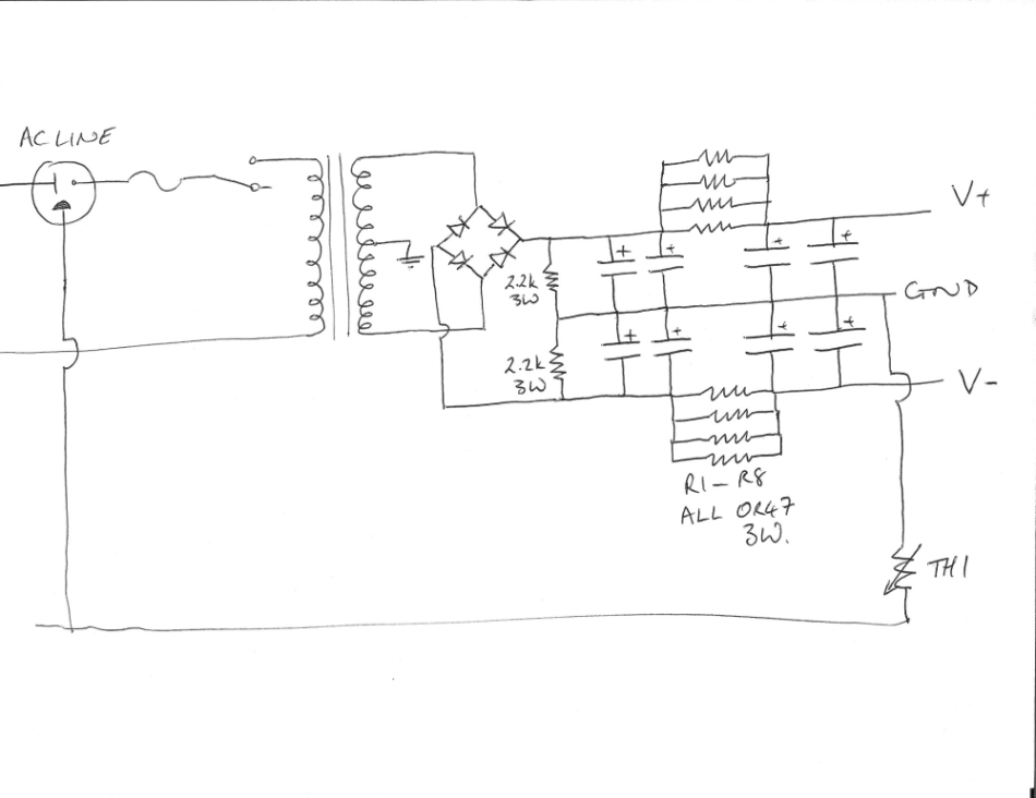

Andrew: I don't understand everything in your post yet, but will try to find out what "bi-fillar" means later. Meanwhile, from your last paragraph I understand that two rectifiers on a center-tapped trafo is a bad idea . So what about the attached circuit, adapted from the original F4/F5 schematic to use a centertap? I am pretty sure it would work, but how would it's performance compare with the original, or anything else you would recommend?
(And in parentheses, on the FirstWatt site NP recommends using capacitors across the rectifier diodes to help with noise, but what ype and value would be appropriate? On a previous PSU for another project I used 0.01 microF ceramics... opinions?)

So the new idea (as of this morning) was to use these in two parallel pairs, each pair subsituting for one of the secondaries in the original schematic.
You have 4 bridges, and apparently by your schematic, 4 caps for the PS. This is enough parts to build a separate PS for each channel. So ---- you could use 2 trafos for each channel, and avoid having to wire the secondaries from different trafos in parallel. (since Andrew suggests this would be bad with EI trafos -- I did it with toro's and it worked well).
The current limit on the trafos is going to be due to the core size and the current handling capability of the wire. Too much amperage through the trafo and they will buzz and get hot, possibly melting the insulation.

BTW--I built a tower style amp with heatsinks a bit smaller than yours, and it worked fine. You should get plenty of cooling for an F5 with those.
Joined 2008
Jupiterjune: thanks for the observation about the heatsinks. Just what I was hoping to hear from someone! Do you have any photos of your amp? Since the amp boards are partially built maybe I'll concentrate on those while I plan out the PSU. I have a +/- 20V PSU that I use with the Hiraga Le Classe A. This is 20W class A, so the PSU should be sturdy enough to try the F5 out, at least, even if (as people explained in the long F5 thread) it isn't ideal for long-term use.
The caps aren't actually bought, as such, but I have a small collection of large caps that I was hoping to use here. The real issue with separate PSU's for each channel would be that I was planning to put the PSU and amp in separate cases. This isn't an absolute show-stopper, of course, but it would require a bit of a rethink... (February in Brasilia means low, warm sun in the early evening, so I think a cold beer at the local bar, in the shade, pen and paper in hand may be the plan for the next hour or so...)
I am also wondering if the best plan mightn't be to buy the big trafo I mentioned earlier, even if it is a bit pricy, and use the schematic I posted above. (Did I get it right? Would it be as good as using dual secondaries?). I could then save these four old trafos for some other project. The real issue (as I mentioned above) is that the 6,3V secondary appears to be a lower current rating than the larger one. Can anyone with valve-amp/old trafo experience shed any light? If I only use the 12V secondaries that should give me a nice +/- 15 or 16 VDC PSU. Anyone have a good diy project that would use such a thing?
