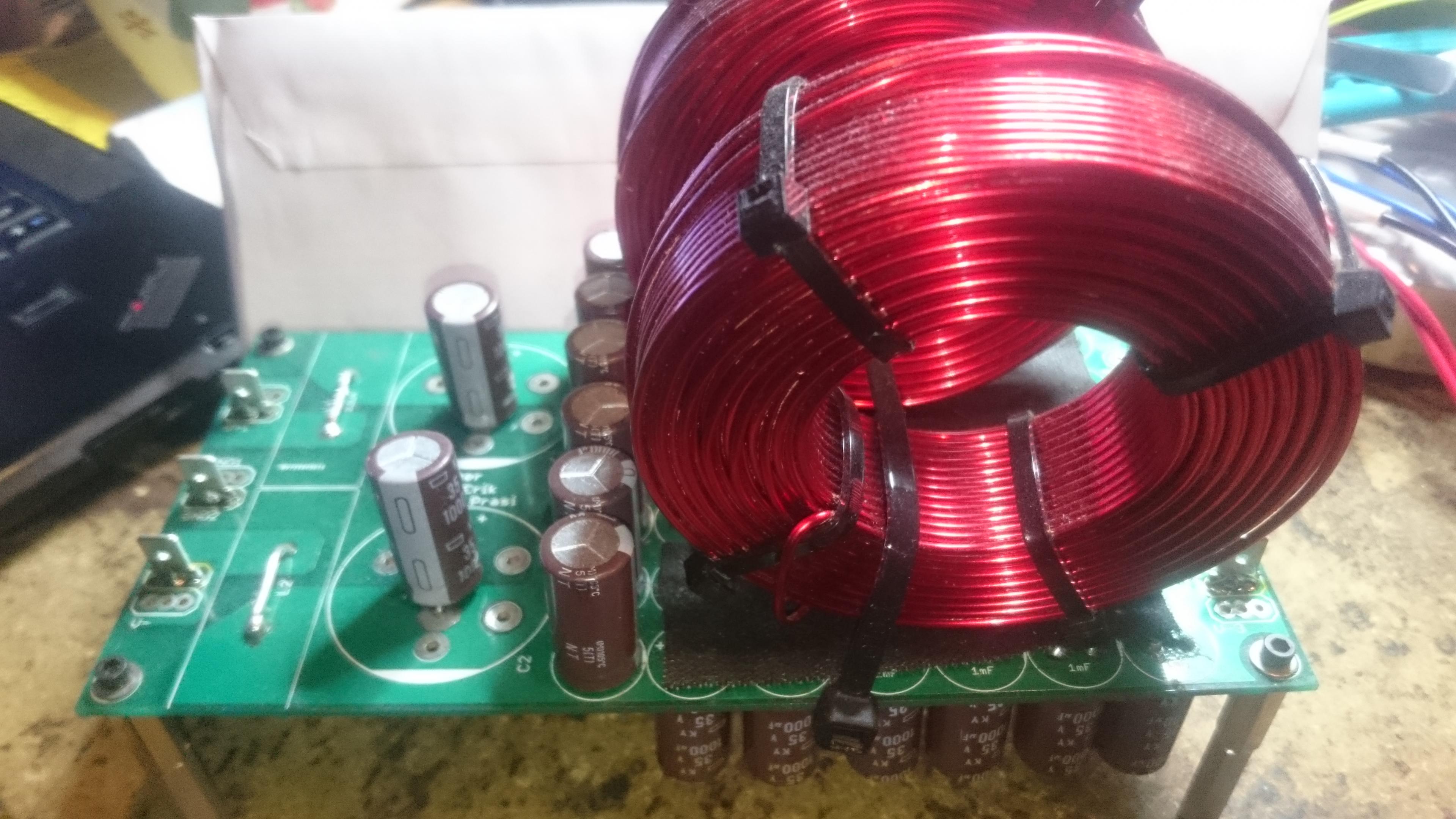

My 50/50 CLC for the op stage on my class A.
Discovered a saturation issue because of the high current when using the sledgehammer. Hence I went with a air coil only inductor. Still gets a little hot, but not
melting hot as when i first tried the 18 guage. Pictured is 14 AWG....

Great, thanks. You answered almost everything that I have been pondering for weeks now. Do you think a 2.7mH 0.46 ohm is too small? I will use two 70 000uf caps on each side of my CLC, fours caps total in stereo. Maybe there is a way to shield them from each other? I heard computer hardrives has a metal that shield magnetism.

I'm curious. What value sledgehammer did you use and how did you determine it was saturating. Also what size (caps etc.) is your power supply?

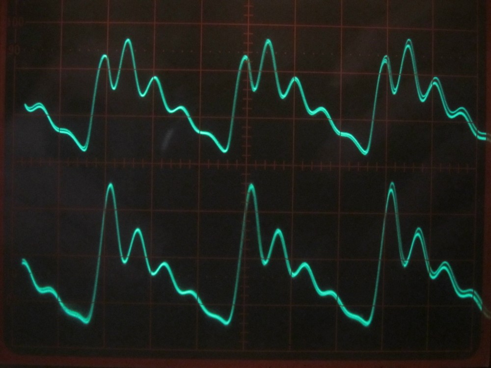

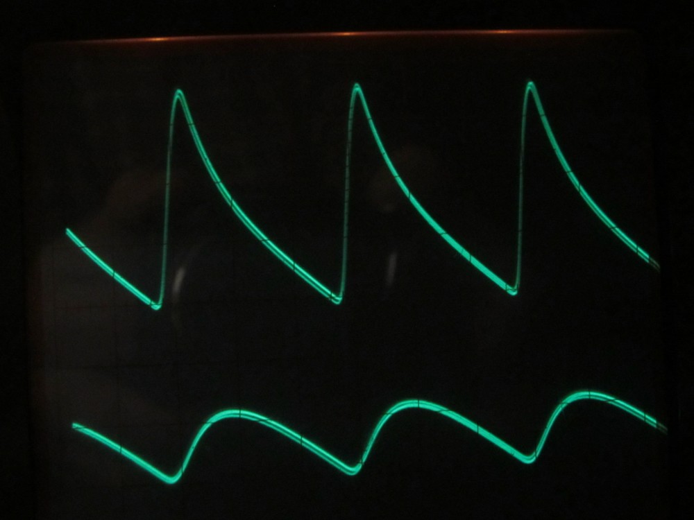

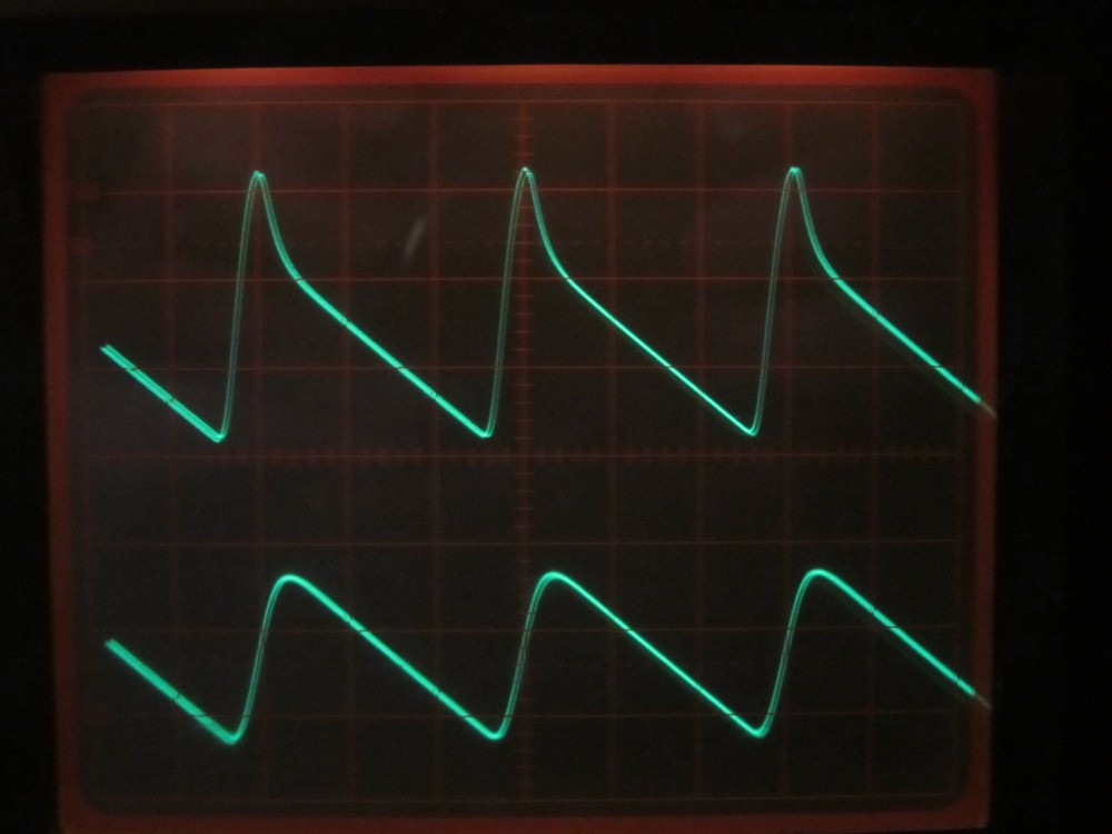

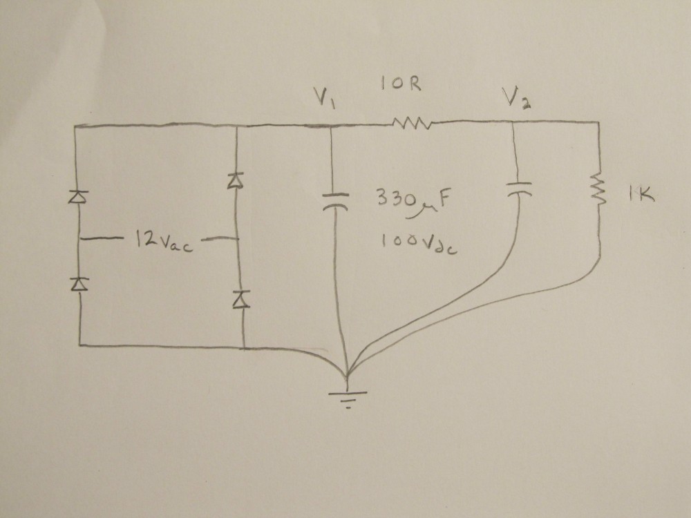

I'm looking at the issue of C R C vs C L C for a power supply for an F5,
so I performed a small low current test using the attached schematic.
Both electrolytics were the same value 330uF @ 100 Vdc.
With the scope set to 100mV / div. you can see the first cap takes the brunt of the ripple.
If I understand things correctly, the power dissipated inside the cap is caused by the ripple x ESR , which is going to create heat.
Then the 10R was replaced by 180uH and it appears to be an under dampened system.
Recall, in an ideal system Zeta = 1/sqrt(2) .
The 180uH inductor was an air core, so I doubt a few milliAmps of current would have put it into saturation.
So I added 3R3 in series with the 180 uH inductor to reduce the Q of the inductor and the C L C filter behaved nicely.
But who knows if its over damped now ?

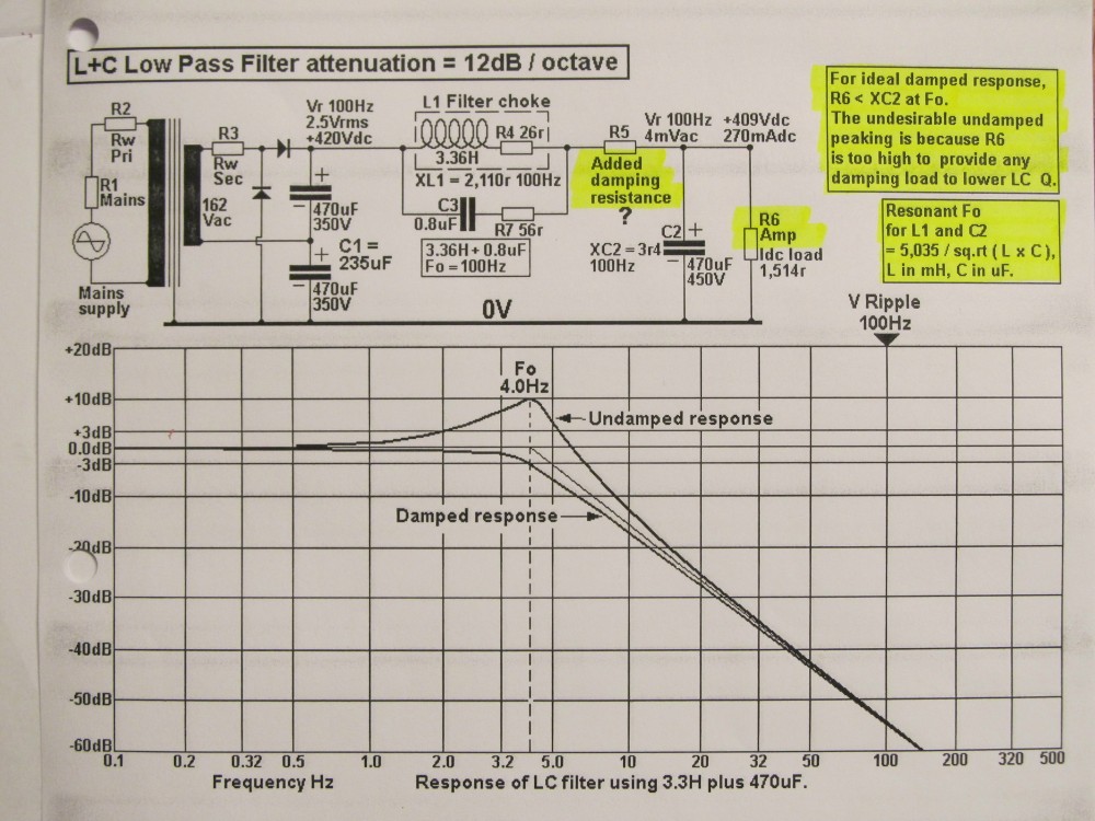

Actually, here is is a pretty good article concerning transfer functions and damping L C and C L C filters.
https://www.ti.com/lit/an/snva538/s...08690&ref_url=https%3A%2F%2Fwww.google.com%2F
So the question is if the Hammond 159 ZL inductor has a DCR = 0.044 Ohms,
how can I figure out if that is enough to correctly dampen the C L C ?

In a CLC power supply filter , I think the L needs to be dampened.
Certainly, it would be good to have a look at this in the frequency domain.
Page 8 of the ti application note says the dampening can be done by connecting an R + L in parallel across the L.
Fortunately, Ozorfis looked at this exact issue with a hammond 159ZL ( 2.5mH and r = 0R044 )
and recommended connecting a 0R2 20 watt resistor in series with this hammond choke.
