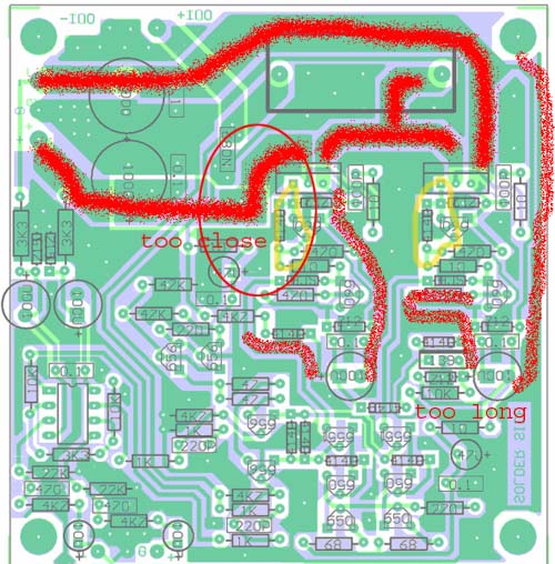

u can see my mark of ur pcb
it make the pwm work in a wrong way

Hi, Fumac,
I try to analyze your suggestion. The marking "too long" = tracks for
- making 12V for (-Vrail+12V)
- tracks from differential to mosfet drivers
- rail tracks from capacitor bank to mosfets
- output of mosfets to inductor
"too close"
- the distance between rail tracks to mosfet driver section
Is my interpretation right?
What is the meaning of yellow circle you draw?

the yellow circle is the g pin of fet, is Sensitive ,
too close to the Interference from the VDD and
the too long circle make ur Power of FET-driver is not very clean
this two reason make ur amp Self-shock in high power output
so the fet will burn

lumanauw,
make the mosfet driver/s CLOSER to the mosfet and make the GND planes much wider...
in short, make it more compact ;)
less stray radiation....

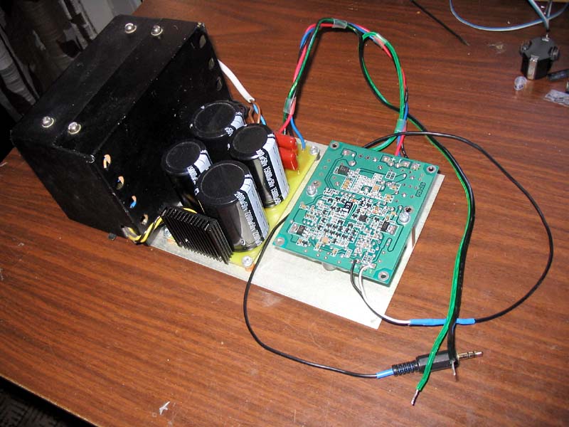

sample/see below... its one of my earlier diy ucd... just the mosfet drivers/mosfets/filters.....
if you could make it THAT close, its much better...
underside of the above circuit... :D its still solderable... :)
my current PCB for my diy ucd STILL uses those tightly spaced layout... :)
and the UCD with the modulator board attached...(diff input)... still no protection and op-amp buffer BUT working... :)
now aint that small with through holes? :D
