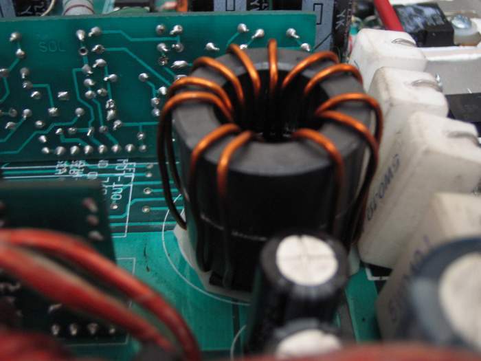

- toroidal core has less flux leakage than RM cores? (that can radiate)? If I see a toroidal core, I can see the wires, and when I see RM cores, I can see only small part of the wires (most of the wires are blocked by the ferrites). How come toroidal core has less flux radiation?
Thanks for the advice. There are some things that are not clear to me.
How to place toroidal in PCB? Like in this photograph, I call it horizontal (towards the surface). Or is it should be vertical (like IRaudAmp or Fumac's toroid)?(well, laying the core down on top of a ground plane is never wrong)
I think this is important, but I don't understand at what direction the flux is leaking. Do you have a simple drawing explaining the direction of flux leakage relative to RM core gap?If you go for a gapped RM-core (I use an RM-12 with 1.35mm center leg gap) you better make sure you keep the sensitive parts of your electronics perpendicular to the magnetic flux leakage since RM-cores radiate when gapped.
The pictures here -> http://gnuffel.googlepages.com/pictures depict my placement of the core/pcbs, the small vertical pcb carries the modulator while the large board only houses mosfets/drivers and protection.
I might be in over my head here, but I think that the wires on a toroid couple capacitively to the resistive core, and cause a current to circulate inside the core, thus radiating both perpendicular from the toroidal plane AND tangentially from the leakage field caused by the leagage inductance from the windings, thus radiating in all directions. Placing the toroid as you showed over a ground plane will help reduce the field at least in one direction.
A RM-core should radiate less than a toroid, but when you add a gap, the magnetic field is no longer confined to the core material as you use air to strore magnetic energy, and as magnetic flux lines repell each other, you have leakage from the magnetic flux in the center leg gap. This poses no problem as long as you know how to deal with this.
