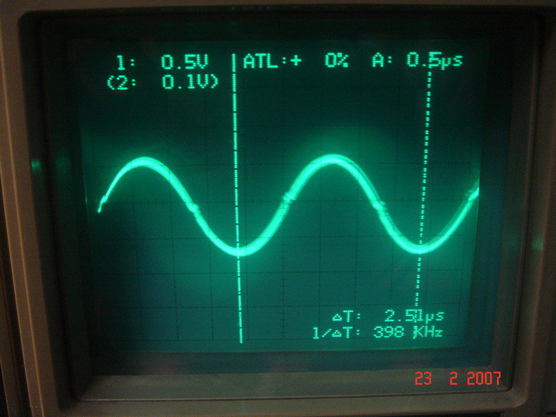

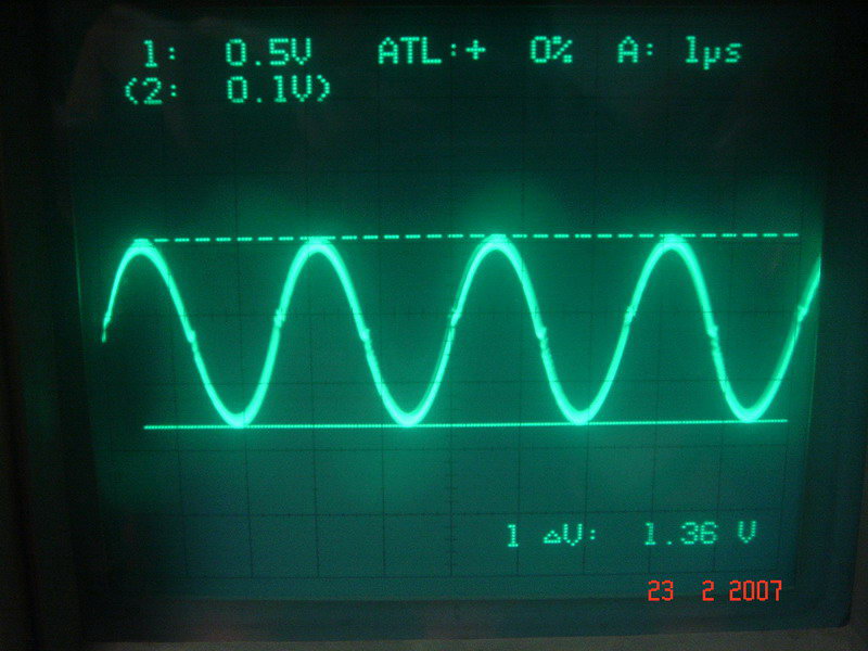

Why is that my UCD clone has a "bird" hidden inside a cct, making intermittent chirping sound? It's annoying, I wanted clean reproduction without any bird sound within the music.
Is there anything wrong with these traces?
Residual at idle 1V36 (p-p).
Why is the residual has 2 blips on left and right of sinusoidal?
Where the chirping sound comes from? I couldn't see anything in the scope.

I would say that you have a combination of high peak currents and poor layout. The blips after the filter come from EMI going through the output filter, the overshoot of your square wave comes from poor layout of the inner current loop of the switchers => inductance.
You can lessen the effects of this by switching softer resulting in lesser current peaks drawn through the FETs, but to what extent depends on your design and layout altogether.
You say your waveforms are fuzzy is this with no signal driving the UcD? The UcD will shift frequency when driven, so you can only observe the cleanness of a signal with no input drive.

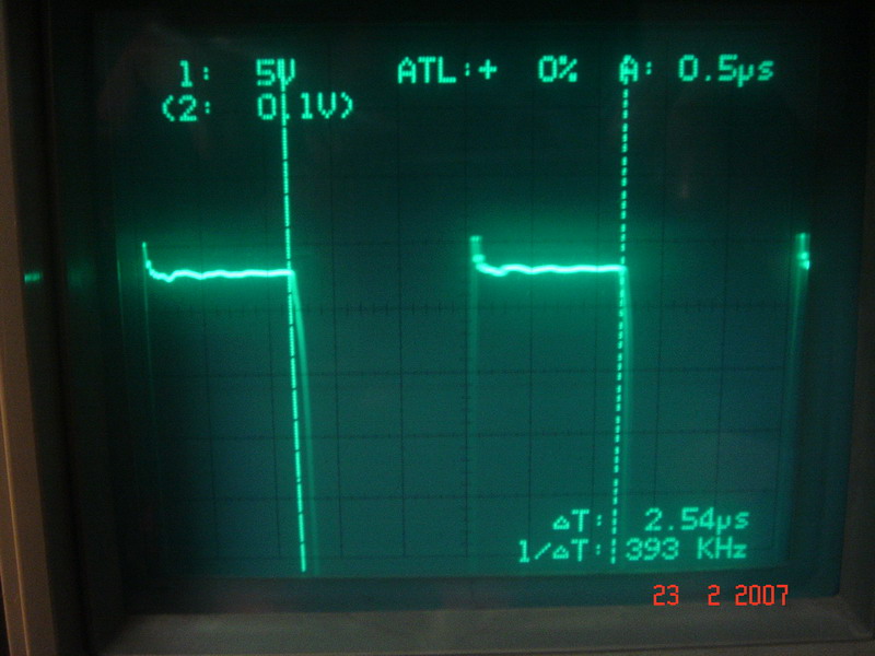

Hi, Zilog,
All the pictures I attached is condition with no load. I guess this can conclude to 1 thing, if we want to make UCD, SMT component is a must, where we can have short tracks everywhere. Using ordinary components will lead to long tracks everywhere.

Ther could be many things wrong to make the mosfets burn.
SMD will for sure be the better choise, but I don't think this is what's wrong.
The ringing on the mosfets (what you call blips*) can be dampned with snbbers. Try 10 ohm in series with 1 nF over each mosfet, and see on the scope whether this helps.
The bluring on the scope can as Ziglo says be variations in the switching freq, or just som higher harmonics of the the carrier freq. Remember that the residual is not a single sinus but a series of sinus tones making up the square wave.
The bird sond could be some parts of the circuit (think output stage/filter) emmiting EMI that couples into the amp again.
Try to post schematics, the layout and some pictures of the amp .... otherwise it will be dificult to help you further
