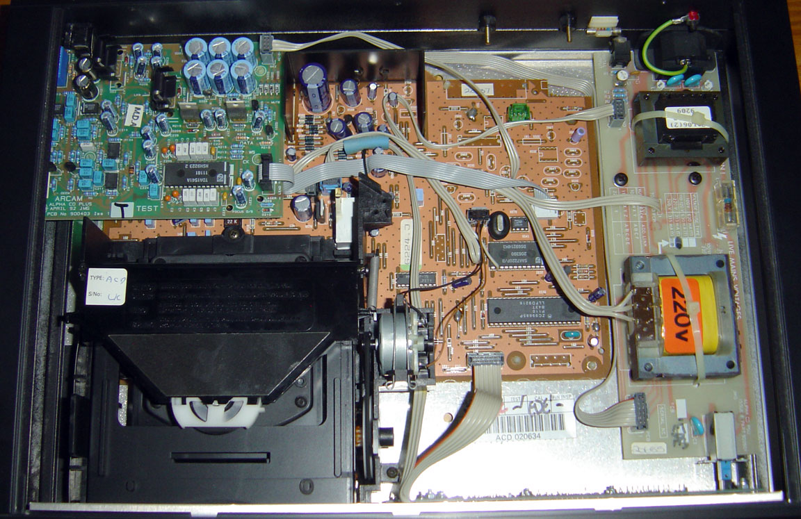

Funny Philips base with good case and sexy DAC, strange choice of caps around the TDA1541A: 220nF film and tants!
Sadly the CDM4 is skipping like crazy...
220nf are faily common in good gear (Meridian use them for the same job) Tants i've not seen or used but have considered! I'm guessing they are also 220nF and on the MSB 2nd MSB?
