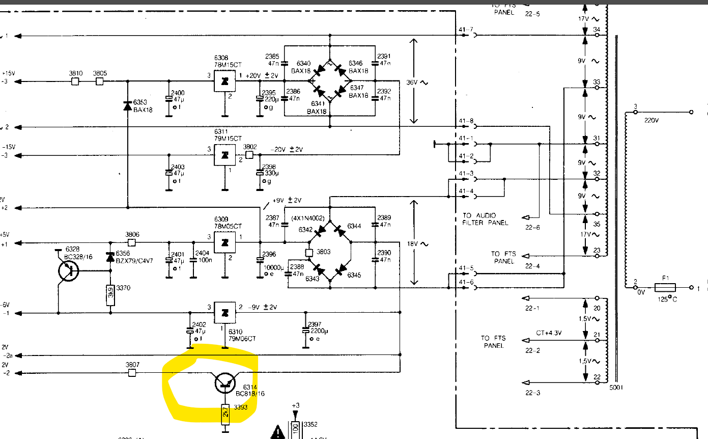

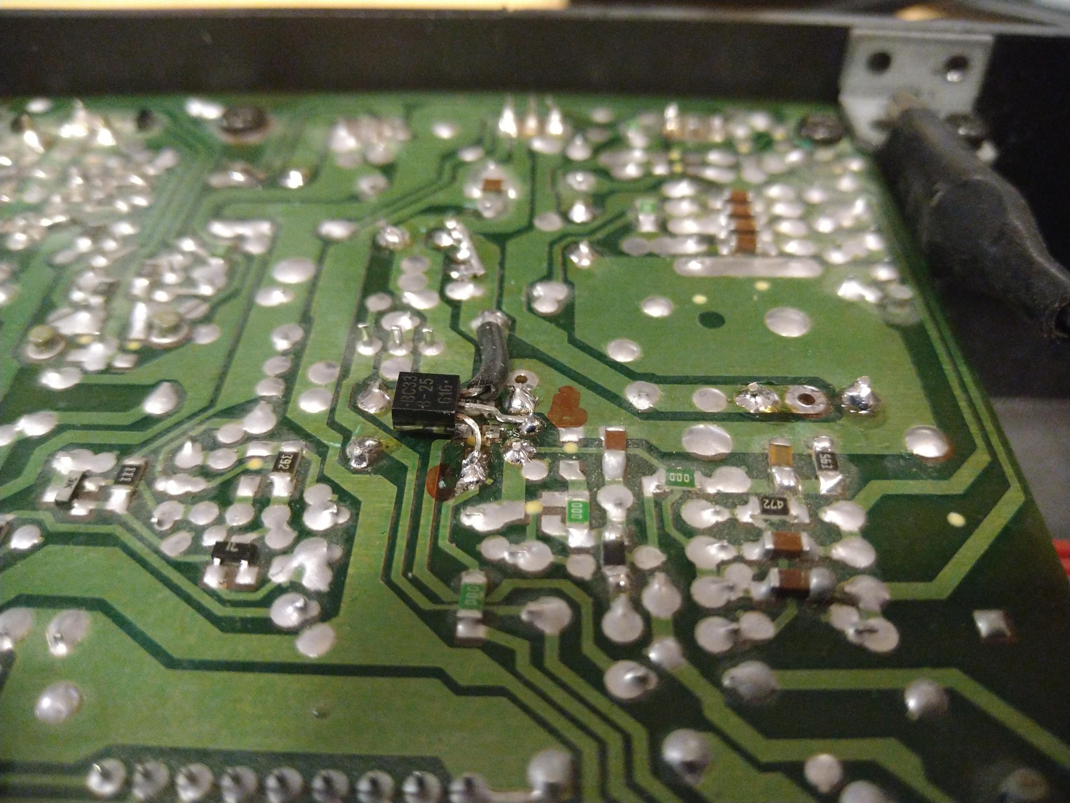

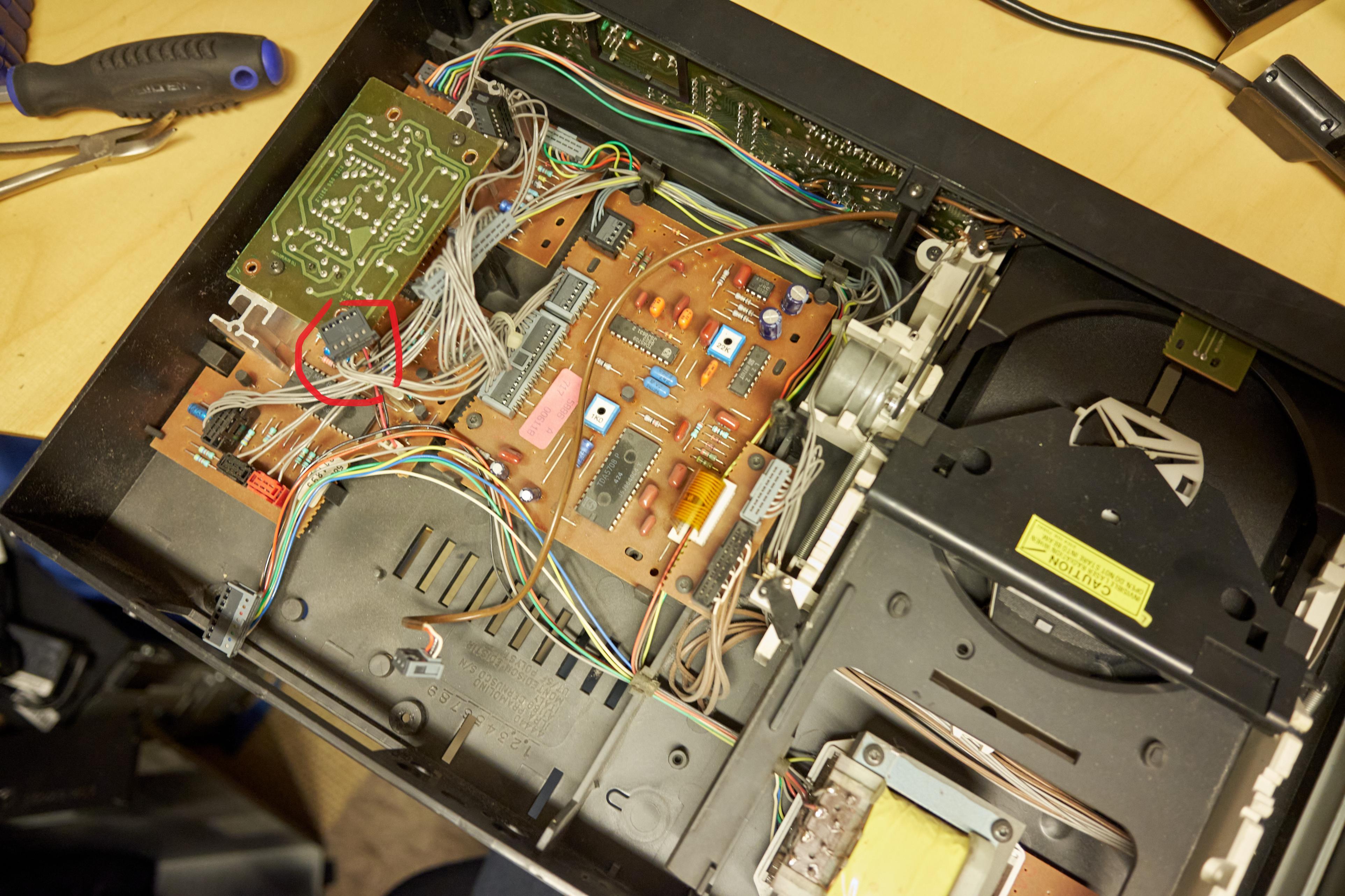

After finishing recapping my CD670, it worked fine for a while, then blew the fuse and the transistor in the negative supply to the motor.
I was puzzled, but it turned out one of the wires in the power supply connector between the audio/PSU and the CDM2 board had broken off and was shortcircuiting something. I failed to take a picture of the broken wire, but I've added a picture with the connector marked. These connectors and wires are very fragile since the wiring is stiff.
After opening the connector block, reinserting the broken off wire, and replacing the SMD BC818 transistor with a BC338, she's alive again: Flickr
