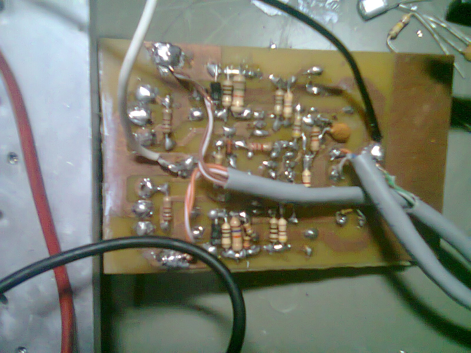

Hi naf,
Your peeceebee 2sa/2sc version based on shaan almost 8 hours now and still singing Thank you naf for sharing peeceebee layout.
Boyet
Yeah nice to hear and you liked it...
Yes and i liked it. I used 2sa1381/2sc3503 for driver and 1k for bias. Its good to my taste.
naf i have pm to you.
Boyet
Hi naf,
Boyet

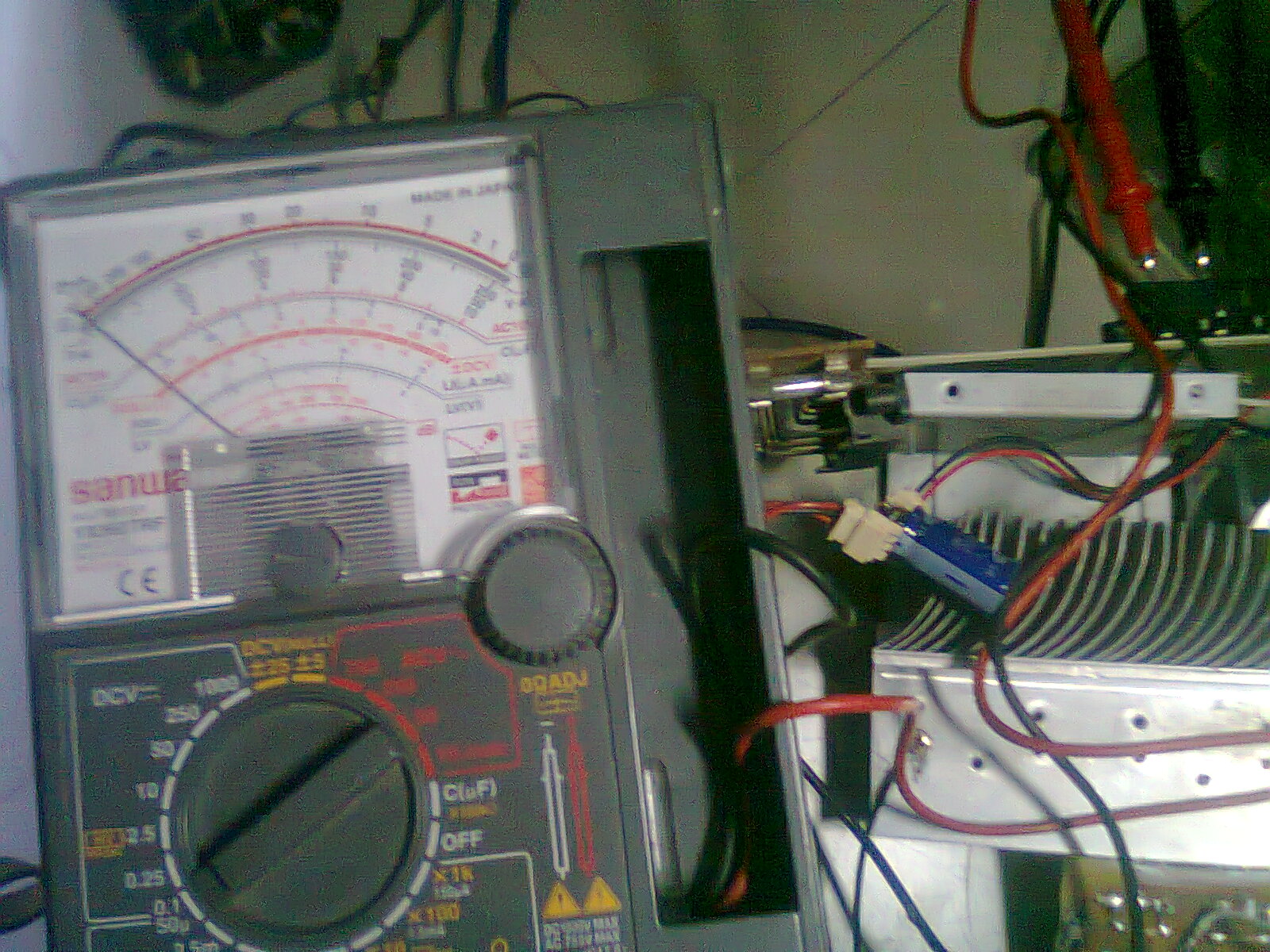

Hi Boyet!
Just for reference...
Could you post some measurements of your build?
DC offset
AC offset
PSU you are using
Are VAS transistors warming up?

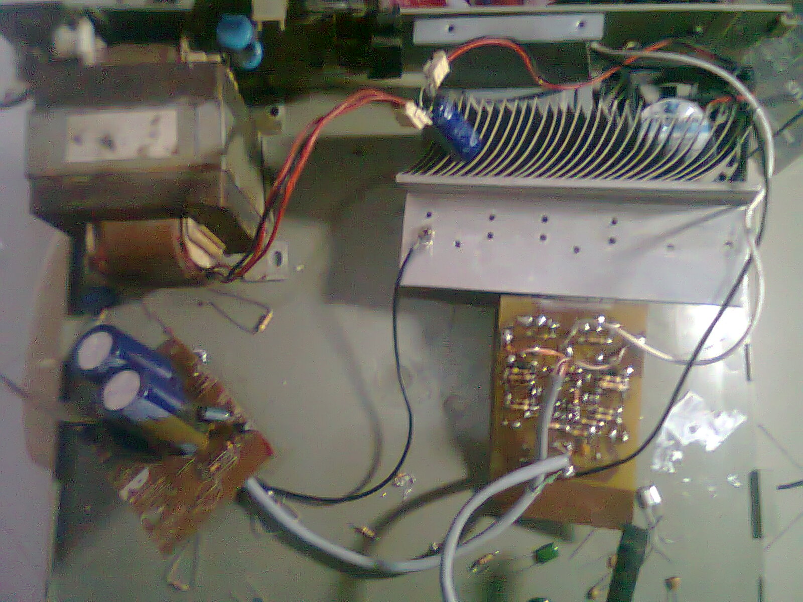

Hi Abiter,
DC offset - I got 0.0mV after 2 minutes warm up. I set 0.1DCV on the tester. see the tester in the picture.
Calibration - On the 15K Of negative side -V I parallel 78k. Or you can Use 100k trimmer for calibration of dc offset.
and also I parallel 15K in 1000uf. You can do it different value until you can achieve 0.0mV
AC offset - I dont know.
PSU you are using - +-35Vdc 4A. 2pcs. 4700uf/50v only for testing. never tried higher uf I dont have.
Are VAS transistors warming up? - Yes. I Put heatsink to driver.
Do you tried BC550C/560C for the input? Where did you buy?
Thanks,
Boyet

Hi Boyet!,
0.0mv wow! that is perfect to the ideal dc offset of an amp.
Measuring AC-offset is the same procedure as dc-offset only that your meter is set to ac. Ideally should also be 0mv when no signal applied. Occurence of high AC-offset could mean oscillation problems (self-generated noise).
I was using the higher voltage BC556B/546B at the input differential. BC550C is available in Raon but the complementary pair BC560C is nowhere to find...
One of these days I will also try Nafs variant as I still have 2SC2240/SA970 in my stock.
Regards!
AC on the output when the input is shorted is noise.
It can be hum and/or white noise.
Try loading the input with different resistors. I keep dummy load RCA's for just this testing: 0r0, 100r, 1k, 10k, 100k in pairs. Use cheap plastic RCA plugs.

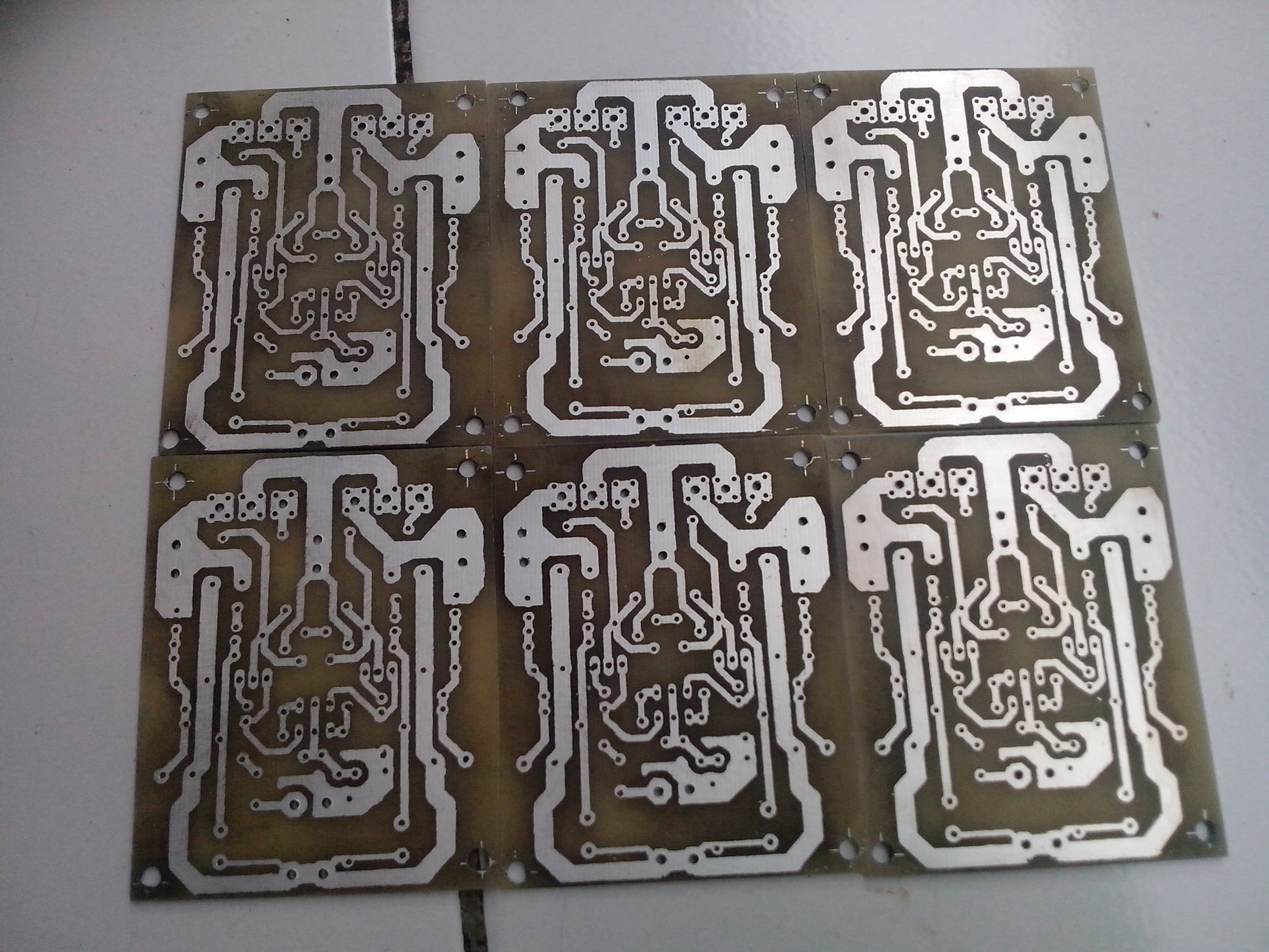

Finishing 3 pairs peeceebe of bc550/560 version
1 pairs for me, 2 pairs going to my friend.
Hi Naf, nice.. very neat your pcb
I bought parts for 2 channel of peeceebee except bc550/bc560 because no available. I have ordered bc's..2sa/2sc still singing naf may I request also the bc550/560 peeceebee version? Thank you.

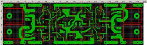

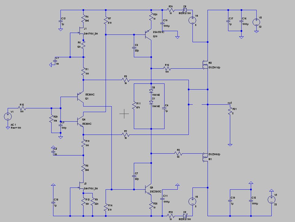

my project of VSSA
... with FET curant sources: better stability vs supply voltage, R4 and R5 to limit voltage (and heat) across fets, R9 to fine tune V offset (I will first put a variable resistor then replace with a fixed one)
different supply voltage for input and VAS (use of SMPS 800RE)
10x gain (I bought udj6 6 ways soundcard with 3 volts peak).
and since my project is active speakers the corresponding PCB for two channels on one board, common VAS supply, common VAS ground, separate ouput grounds.
PCB size 60mmx200mm
I'll be ordering PCB quite soon, GB possible ....
any comments?
cheers
Paul

I have one pair each of Exicon ECX08N16-Z/ECX08P16-Z and like your version of VSSA, especially practicality since both channels are on one pcb. Could you provide one pcb for me? I shall contact you with PM for payment.
