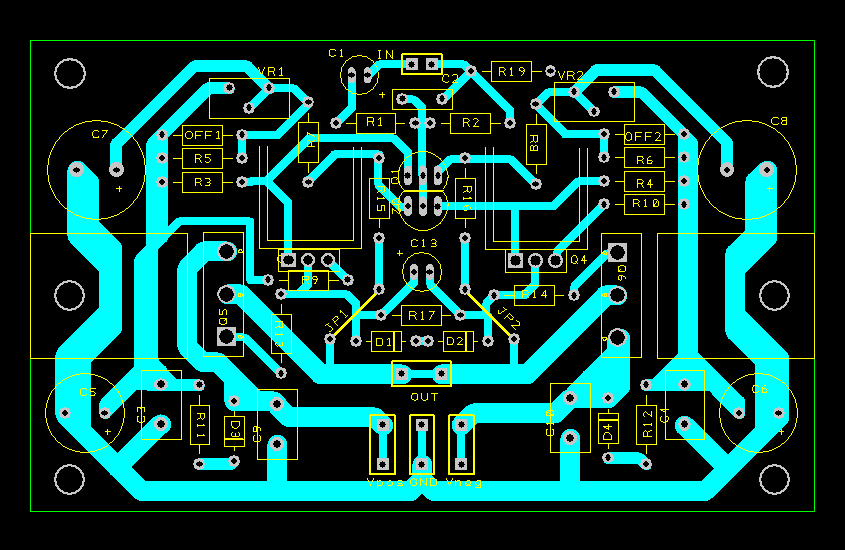

Looking good!
Some non-critical, non-expert suggestions:
1) Could the two 1uF caps on each side be aligned to be parallel? (i.e. rotate the one sitting 'east-west' so they both sit 'north-south')
2) Could the trace from the 2000 uF cap up to the 1000 uF cap be thinner?
3) Is there enough room between the edge of the TO3 heatsink and the v+, V- and speaker out connectors?
Steve.
I'm no expert either, but here goes:
1) The orientation of those was a vestige from an earlier iteration and could likely be placed in parallel, if only for aesthetic reasons.
2) Why would you want any ground trace to be thinner?
3) I think so, there's .200" or 5mm clearance plus the connectors should be insulated anyway.
Thanks for the feedback.

There's just a little cosmetic clean up to do but I think the last iteration posted will be very close to the final layout. I'll post the final version as soon as it is ready for peer review. If there's no errors I'm going to get a film made and etch up a pair.
Thanks for all the feedback, I think the comments I've received have definitely improved the layout.

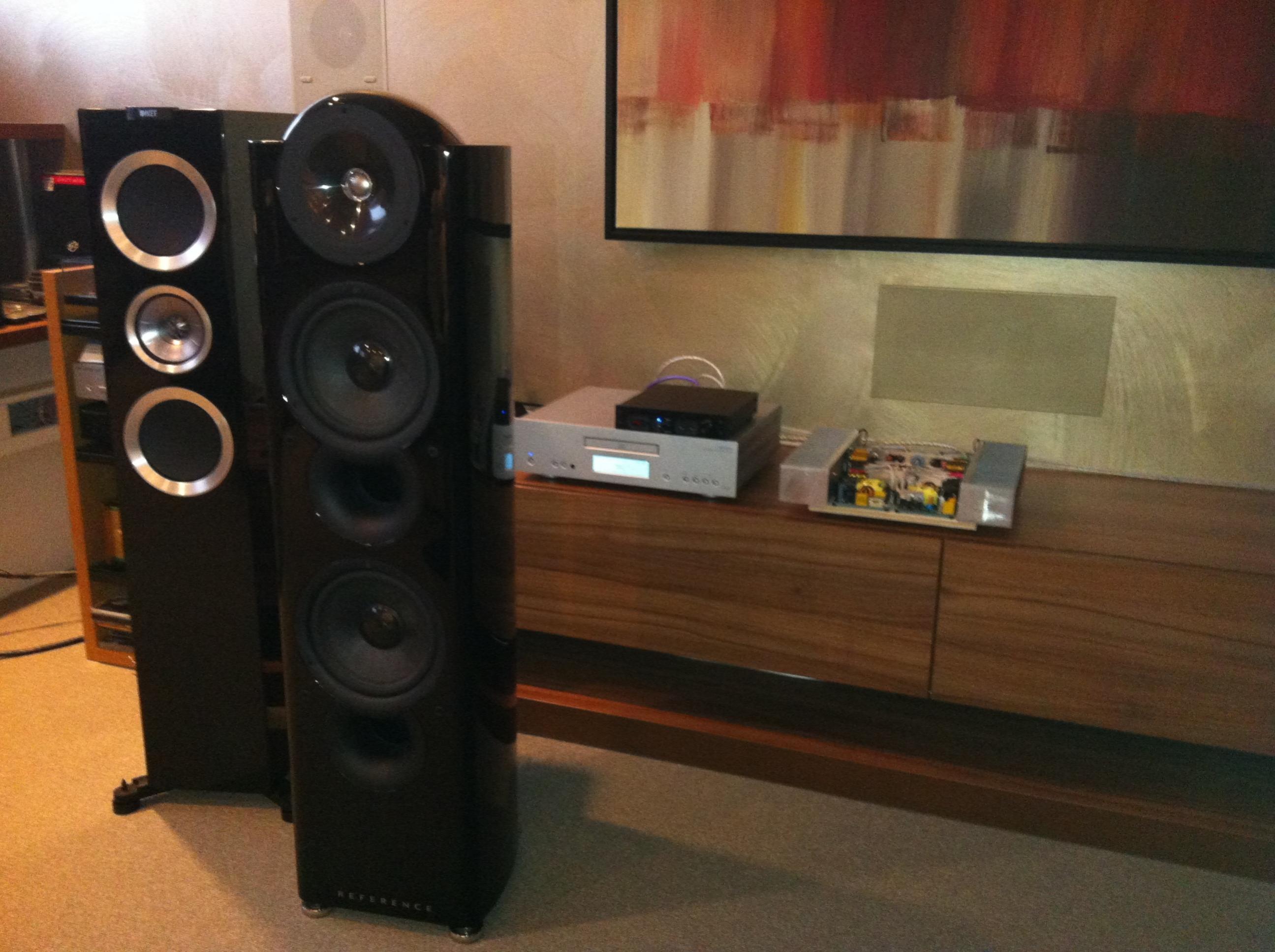

And the difference with or without CCS-s is night and day?
Yes, on a speakers like this it is obvious like day and night. :yes:
(VSSA test on KEF R700 and 205/2) ;)

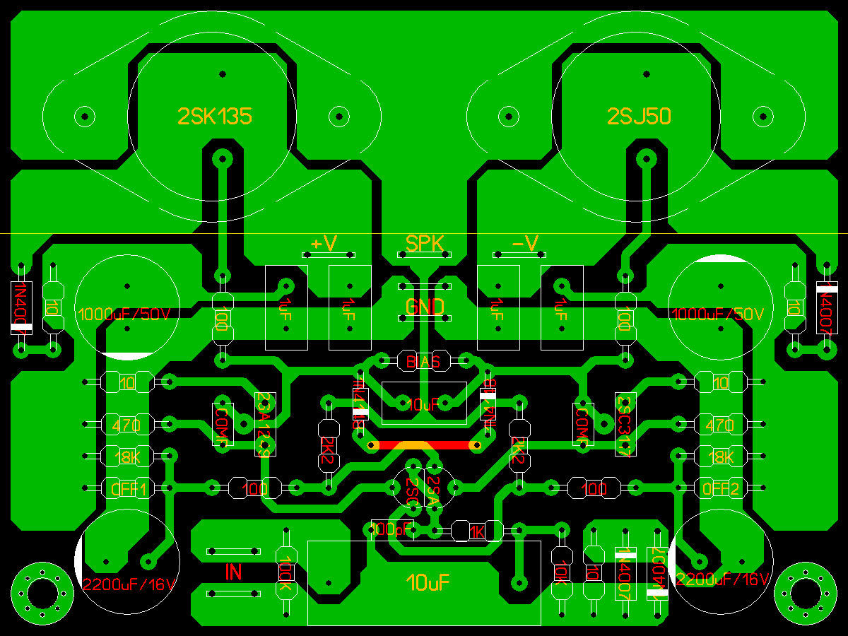

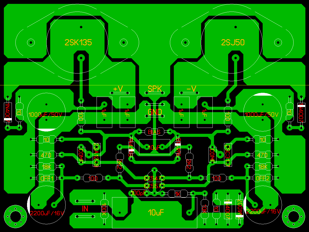

My final versions
Fixed a critical error on the last layout presented, I had the input pair emitter connections swapped. I'm a little embarrassed that happened and somewhat surprised no one noticed. Also included a layout for the BC type input transistors. The pin-out of the BC's make a layout which is more straight forward. Since the BC547C/BC557C are higher gain than my 2SA/2SC that will likely end up the preferred layout, but I'm still going to give it a try with the Japanese transistors since I have them on hand. Sent out the image for a film to be made, so I'm hoping to be etching my boards this weekend.
Jason.. luckily you have found the emitor error on sc/sa before etching... I found error when all part have been soldered and it took me 1 day to found it. when debugging I blew 2 pair vas and all 10ohm resistor :( . But the price is paid off it sing beautifully finally.
