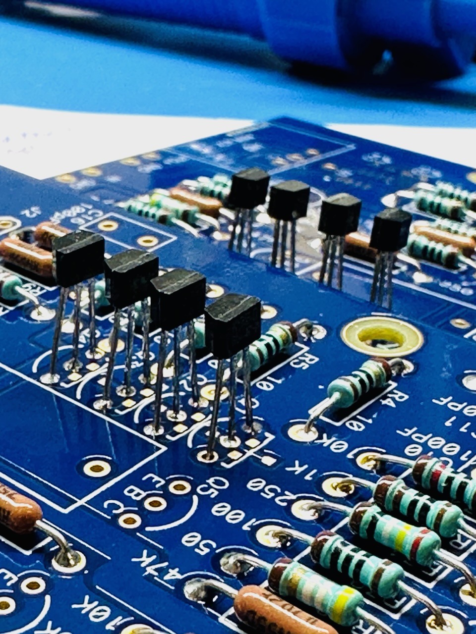

6L6: Got the kit yesterday and thanks for your excellent packaging -- very professional. Would like to get the 2SK370 through-hole Jfet substitutes and cannot find them on Mouser or DigiKey. Where are they available? Will the Jfets available on DIY work as well? If so, which ones? Am most interested in avoiding the SMD soldering -- having struggled through them on 4 of Wayne's fine preamp pcbs (and thanks, Wayne!). Apreciate your response.

2SK370 have been out of production for well more than a decade. I’m not sure what you ordered, if it was the 2SK3700(f) …
https://www.digikey.com/en/products/detail/toshiba-semiconductor-and-storage/2SK3700-F/2062697
…that’s about as wrong a N channel mosfet as you could possible use in that position.
If you absolutley have to have through-hole devices, order an octet of 2SK170 from punkydawgs on ebay with as low an Idss as he has, or perhaps just consider using the 2SK209 that are included in the kit, because they work perfectly, as the circuit was designed around them.

6L6: Suspected this was the issue with the original 2SK370 series and have cancelled the DigiKey items. Because of a large number of EBay problems, no longer order parts from this source. Will consider DT's suggested items when they arrive. SMDs cause me great problems in assembly and would spend a significant amount on through-hole substitutes -- as long as they do not degrade performance and come from a reputable company.

These are genuine NOS Toshiba´s. Seems the store only carries the Linear Syatem ones.
GR´s IDSS range is from 2-6mA, BL´s are 6-12mA..
Don´t know about your last Q, but ordering from the US will probably save you some customs hazzle.

Hello All,
In my measurements I found that installed in the P3 2sk170 fets run at very near 40% of IDSS.
So for 8 each matched at 7ma IDSS 2SK170's they will run at 2.8 ma each in the P3 PCB.
I ended up using the 2SK209 soldered on the tiny PCB's then soldered in the through hole locations on the P3 PCB's

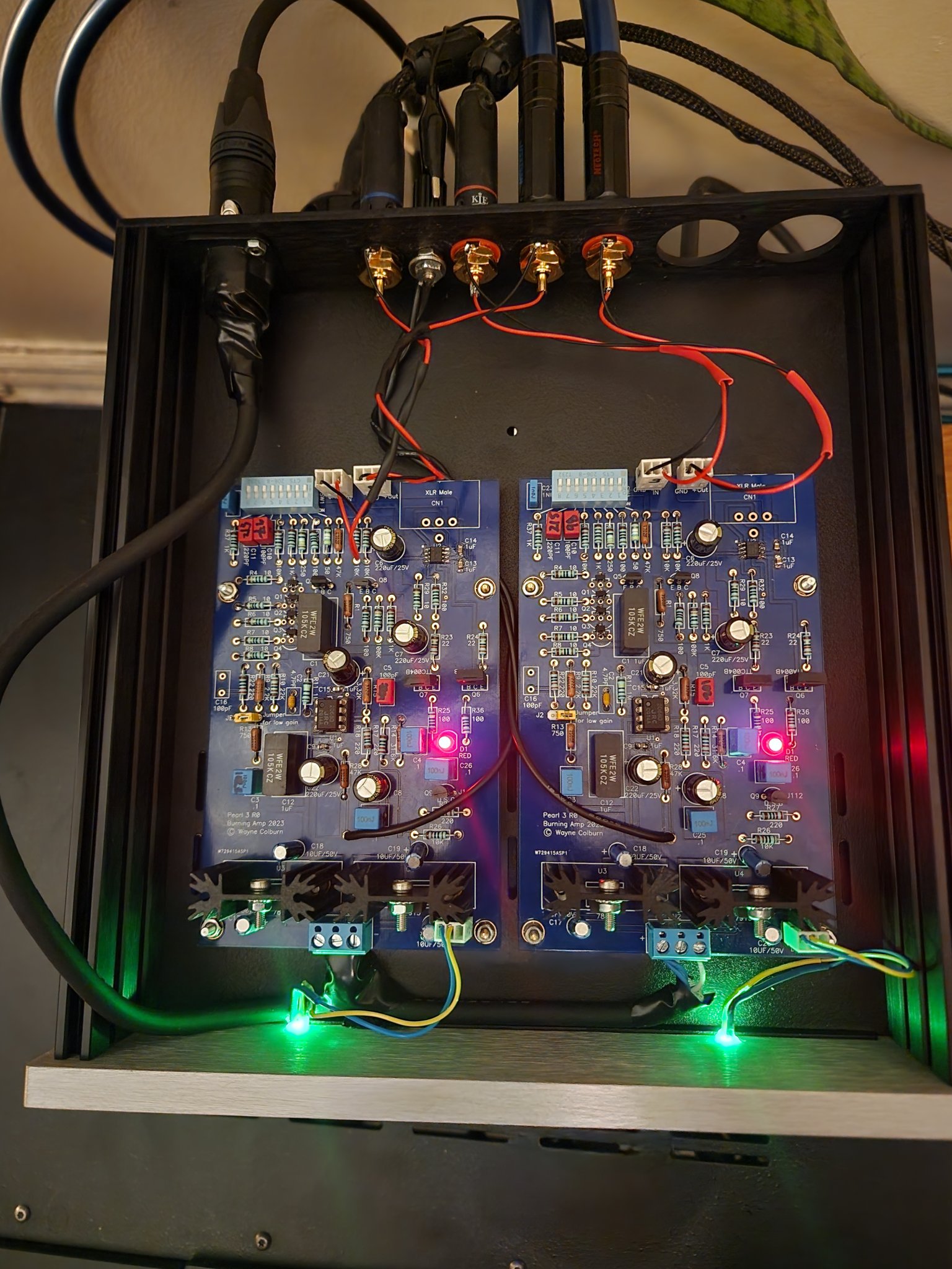

Another Pearl III is up and running - First Test run - all stock.
Worked pretty much without issues, apart from some reversed LEDs.
Mistook the "+" for C20 to be for D3, but it worked once that was fixed.
Now starts the opamp rolling. Looking to try the New Burson V7s. Would love some free samples.
Need to get the XLR outlets in.
