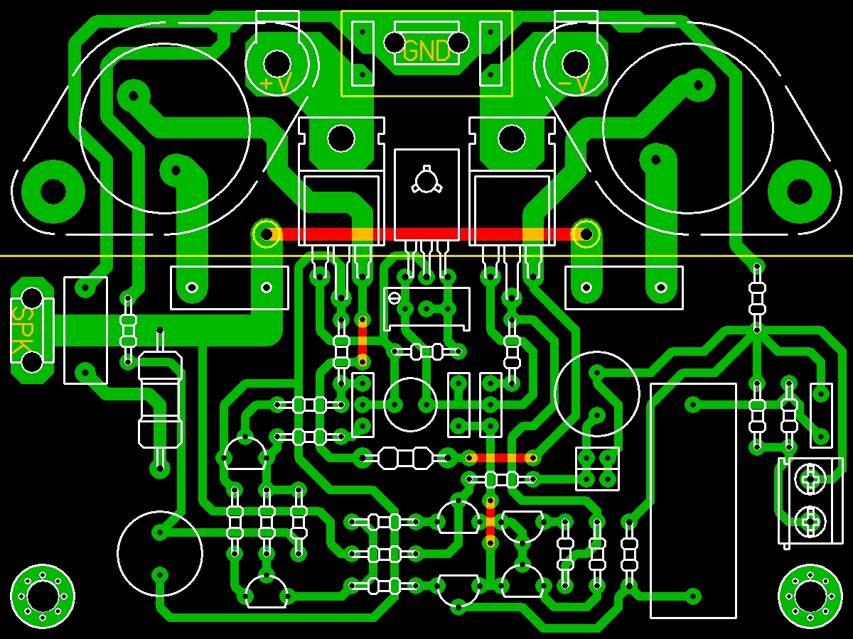

So, here's another iteration.
Does this represent progress? I think it does, though any layout is a compromise. Rail fusing will be on the PSU board and remainder of the output network on a remote board at the speaker output terminals. The speaker ground will be returned directly to the PSU. Any constructive comments welcome with respect to layout.

Hi Jason ,
Layout based on your PCB , sorry if I'm not welcome in your thread. 🙂
Regards Alex.

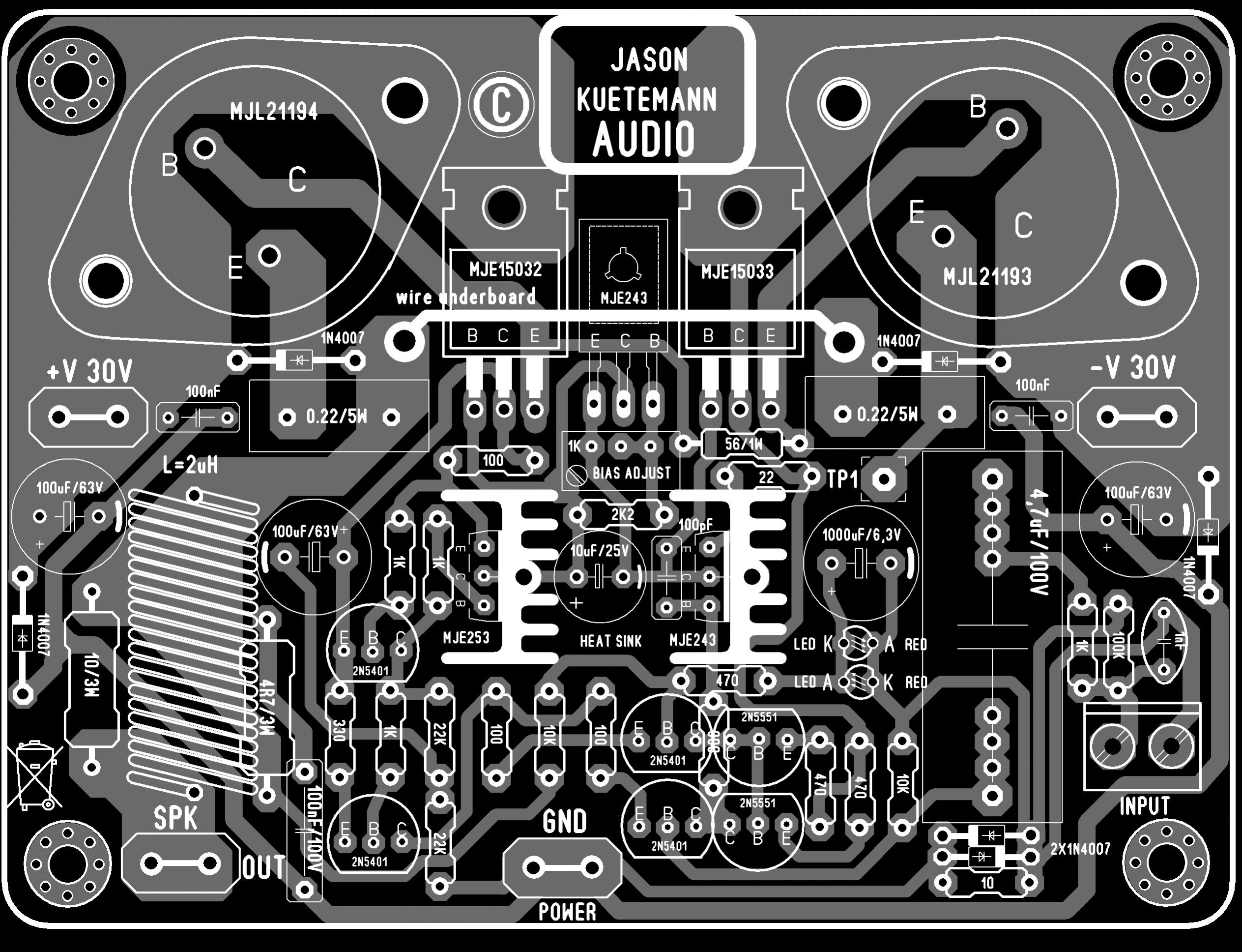

Alex,
A couple observations regarding your layout, perhaps you could provide some feedback.
You provided two spades for ground connections, but they are physically connected via traces. What's the reason or rationale?
The outputs, drivers and VBE multiplier are intended to be attached to an L-bracket, the mounting holes in the upper corners probably don't need to be there, unless it is recommended to physically bolt the bracket to the PCB with dedicated hardware. Should there be dedicated fixing points or can the mounting screws for the devices be used exclusively?
Some of my earlier iterations included the output inductor since the space seemed to be available for it. Community feedback suggested it is best located at the output terminals so I moved mine off-board. Many of your layouts include the inductor in the PCB. Any specific thoughts on wether it should be on / off and why? I like the 'all-in-one' idea personally, but others seem to prefer a more modular approach with physical separation of certain blocks.
Thanks for providing some food for thought and an example from a more experienced perspective.
Perfect, just where it should be.
I love your local HF decoupling !
Any room to fit in some MF decoupling? Try 100uF on each rail somewhere.
Add a pair of inverse parallel diodes across R3.

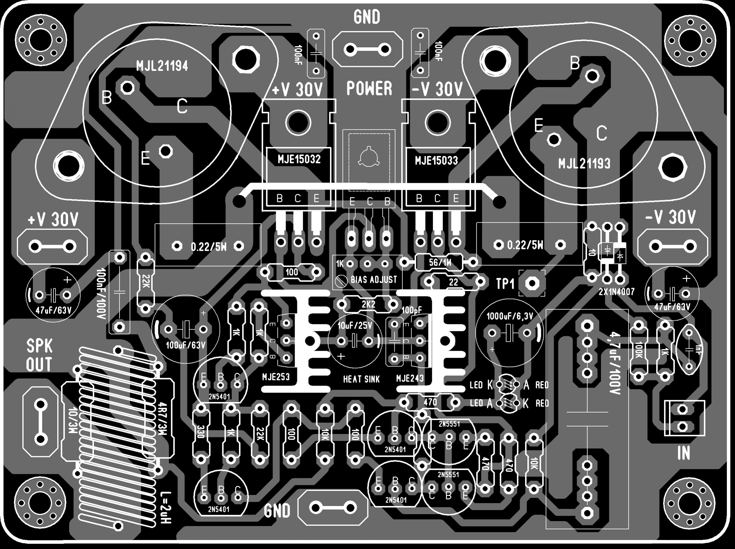

Thanks Andrew. After seeing Alex's example I have a few ideas to incorporate into the next iteration.
Any thoughts on 'rail catching' diodes, reverse biased from output rail to power rails? Came to mind when you mentioned putting diodes across the 10 ohm ground isolation resistor for the audio grounds.
jkuetemann ,
What can I say , your board it's fine , I have learned a lot, myself from this thread . The skill comme by every layout , so we can practice all time we have , dedicated to prepare PCB's. I like PCB's compact , all in one ,so my PCB look like this attached below.
Regards Alex.

split power attachments as on Alex' is not the way to layout.
You disagree with power being delivered via the other side of the TO-3 flange? I wouldn't have thought it to have made much difference and eases the placement of MF decoupling, rail catching diodes and facilitates board testing prior to fitting the output transistors. I rather liked the approach. What is the issue? There are no long traces involved and essentially the power is still being delivered directly to the outputs.
Or did I miss something else in Alex's layout? It is fundamentally very similar to mine, but with his own signature flair.
I understand what you are suggesting now, not so much an issue on the PCB but rather the power delivery to the PCB. Fair enough. Like I said before this is an exercise in skill development.

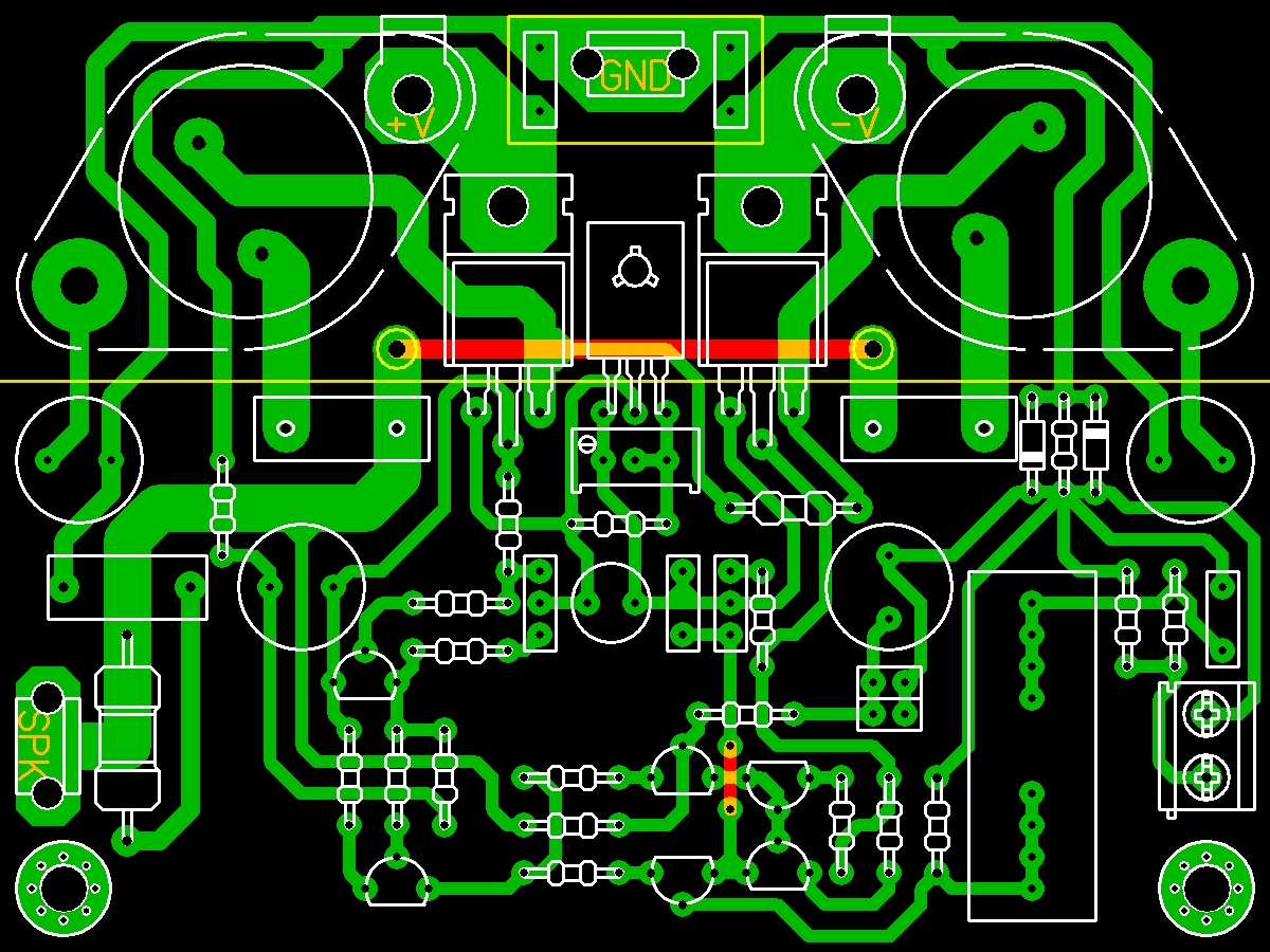

So, here's a few changes. MF rail decoupling, diodes across the audio ground isolation resistor, some rerouting of traces and a few components moved. Still haven't decided where the place catching diodes just yet.
Thanks for the active discussion so far folks, it might not be pretty but I think I'm beginning to see the light.

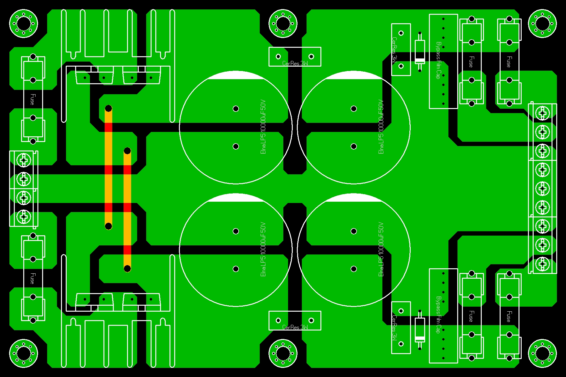

Hi Jason,
I am basically doing a similar task as you are. I have designed a power amp using the LME49830 + LatFet, similar as was done by OPC (Owen). I managed to get a used transformer from a scraped Pioneer SX-1250 via eBay. I am merging two designs, the power supply section of the SX-1250 & the National Audio Power Amp Power Supply application note. I have done the Power Amp Recifier assembly & the PowerAmp assembly, so far and working on the attached PCB/schematic of the AC input assy. Still need to figure out the regulator for the LME49830, probably will just use a simple LM317/337, for that. Disregard the thin traces, as I just did a quick route last night, they will be beefed up with thick traces & copper pours. This gives me a chance to have people review what I am doing and get feedback as well. Hope that this is of some help to you. If you have any question, please ask.
Regards
Rick

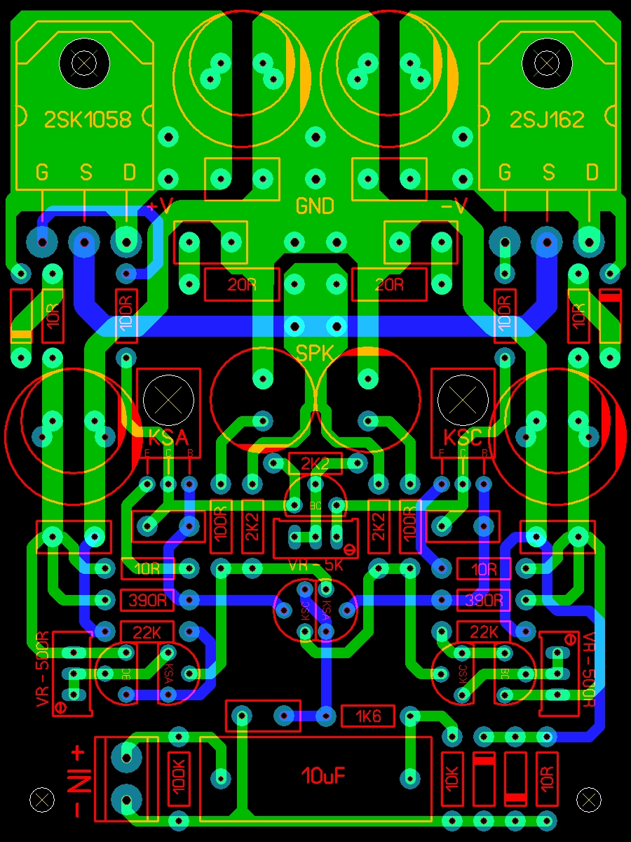

I know this thread has been left for some time, but I have been continuing to evolve and want to put a PCB layout up for comment. This is a VSSA variant and in no way related to prior examples I have posted on this thread before.
I have tried to keep loops tight and local. Since my current plan is to have a board house produce the board I have elected to make use of both sides of the board. This allows for the use of PTH and more convenient routing. Where a change of layer was desired I used a component lead location for the purpose. I have tried to allow for generous clearances and keep silkscreen neat and off the pads.
Any constructive comments welcome, tell me what you do or do not like about it and why. Thanks.
