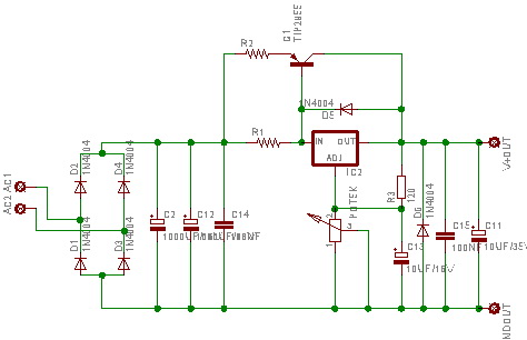

Ask to calculate R to share CUrrent
Hallo anyone,
i'm want to ask how to calculate R1 and R2 to share Current.
i attackment the schematic
in this schematioc i want to increase current LM317 by using
TIP2955.
i want to increase current load about 2/3 ampere.
by share current in:
LM317 about 0.5 Ampere
and TIP2955 about 1.5 to 2.5Ampere. so the current handle by 2955
i watch many schematic but i still dont undrestand about calculate R1 and R2 to share current.
please help anyone becasuse i'm nebies and try to practice electronic.
please give me advise and reference to learn.
and i want to ask to.
D1 to D4 i change By IN5004
d5 and d6 should change to IN5004 to?
please help anyone.
sorry about my english.
