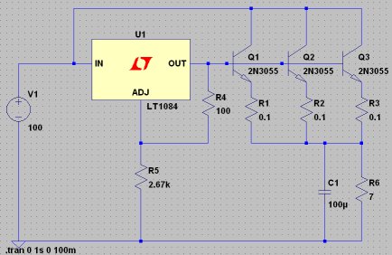

jackinnj said:
Consider the LM317 as a "error amplifier with reference" -- this is what BWRX is suggesting in essence.

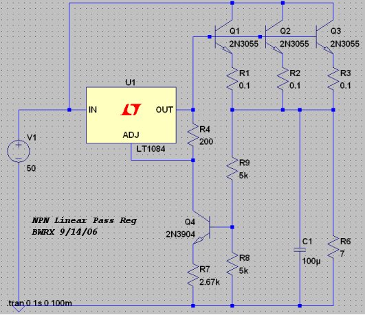

That's what I meant to suggest, but the way I described it in my last post will not work. I keep forgetting that these regulators mainting a constant voltage between the output and adj pins which causes a current to flow through the upper resistor and also the lower resistor which sets the reference voltage.
Attached is the basic version of what you want to construct, Mr. Anonymous1 :)
The 100V was arbitrarily chosen. Obviously do not use an input voltage that high or parts will fry.

This variant I just came up with simulates better (steady state or constant loading) in terms of line and load regulation.
The values in the schematic should give you about 35 volts output with a lot of current capability.
Ex-Moderator
Joined 2005
That resistor is just to get the desired 5A load at 35V. It's only for simulation purposes. It would need to have a rating of at least 175W if you were to actually test the regulator with it is as a load for an extended period of time.
Those 0.1ohm resistors will also dissipate right around 0.25W if the load does draw close to 5A. They should really be at least 0.5W. You could use lower values too.
To vary the output voltage you need to adjust R7. You can make R7 a little higher than what I have in the schematic (say 3k), put a larger value pot in parallel with it (about 100k for an R7 of 3k), and tweak the pot until you get the desired output voltage.
This scheme works because the 200 ohm resistor between the LT1084s output and adjust pin ensure that a constant current flows through the transitor and R7. That constant current sets a voltage across R7, which in turn sets the voltage between R8 and R9. That voltage causes a constant current to flow through R8 and thus R9 as well. That current sets the voltage across R8 and R9 which is the output voltage. The regulator is floating, in a sense, because the output voltage is set and Q4's collector soaks up the voltage variation from the varing current going through the bjt's and emitter resistors.
Now that I think about it, be carefult with the value I have the schematic because you're using an LM337 which has a different output-adjust pin voltage (the LT1084 has 1.25V). That will cause a different amount of current to flow which will change the output voltage. I think the LM337 has a 1.5V differential which means more current will flow and the output voltage will be higher, so you could use a higher value resistor between the output and adjust pins to lower that current back to around 6ma.

Attached is the LT spice file if anyone is interesting in simulating. I like this circuit because it's not something I've seen before and it appears to work well (aka simulates well) and has high output current capability. I haven't done an FFT of the output voltage or tried to simulate a pulsed current load yet, but I'll have time tonight and tomorrow to check it out. Also the effect of input ripple.
I bet bypassing the adjust pin with a cap will improve noise a bit just like it does for a normal 3 pin regulator configuration.
Edit: Bypassing the adjust pin to ground does help the noise and squelches an oscillation that occured with lighter loads.

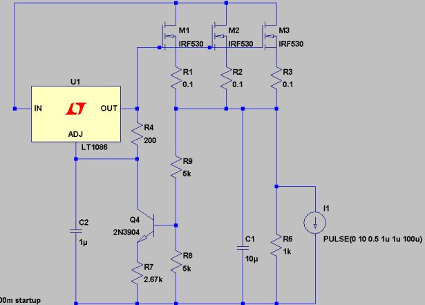

Ex-Moderator
Joined 2005
AndrewT said:
Hi Bwrx,
you have simulated using a very slow device.
Do you have time to simulate using a power FET pass device?
I have lots of irf540.
LT spice has an IRF530, and it simulates quite nicely with those in place of the BJTs. The great thing about the latest circuit is that the voltage at the output of the 3 terminal regulator will adjust to whatever it needs to be so that the output voltage is what it is set to be.
With FETs you need to make sure you have a hih enough input voltage so the regulator has an adequate voltage to drive the gate of the FETs. Some power FETs require a Vgs up to 10V for them to fully be on. BJTs don't have such a requirement, they just need adequate base current drive.
For FETs it may be better to have a small resistor in series with each gate, and the source resistors may not be necessary. I just simply swapped FETs for BJTs from the previous circuit.
